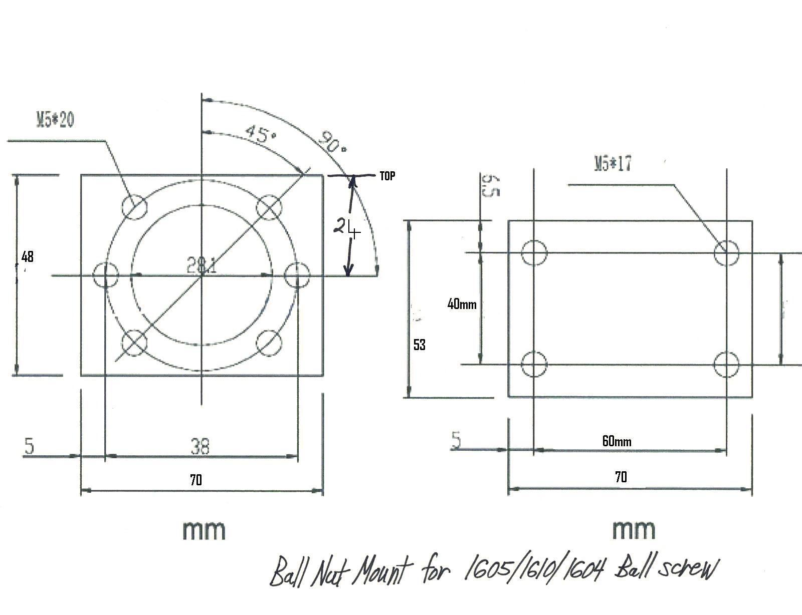

    Are the 1605 ballnuts all the same dimentions ?
    I am searching to buy one. On ebay different sellers have different ref, like ; SF1605 or RM1605.
    I am having my Ballnut housing custom made to the correct hight from the ballscrew center to the top of the ballnut housing. So I need to be sure that wherever I buy the ballnut, they are all the same dimentions between each mounting hole. This is my ballnut housing plan below.

    I do not have this ballnuts to measure them, I have just ordered them from Chai, but from their drawings, the Chinese RM1605 will fit perfectly in your supports. I have not encoutered the SF ones.
    cnc4you advertise it as an RM and there stock code is SF. I would like to say they are the same beast because i am sure i have ordered both in the past and they all look the same? trouble is is what comes across the sea consistent?
  4. The Following User Says Thank You to Swarfing For This Useful Post:
    I'd say they would be the same and conform to a standard on the mounting holes, would like to think the same for the rest of the nut dimensions but can only guess at a yes.

    Looking at your drawing the out most holes for the nut show 38mm, but the mounting holes show 60mm between cntres. the drawing looks like they should be roughly in line. Can you just check those measurements please. I will be near Richelieu in a few weeks and will be driving down through LeMans but not as soon as you would like.
