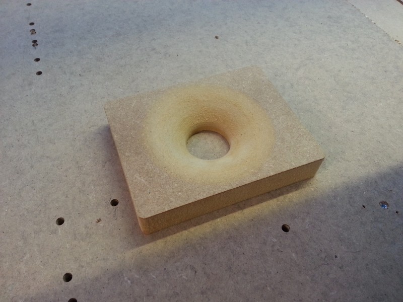

    First part!
    Went fairly conservative on speeds as this was my first part. Around 3m/min and 5mm DOC

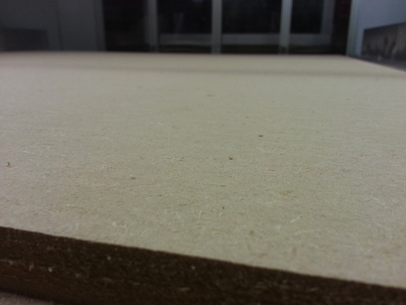

  6. #26
    For once someone surfacing the bed at a respectable feedrate :)
    What stepover did you use? When surfacing MDF, if I require an especially good finish, for instance when machining a PCB, I surface the bed with a 40% stepover parallel to Y (since Y is the fastest axis) and if not I use around 70%
    Quote Originally Posted by Shinobiwan View Post
    now its done I can't be arsed and want to get stuck in cutting some of the things I've got designed and waiting
    I know the feeling. I did make something to collect the dust initially, but it didn't work very well and I never got round to improving it...
  7. #27
    90% there as its not critical. I'm only laying 4x4ft sheets over the bed.
    Still got an ok finish even with the haste.

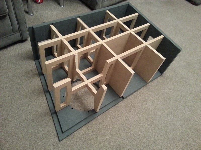

    More fun today.
    And the result:
  10. #30
    What is the grey material?
