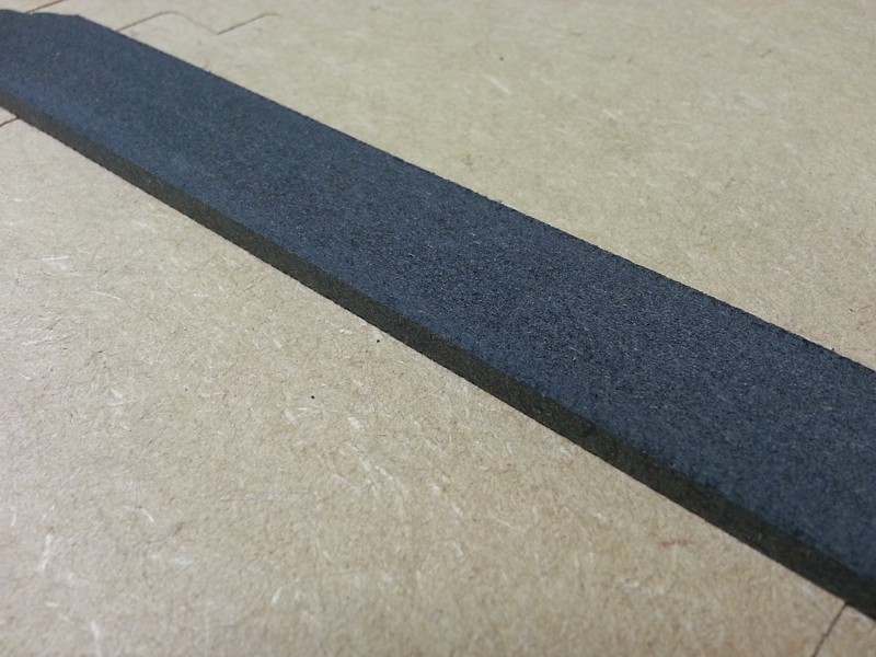

    Its a resin and fibre mix called Valchromat. Like a cross between solid surface and MDF.
    Machines brilliantly, is moisture resistant, easier on tooling since the resin acts as a lubricant and is 30% more dense than MDF. Takes paint finishes exceptionally well and drastically cuts down the amount of prep and finishing needed. I've attached a shot showing a machined edge with no finish pass. You can't see a hint of step down and there's no furring up like MDF.
    Its replaced MDF for me on critical parts such cabinet walls. Sadly its around 4 times the price and you can only get it from specialist wood yards so unless your luckily and have one on your doorstep then that will likely mean shipping it which isn't cheap unless you make it worth your while and buy a large quantity.

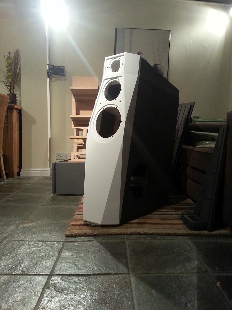

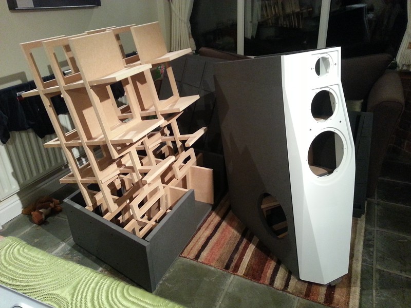

    Yep speakers.
    Lots more done today. Unreal how quick it is to make things with one of these.
