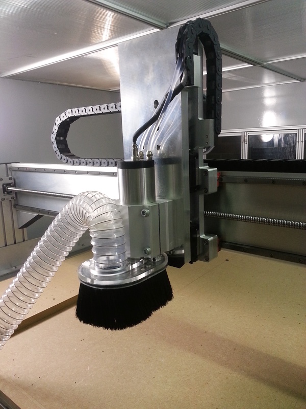

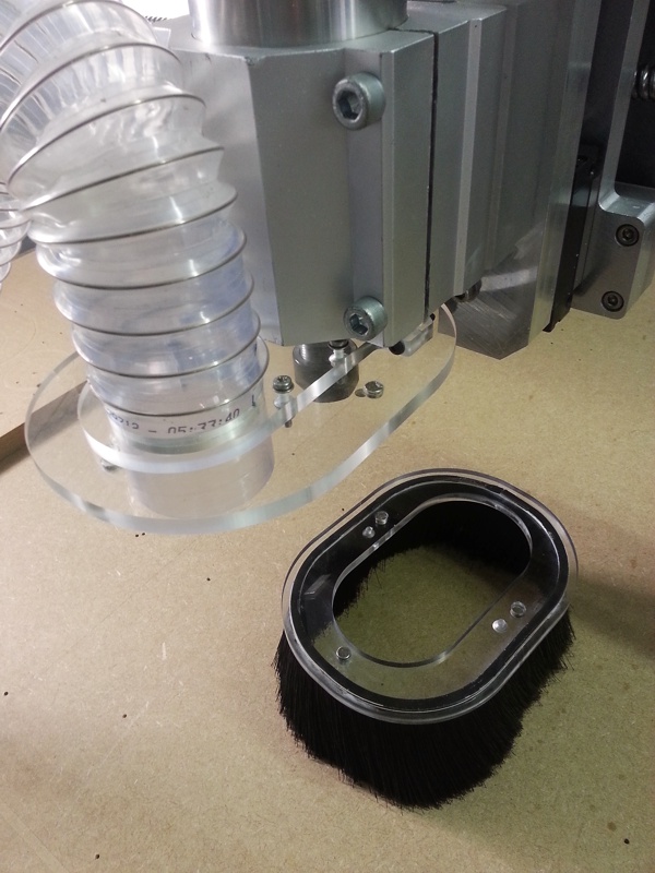

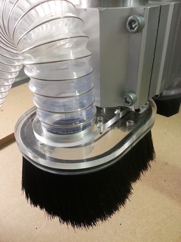

    Had another go at making a dust shoe and after picking up some cast acrylic this attempt came out much better. A week or so ago I did try to cut the same parts out of extruded acrylic and that stuff melted no matter what I did. Lesson learned - go with cast if the finish quality matters.
    Thanks to M.Marino for the advice on feeds and speeds. 3.5m/min with 3mm DOC and 14000rpm worked a treat.

    Looks good :) I've been struggling to get a good finish on cut acrylic for a little while and although I'm doing pretty well with it now I wonder if I also have extruded sheet. I'll have to check!
    What vacuum do you have? I made my dust shoe suck up directly around the spindle rather than just to one side. It works nicely no matter what direction I'm cutting, but I do wish I could get a stronger suck!
