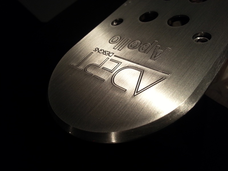

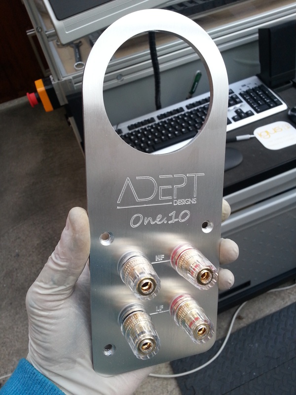

    OK here we have my first go at cutting aluminium. I had so much fun with these. Wood seems boring in comparison and you've got to be so much more mindful with how you go about cutting it. Oh and the engraving was an absolute frigtastic nightmare as well. Broke 3 cutters before I finally hit the g spot. Admittedly the cutters are uber fragile since they're pretty much needles sticking out of a 3hp spindle spinning them round at 24000 rpm. Even getting it slightly wrong would break them. There's a strong chance I'll end up getting a laser cutter/engraver at some point because its a painfully slow this way. Looks cool though and that's what counts.
    I finished them up with fine brushed effect and then sealed with a couple of coats of clear because without either that, etching or anodising then natural aluminium is a finger print magnet.
    As an experiment I'm going to have a go at filling the text with black spray on the One.10 plates. Once the excess paint is sanded back to the aluminium leaving only the lettering black it should look alternatively awesome. I choose not to do it for the Apollo as I really like the way they're looking straight out.

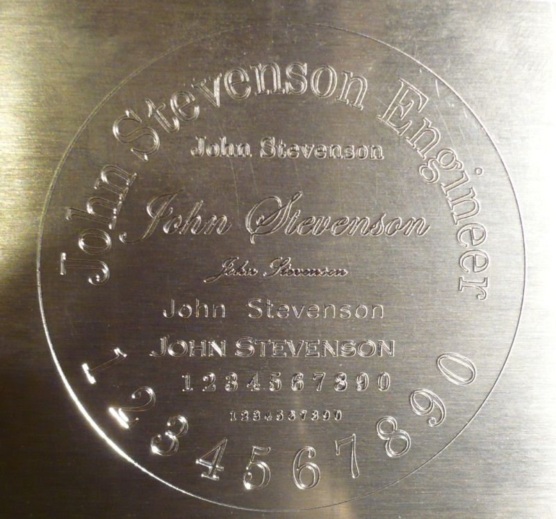

    Try drag engraving, next to impossible to break a cutter.
    Circle is 50mm diameter, small letters near the bottom are 1/2 a mm
    Laser will only engrave alloy if it's been anodised and the letters are always white, so just using anodised alloy looks a bit like an Italian flag, white cross on white background.
    You need a colour that compliments it like red, blue or black.
    If you want it the opposite way, black letters on alloy then you need a product called Thermark which is a ceramic slurry made from 3rd dynasty Chinese Ming vases as it's £100 an aerosol [ no typo ] but does last a long while
    John S -
