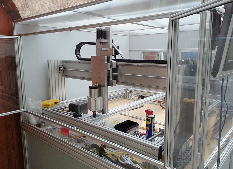

    After the first disaster the main area of concern was the gantry and Z axis. So back off to Strike and flushed some more money down the toilet to have them 'upgraded'. Threw out the Kress spindle and got one of the 2.2kw chinese WC ones whilst I was at it.
    Here's the new gantry. Much better than the last with 200x40 extrusion. Happy with that.

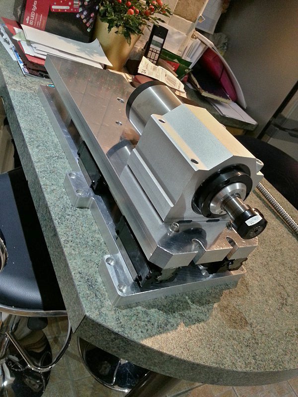

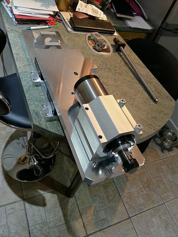

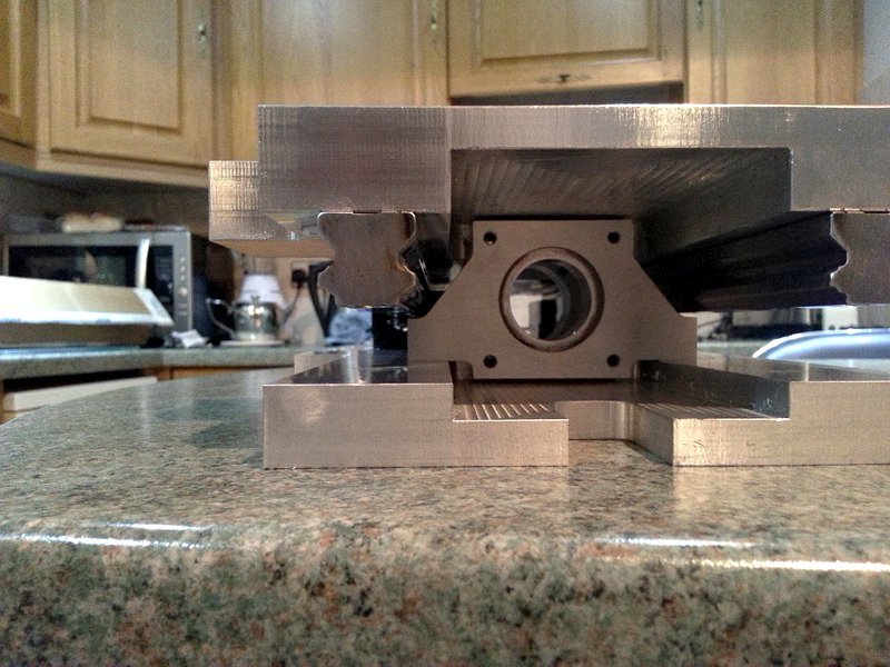

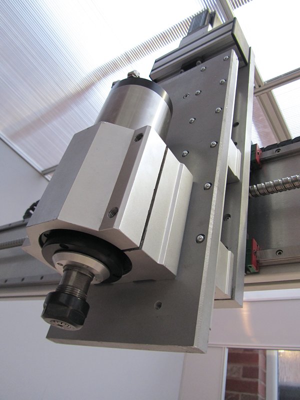

    So off comes the Z axis and I have a new front plate made to try solve the problem of not being able to tighten the supported rail. This works fine but then I realise despite ordering a machine with 200mm of Z travel I only really have about 175mm. Making it very tight for some of the jobs I have in mind. Thanks for that Strike. So I think sod it, I'll design my own. Can't be that hard can it.
    Here's the result...
Name:	New Z Axis (1).jpg
ID:	7696 Click image for larger version.
Name:	New Z Axis (2).jpg
ID:	7697 Click image for larger version.
Name:	New Z Axis (3).jpg
    Bit over engineered for the machine with 25mm linear rails and a 25mm thick ecocast front plate but overkill never hurts. It does slow you down though so will no doubt have to dial the speeds/acceleration back a tad after this but I'd rather do that and have accuracy with a good finish.

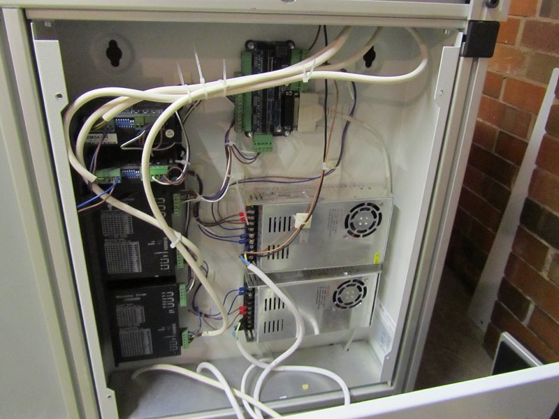

    The electronics, whilst functional in the original Strike machine, weren't giving me the speeds I'd have liked. These were upgraded for better Leadshine AM882 drives along with higher volts (75v). What wasn't acceptable was the dangerous wiring job by Strike. Things like the 240v wired through the e-stop, bare wire hanging out of screw contacts, broken wire insulation exposing dangerous DC voltages, no cabinet ground and incorrect colour coding on wiring. It was a death trap basically and would never have passed any sort of safety test.
    So I ripped the lot out and started from scratch with standard and sound safety practices such as e-stop on relays, home/limit switches, star grounding, cable management etc.

    After the upgrade:
Name:	Control Box New.JPG

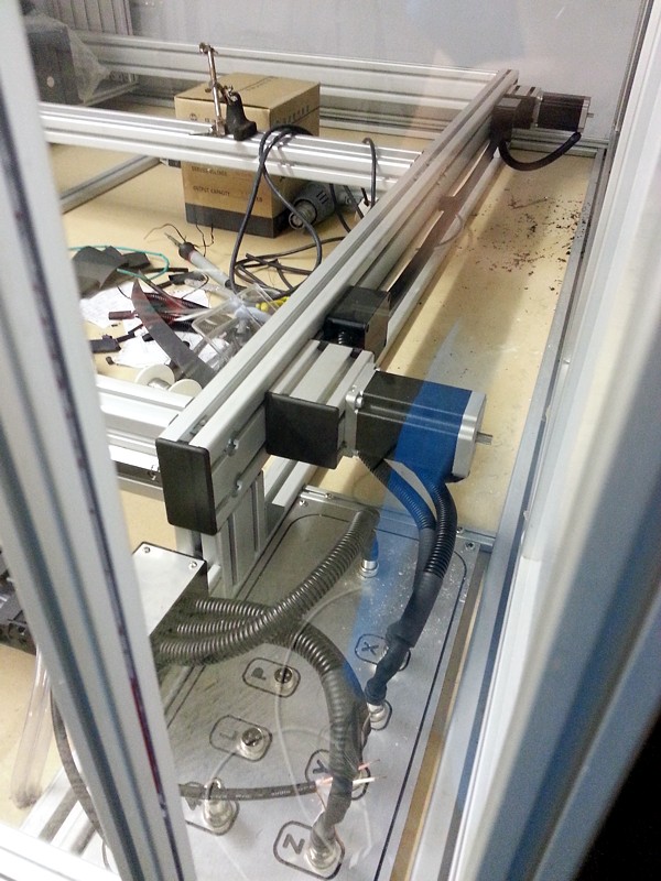

    I upgraded all the stepper wiring to shielded whilst I was at it too. Nothing more annoying than RF and EMI noise problems and the WC spindle can give off a fair bit of that.

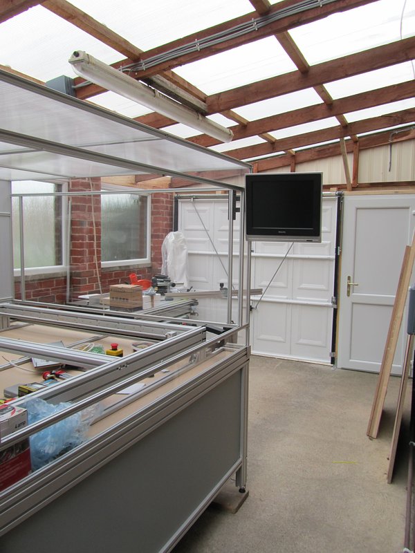

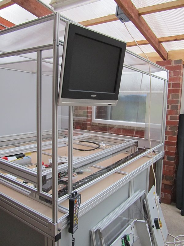

    Couple of simple convenience mods. LCD on an swivel arm so I can see Mach wherever I am.

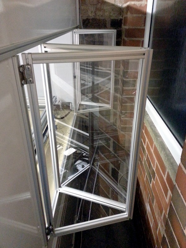

    And to the rear of the dust enclosure Strike supplied the machine incomplet! The doors were missing at the back. The whole idea of a dust enclosure is to keep dust out the workshop... missing doors isn't going to help that. I came up with something anyway but space was tight so went with folding doors.

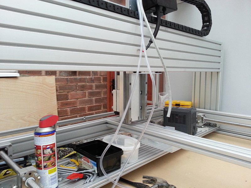

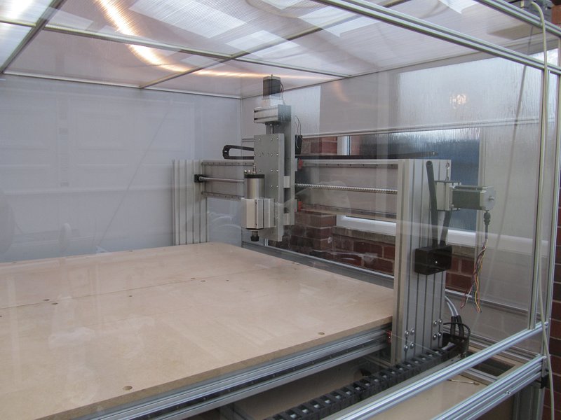

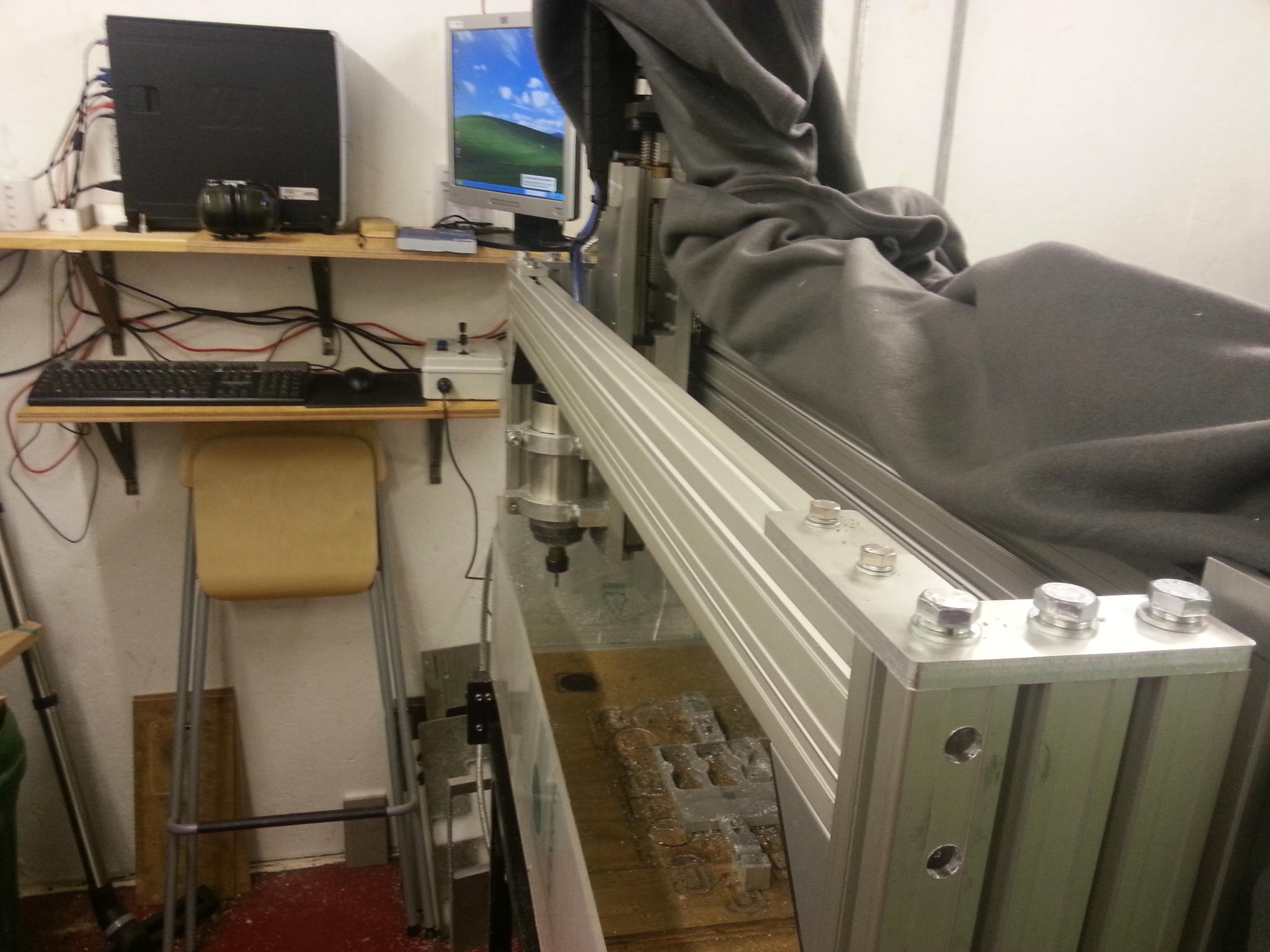

    Not quite done yet though. I'm having a complete strip down of the bed, gantry and z axis done.
    Once finished the bed will have a lot more support, bit more bracing on the gantry and everything will be square and true. I'll be cutting after that. Woop at last!

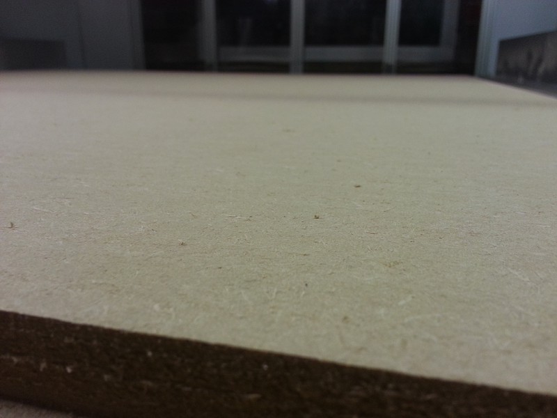

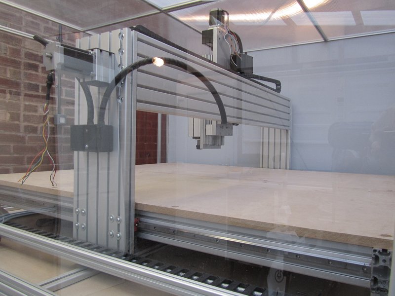

    For once someone surfacing the bed at a respectable feedrate :)
    What stepover did you use? When surfacing MDF, if I require an especially good finish, for instance when machining a PCB, I surface the bed with a 40% stepover parallel to Y (since Y is the fastest axis) and if not I use around 70%
    Quote Originally Posted by Shinobiwan View Post
    now its done I can't be arsed and want to get stuck in cutting some of the things I've got designed and waiting
    I know the feeling. I did make something to collect the dust initially, but it didn't work very well and I never got round to improving it...
    90% there as its not critical. I'm only laying 4x4ft sheets over the bed.
    Still got an ok finish even with the haste.
