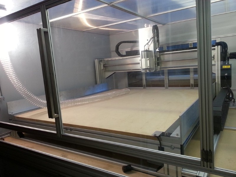

    Did fairly complete model of the machine and knocked out a render.

    Stiffening up the Y axis rails. 25mm Alu plate bolted into the extruded alu that the hiwin profile rails mount into. Also some 100x50x6mm L section to help keep the rubbish off the rails. Loads more rigidity after this.
Name:	Bed Reinforce2.jpg
    Its got a decently braced bed on there now. The original was pathetic.

    Inductive proximity home/limit switches including dual ones to auto square the gantry each time you home.

    The base of the cabinet was a big waste of space so a couple of doors have gone on there along with a floor and it now stores 4x4ft sheet materials along with the pump and reservoir for the spindle.

    Dust extraction has been plumbed in too. Need to make a dust shoe of course but that'll be the first useful part I'll cut.

    A big thank you to everyone here that answered my often dumb questions and helped me out. Special thanks to Dean and John. Dean in particular has been a huge help and thoroughly nice guy to boot.
    Now to get crackin with the cutting!

    Test cut of some code for parts.
    The machine is crippled at the moment since there's only one motor connected out of the two on the dual axis. Still does fine though but I wouldn't cut with it like that.
