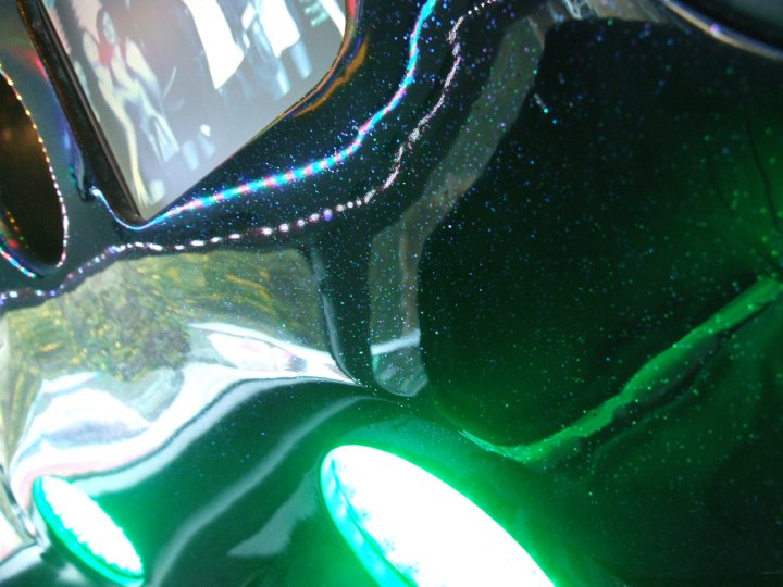

    i dont know if you clicked the links i posted but the primer comes with the hardner and the gloss comes with 1ltr of thinners to mix with 1.5ltr mixed paint/hardner and they say use 10% so in my eyes i should still have a nice bit of thinners left for cleaning if i'm good.
    i have sprayed one thing before with my gun but again that was cellulose
    above is my one and only attempt at spray gun painting and that was primer, black followed by 3 coats of lacquer each with a different colour of metal flake in it, i learnt a hell of a lot about fabrication and painting whilst doing that build and while i wouldnt sell something like that off now, looking back it was a hell of a lot better than my dads previous attempt. incase anyone is curious about that build i believe you can view the whole album here you will even notice my cheap ass measuring jugs from asda.. sod buying these expensive painting measuring jugs lol

    Thanks for posting that info, will refer back to this. Have you got any pic's of the results from doing it the way you describe because it reads fascinating when you think of what mdf is like as just bare material.
