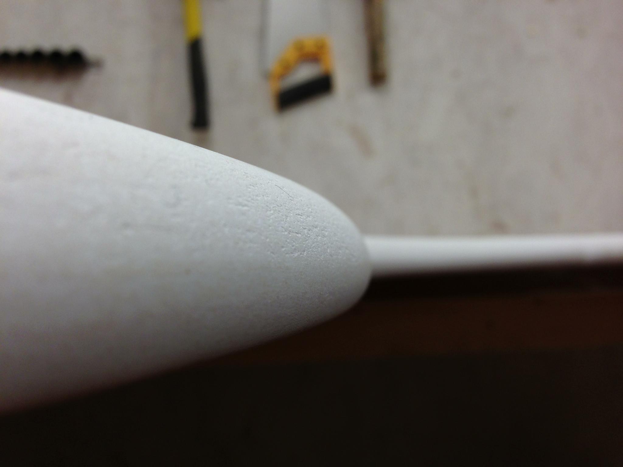

    and on the edge of the desk to get a nice smooth finish all i have used is an 18mm round over on the top of the desk and a small 6mm i think round over on the bottom of the desk, the result is something i'm very proud of as i've never achieved something like this before

    i'm just going to treat it like a car panel and i'm using car spray paint from halfords, i'd have really liked to go all out and get proper paint for my spray gun but i can't justify the extra cost of a big tub of lacquer, primer and thinners when i have no plans to spray anything in the near future.
    any kind of primer/filler primer/hi-build primer will easily seal mdf and i've been taught to use that stuff and seen it work many times. infact the white you see on the desk at the moment is just white waterbased undercoat from bnq and the only reason i used that is it's all i had and i wanted to smooth of this edge as i plan to use the desk for a bit before i paint it and last time i did this i got a rash on my arms from the bare mdf.
