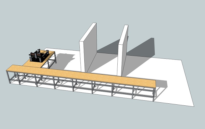

    Hi Guys,
    Just moved house and one of the main selling points for me was that it has a decent sized workshop.
    I thought I would throw a quick sketchup out there for critique, showing the workbench I am planning and machine location. Other bits I will be adding but not yet on are small spray booth somewhere in the right hand area along with a decent sized table for sheet material handling.
    The workbench itself is currently using 40x40x3mm box section steel and the long part is 7.6 metres long but can be shorter or a little longer dependant on what the standard size for box section is. I may redesign the section the CNC machine sits on to include diagonal bracing and possibly directly attach the machine to the frame for additional rigidity.
    The space under the work bench(es) will be sectioned off and turned into storage for tools etc, so diagonal bracing may not be required?
    I am thinking MDF for the worktop, but may go for some cheap kitchen top or possibly other options. The main workbench will also be housing my bench drill and a mini lathe of some description.
    Power will be two feeds - one at 32/40amps for the machines and another at 15amps for normal stuff, all run around the space in wall trunking of some description.
    If anybody fancies a job helping me weld the steel, let me know - as I'm completely green to welding - I'm located now in the hills outside of Bewdley, Worcs.

    Nearly forgot if anyone can advise - the walls of "workshop" are stone/mortar and the interior walls are as expected "rough as a badgers a*se" - They are too uneven to batten and board, so I'm thinking the best method wil be to use plasterboard "adhesive" and plaster board, with an injection of expending foam to fill in the cavities behind (wiring is all going into trunking so not an issue). The bit I'm not sure about is the walls have zero damp proofing (old barn/stable), so do I need some kind of membrane or air gap behind to conrol damp penetration or some other method? Plasterboard these days can come with barriers or premeability built in from what I have seen.....

    I would go for kitchen worktops. MDf has a nasty habit of absorbing most liquids and destroying itself. Kitchen worktops are easy to clean and will stand up to most liquids in the shop.
    Can't see any room for the Jag!! G
    Using adhesive straight on to a rough stone wall, I think will give you a lot of damp problems.
    Smart U Video 414 Metal Stud Framing - YouTube
    If you have the space you could use 50mm or 75mm metal studding and then plasterboard that would give you the air gap required and control any damp issues.
    You would then end up with a true and flat wall. With 75mm stud you also would have the space for insulation.

    Kitchen worktop it is and also will look at stud wall technique as I have some room for that.

    As well as the walls you need to consider the roof & what if anything your going to do about that, if you intend to do anything to try & keep it a bit warmer or intend to install any type of heating then this is the sort of thing I would be looking at doing before I started to plan where everything was going. Get the basic shell sorted first & then take it from there.

    Thanks - I should have mentioned that there is a converted upper storey above the workshop, which already has double glazing, insulation etc. When and if the weather clears up I'll have a poke about the exterior walls, as thinking about it there must have been some damp proofing done at the time of the conversion - I'm guessing a stone walled property would have to have had the "injection" type damp course if it has one. The workshop itself is nice and dry if a little musty smelling, but that may have been due to lack of heating/occupation before I bought it (I think the whole property was vacant for over a year). Certainly the roof/ceiling timbers in the workshop look OK with no dry/wet rot or worm evidence and the wall's interiors are dry.

    That's even better Chris, ;east you shouldn't have to worry about it for a considerable time. Is there any form of heating in the upper part of the building? If it's been left empty for that length of time & there is no evidence of damp on the workshop walls then there is a good bet that some sort of damp proof course has been fitted. If the original conversion was for any form of dwelling then it would have been required from what I understand. Don't know if commercial type buildings or offices are the same though.
    Is that 2 walls that stick out into the floor space & where is the access to the upper floor.
