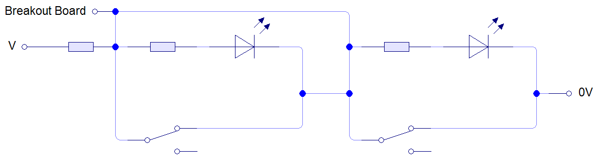

    If you're happy with just one colour LED - i.e. red when the switch is pressed, off otherwise, which basically tells you the same thing as having red/green, then it's a lot simpler. Just put an LED with series resistor in parallel with each switch.
    Since you will use normally closed switches, when the switch is open (pressed) the supply voltage to the switches is now present across the switch, so will light the LED. If multiple switches are pressed, the same is true except the voltage is now divided by the number of switches that are pressed so the LEDs would be dim, hence you need to choose the resistor values carefully. If you're happy with that limitation then this is a simple solution to implement, but for the sake of one extra component Robin's solution is better.
    Good try, but what happens if two switches open?
    Will 2 diodes and two resistors all in series sink enough curent to switch the Bob?
    How about three?
    Edit: I'm not explaining that very well am I? You aren't actually breaking the circuit, you are still requiring current to flow and light the LED's.

    I put this diagram in the previous post, but immediately deleted it as I realised the problem you mentioned:
Name:	Limit switch led wiring.png
    If V=5V, then when one switch is pressed the voltage at the node the breakout board is connected to will be the forward voltage of the LED, so about 2.1V, plus the voltage of the resistor. As you say that's probably acceptable with just one switch pressed, but still more susceptible to interference and probably not going to work with more.
    We can fix this by increasing V, to say 24V, and connecting the breakout board via an op-amp used as a comparator. Set the threshold of the comparator to be just under the voltage present when one switch is pressed, then any number of switches are pressed the comparator output will switch. I guess that does loose the simplicity...I'd do it your way, except I don't really see the point of adding LEDs!

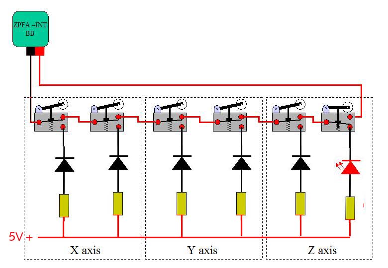

    Thanks for all your help, seems like i was asking for quiet a lot when i said simple. Forgive me but you lost me at OP AMP / Comparator, and can you explain what a gui is from a previous post?
ID:	7801This is my latest interpration, do you think it will work, i realise that the only LED to illuminate will be the one on the activated switch.
    Regards and Thank You
    Ray

  10. #26
    Lives in East Lothian, United Kingdom. Last Activity: 11 Hours Ago Forum Superstar, has done so much to help others, they deserve a medal. Has a total post count of 2,992. Received thanks 376 times, giving thanks to others 9 times.
    The plan above won't work as having just checked the datasheet for the BOB, the limit switch input is gets pulled to ground, so it won't provde enough power to light up anything, and adding LEDs in that way will probably be enough to pull it to ground.
    Using some kind of high impedence sensing is the only way to make this work without affecting the BOB input.
    For design/build simplicity and to avoid dealing with individual chips, I'd suggest an Arduino UNO. A quick sketch (arduino talk for code/programme) will do what you want easily, the inputs are high impedence by default, and it'll power LEDs easily.
  11. The Following User Says Thank You to m_c For This Useful Post:

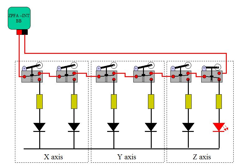

    Can't he just use a separate 5V supply and use the NO contact to make the circuit when the switch trips.? Simplizz enough to me.!!
    Edit: Like this.? Click image for larger version.
    Ray the same 5V supply that powers the Bob would work just take another feed from it.
  13. #28
    Or, use a double throw microswitch and have red green on every switch, fully independant and all on one 3 wire loop, easy peasy.
  14. The Following User Says Thank You to Robin Hewitt For This Useful Post:
  15. #29
    Hi Robin
    Many thanks, still confused, would that be a SPDT? I thought I was trying to illustrate that in my drawing, or did I get that wrong?
    Ray
  16. #30
    Hi Jazz
    Many thanks again, will this stop the machine from moving if activated.?
    Ray
