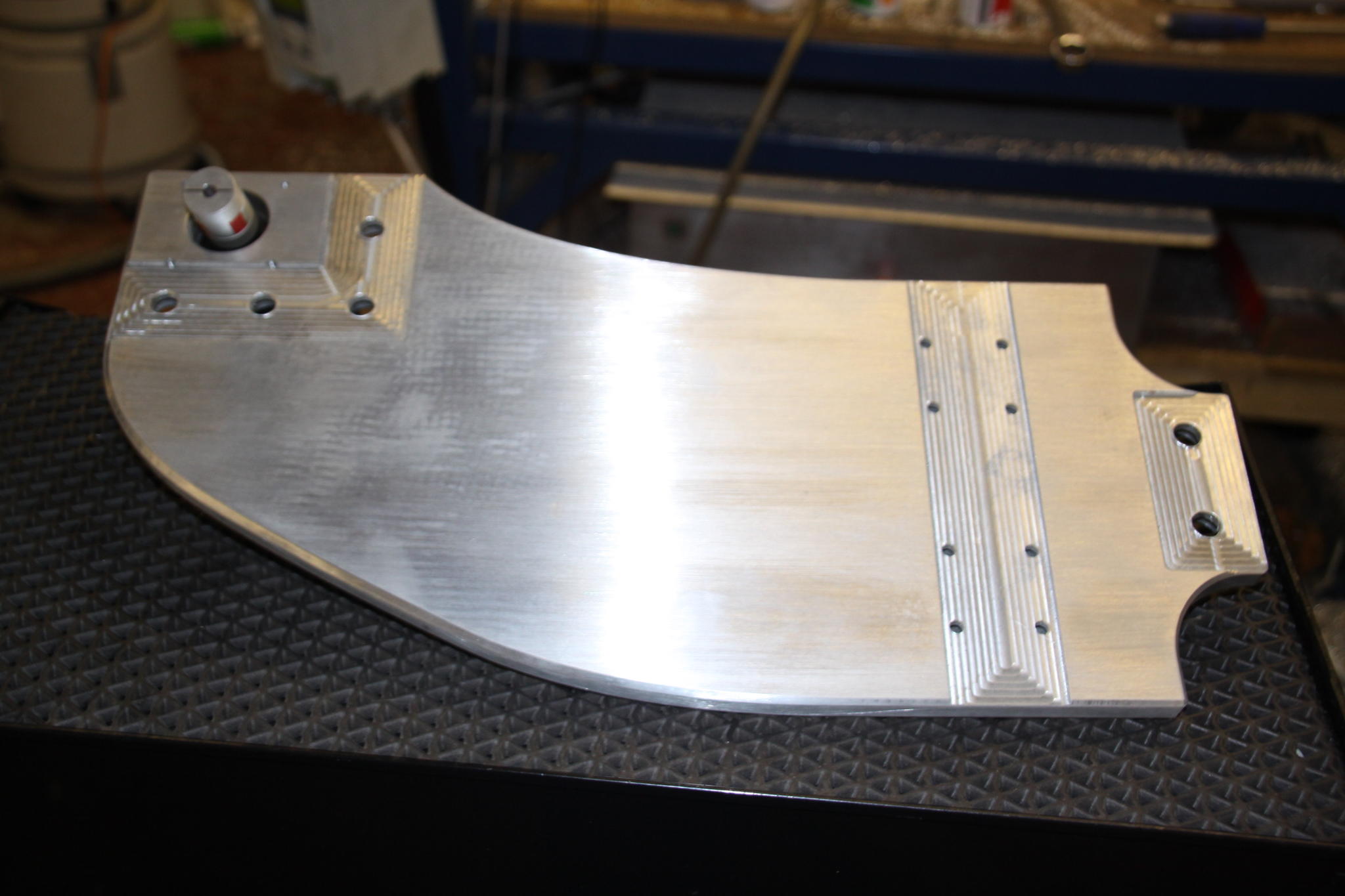

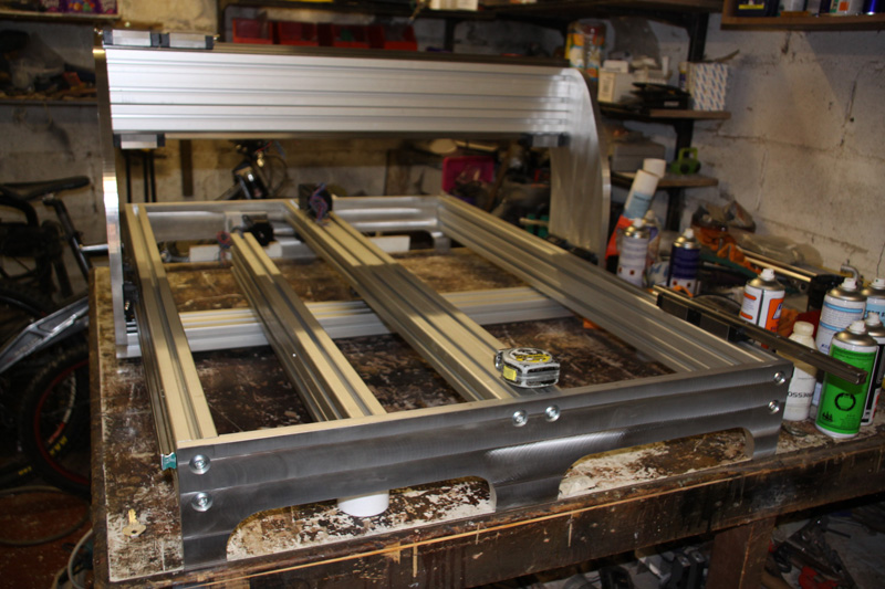

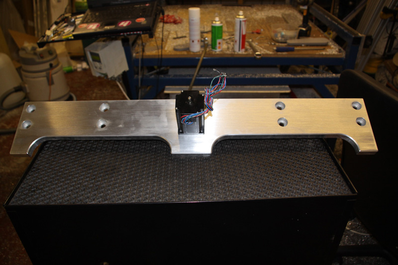

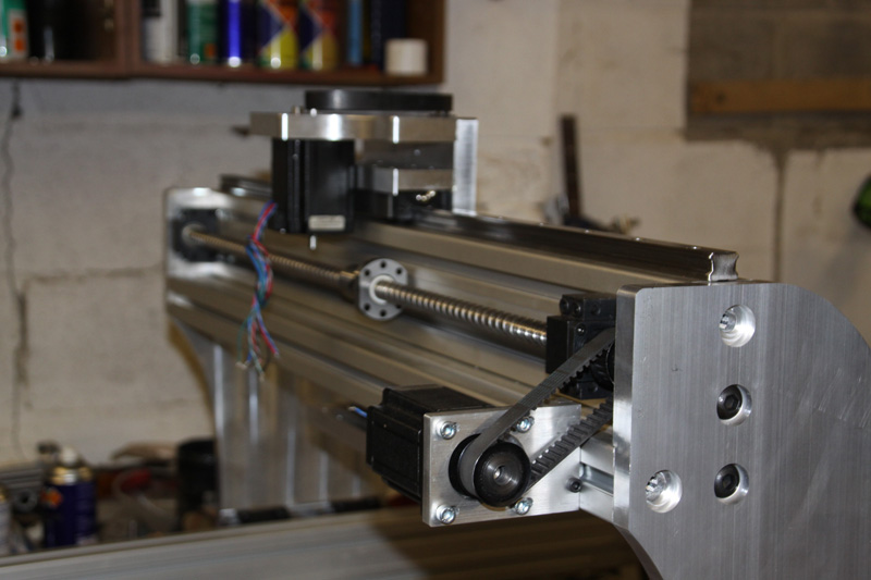

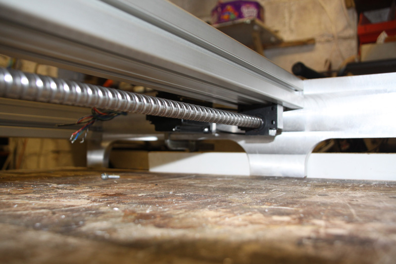

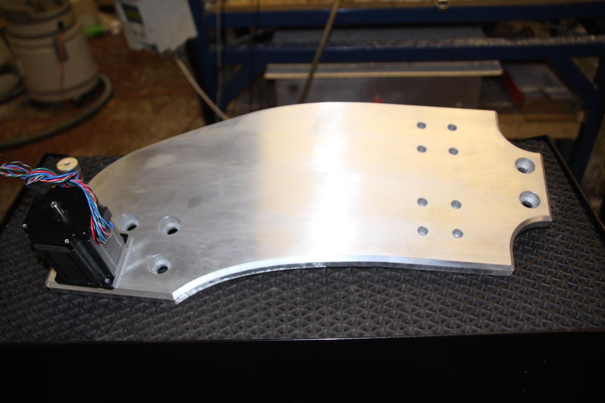

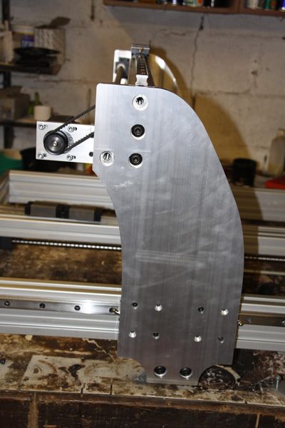

    Nice design! I won't be doing lots of aluminium to any particular high standard but I would like the capability. Out of interest, did you machine those aluminium parts yourself or have them done externally? (manual/cnc?).
    Dave
    Yep my design made by me for someone else.!
    Edit: Here's some more pics i've posted before of various bits of different machines built on the same design.
    I've built 2 versions one that had the motors on out side like Pic 1 & 2 and also version were the motors are all turned inboard or under bed like in pics 5 & 6 to fit in confined space like the corner of a shed.
    I also have version that use's twin screws on long X axis with shorter stubby sides if just doing thin materials and bit more capable at handling Ali with decent results and feed rates.

    Thanks for picture 5 Jazz. I've only seen the 'L' gantry as drawings before. Nice to see everything in real, like how the motors are supported and fixing of the ball screw behind the gantry.
  5. #14
    How thick are the aluminium 'uprights' if you don't mind me asking? I'm looking to use ~18mm at the moment but they look slightly thicker?
  6. #15
    Quote Originally Posted by biketrialsdave View Post
    They are 19mm from cut from 3/4" x 12" plate from here. Aluminium Flat Bar - Imperial Sizes (6082T6) 12 in x 3/4 in
