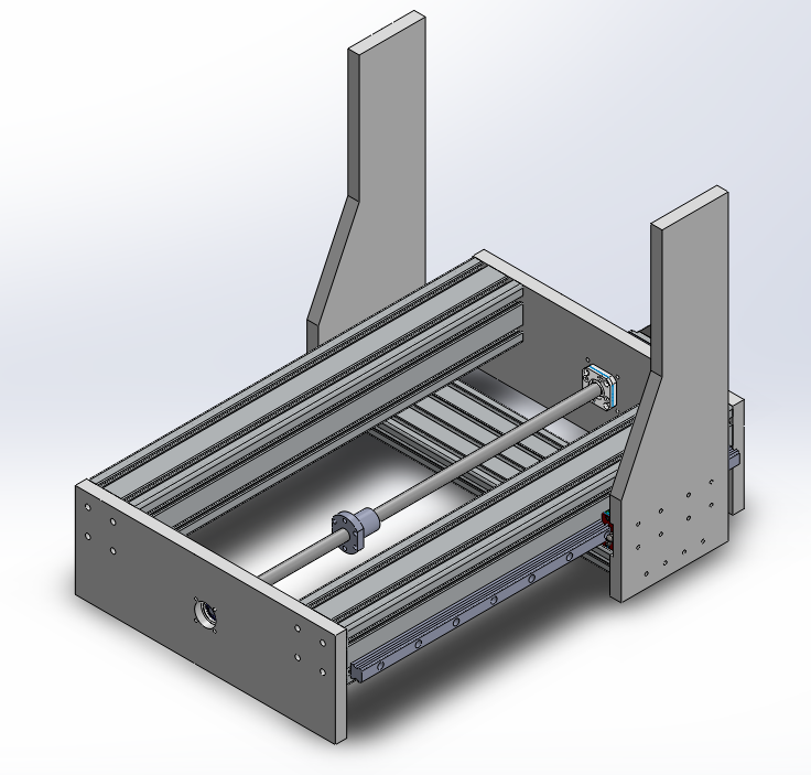

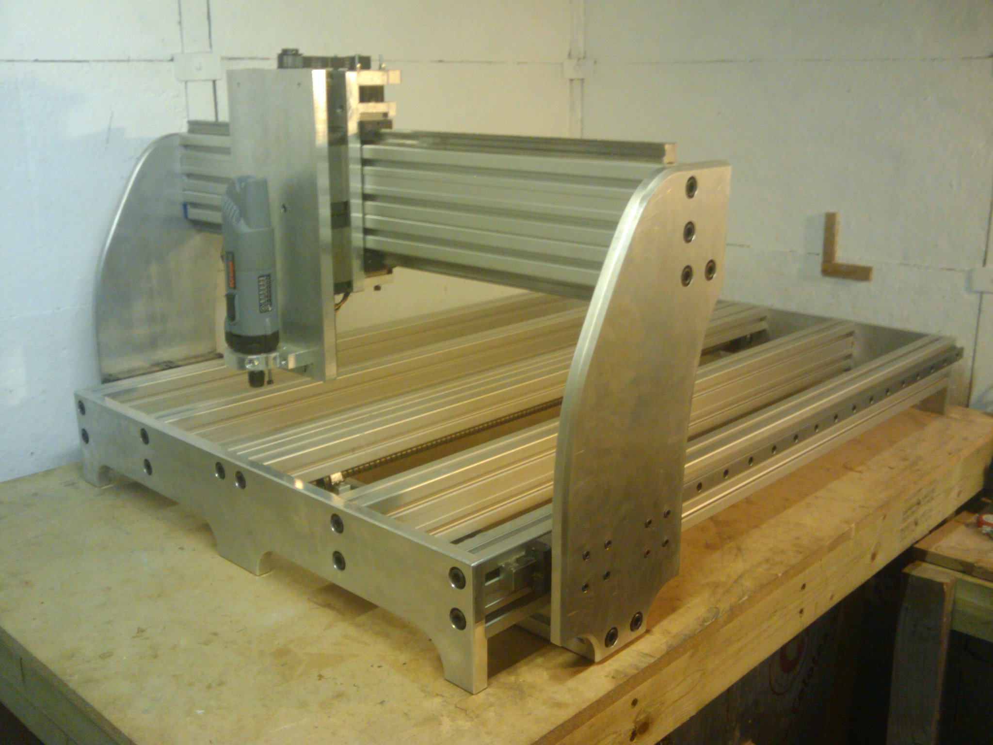

    Thanks for the input guys! I have considered the Chinese spindles but dismissed them on terms of the quality (although there is a large assumption here). Has anyone had any experience with them? I hear the VFDs aren't the best quality?
    Have no fear my friend I have had many thru my hands and they are well on top of the job. In the early days the VFD's where a bit shite but they are lots better know with faults fixed or ironed out.
    Been using one for years and they will eat that Bosch router for breakfast and on some of the long jobs I've done that router would have melted into a moulten mass of plastic. The duty cycle on WC spindle is pretty much continuous and I have done jobs lasting days not hours, 36hrs has been known. 10-12 in mostly Aluminium very common and routers just can't do that.
    Looks like you may have swayed me! Is the water cooling much of a problem? I assume a simple re-circulating pump like something out of a fish tank submerged in a bucket of water would do the job?
    Dave
    Yep my system works just like that it's a 25-30ltr barrel with a Lid top. You'll get from any local Chinese restaurant has it's what things like chutney come in.
    Then just use distilled water, I used distilled water, with approx 70/30 antifreeze mix. Just make sure the pump has decent head height, around 2mtr will do. Doesn't need to be high flow rate has they hardly get hot and don't need massive flow or pressure.
