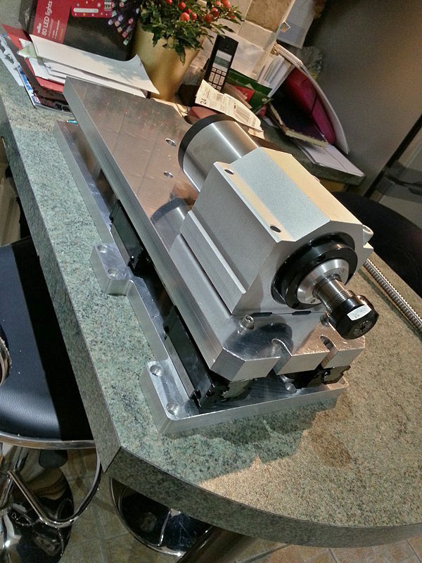

    If your feeling adventurous then using an SMA50 linear bearing housing with the bearing case removed provides exactly an 80mm dia bore. This is a very sturdy mount for the spindle since you've got over half of it clamped. You do have modify it a little though by cutting a channel in the side for the clamping action. Pretty simple really if you've got the right tool for the job(band saw, radial arm saw, a jigsaw with a good metal blade or if you clamped and set up a jig then a regular hand router with 3mm dia straight bit would do a great job). I'm surprised some enterprising sort isn't knocking these out to be honest. There's certainly a gap in the UK for it.
    The housing is £21+vat from Gary at Zapp.
    SMA50UU Linear Bearing with housing

    Wow - I had no idea that was a bearing block - thought it was a dedicated motor mount.
    Most definately going on my shopping list.

    I just stumbled across this post and have a different idea for the sma50uu housing... does this housing have circlips front and back to retain the bearing bushing?
    Thanks.
  10. #9
    Quote Originally Posted by drumsticksplinter View Post
    Thanks.
    Yes it does, worked a treat for the spindle.
  11. #10
    Great, I'm wondering if the 80mm bore is a bearing fit / interference fit??
