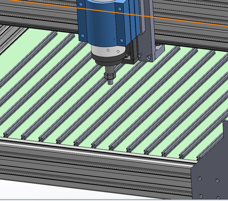

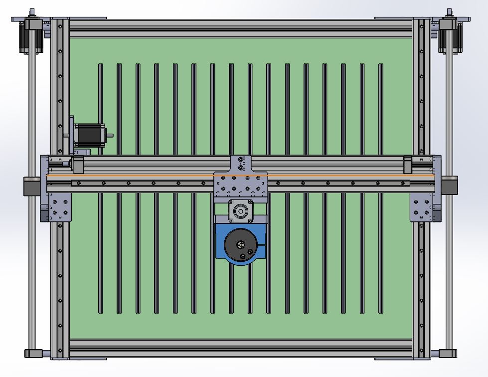

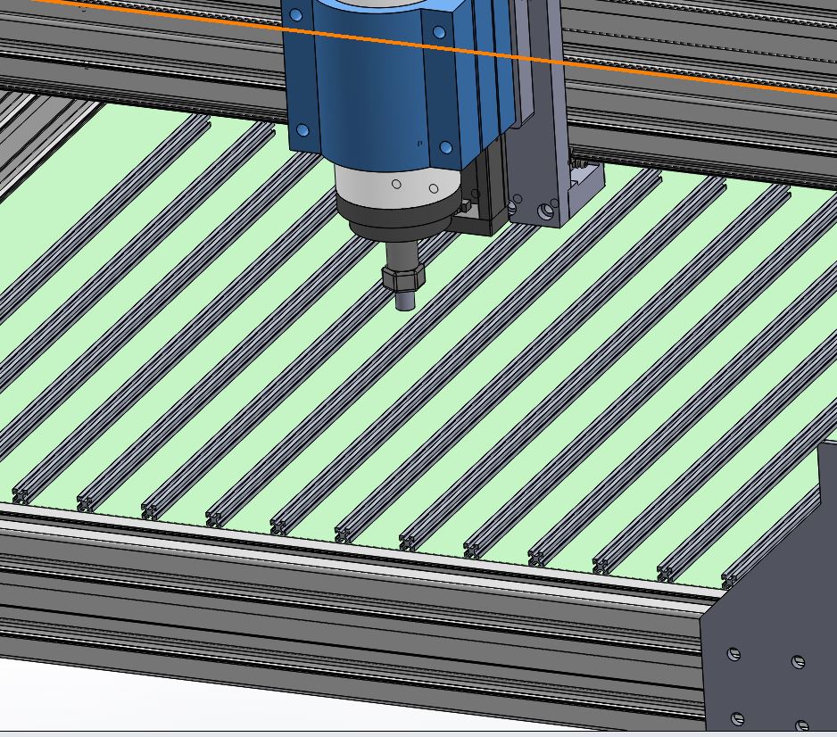

    I may of found a cheaper solution. "MakerBeam" is a 10x10mm extrusion and relatively cheap. I was thinking something along the lines of this:
Name:	Bed Beams.JPG
Name:	Bed Beams2.JPG
    For the bed plate itself (shown in green). What would be the most cost-effective solution? The dimensions are 725x825mm. Steel or aluminium? What thickness would suffice?

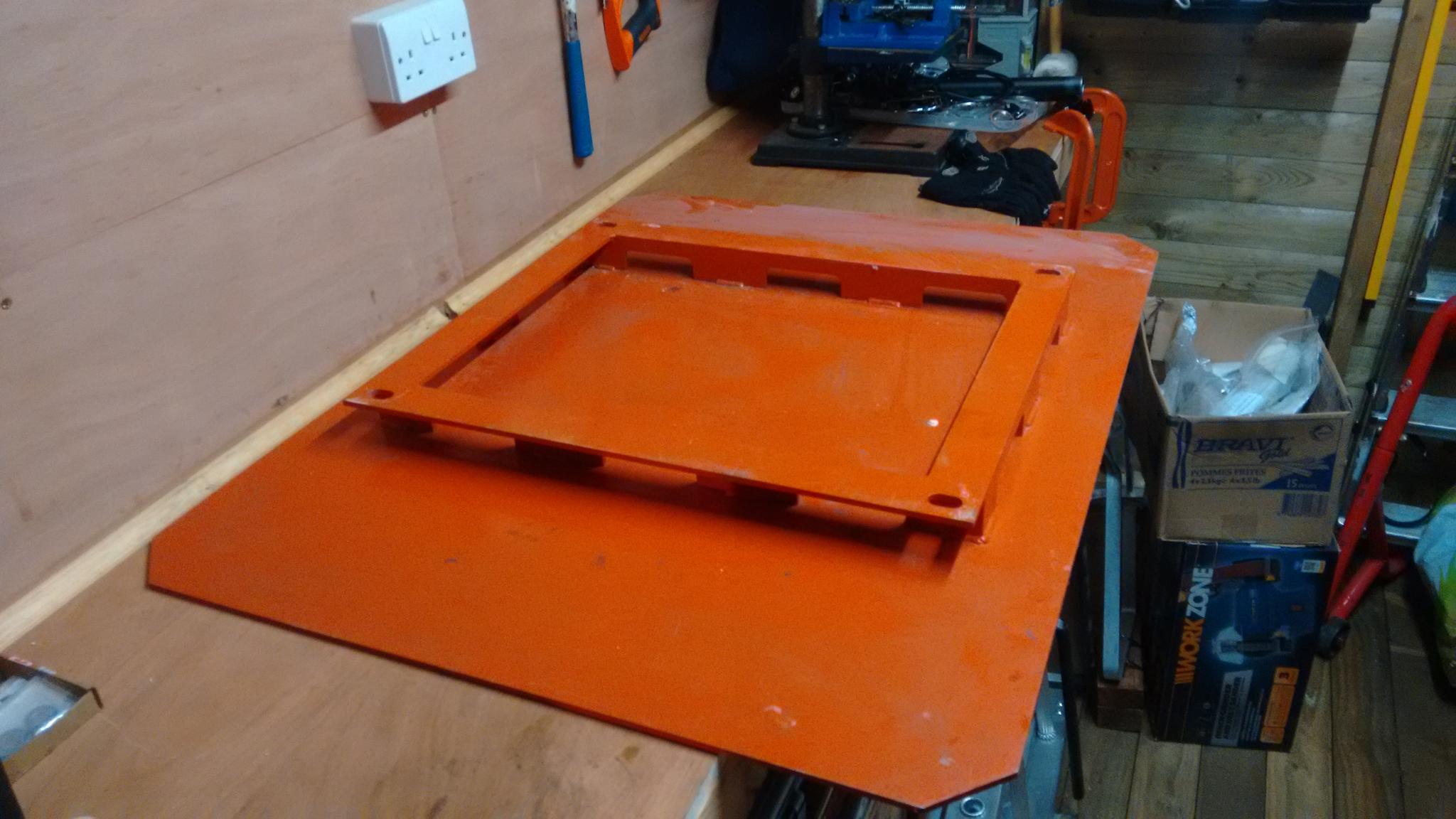

    I might of solved my bed problems! Look what I found in the skip at work today (along with other goodies)... It's 6mm steel plate. The dimensions are perfect for the machine to sit on. The raised area in the middle also looks perfect for mounting a bed (aluminium plate or t-slot plate perhaps?). My only concern is how flat and level the plate is. I was thinking it doesn't matter too much if I skim the aluminium plate (or whatever) with the machine once it's built?Click image for larger version.
