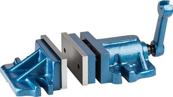

    Quote Originally Posted by biketrialsdave View Post
    Has anyone used one of these two piece vices before? Only 75mm total height which would help me.
    http://www.arceurotrade.co.uk/Catalo...Milling-Vice-6
    Attachment 19240

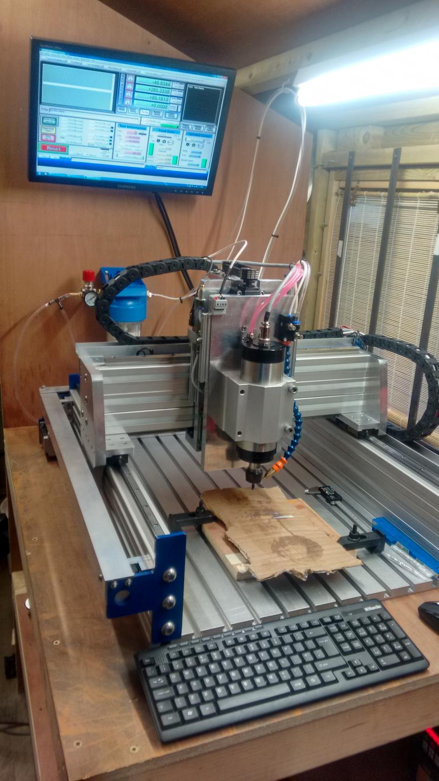

    Long time since I've posted! Currently setting up to cut aluminium, just built a fogbuster clone...

    O C'mon you cant not show us it working !!!

    Aluminium??!! Looks more like soggy cardboard to me 😉

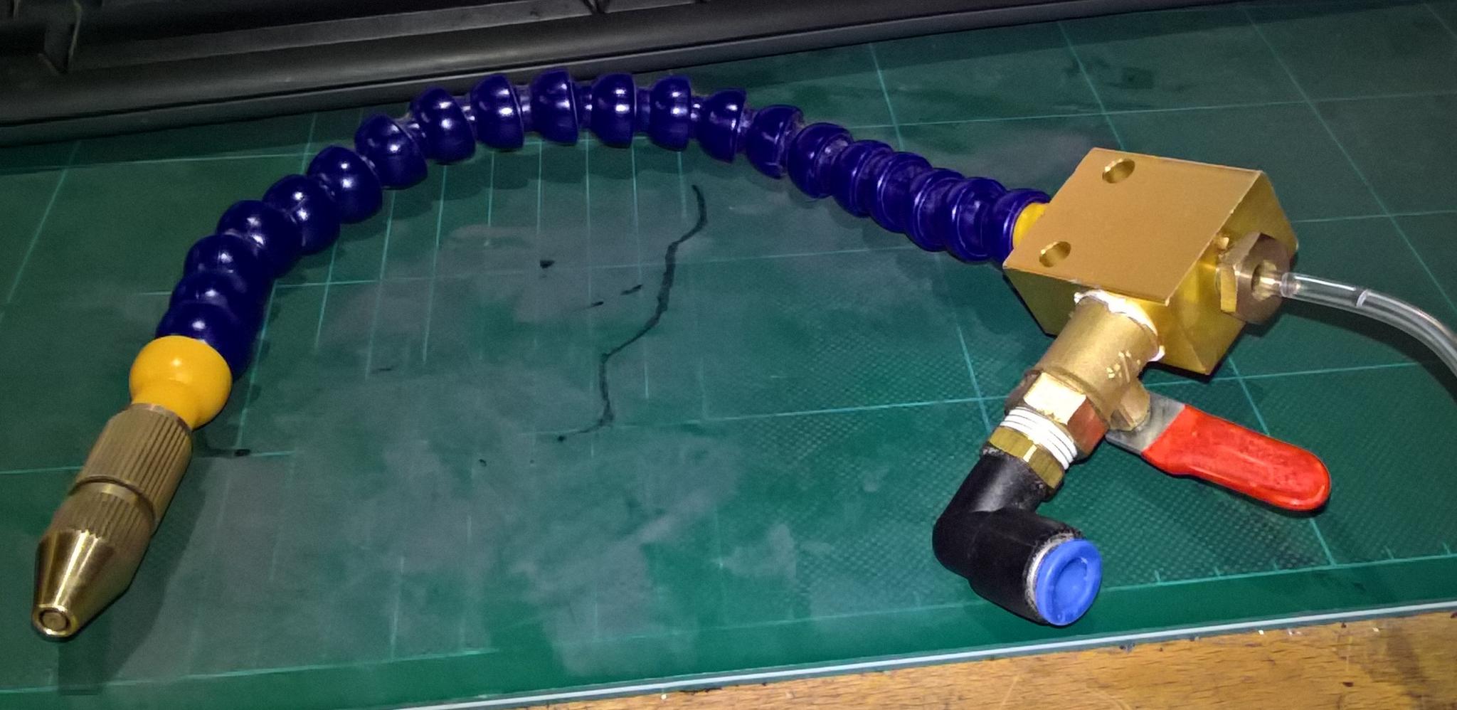

    I have a chinese mister Click image for larger version.
ID:	19664, which cost about a fiver and I have a project to use an arduino to control a peristaltic pump (which I 3D printed a short while ago) and an air solenoid valve. I intend to see what separate bursts of air and fluid is like for clearing chips and then dispensing coolant. I have all I need for the experiment, except my health has taken a downturn for the time being, but I want to get some progress on it.

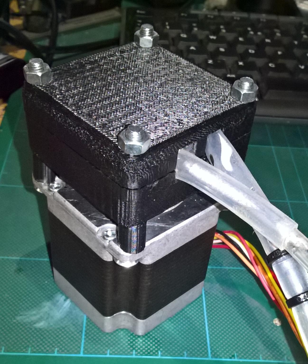

    Sounds interesting, I'll have to Google "peristaltic" first though :)
ID:	19665 This is the pump, it basically massages the fluid though a soft tube, like the muscle action in our guts that keeps 'everything' moving. With a stepper to drive it, you can get very precise doses at high (ish) pressure.
