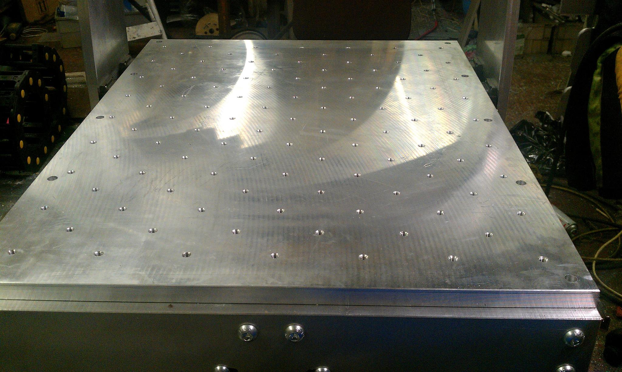

    My latest thought is to bolt down a 20mm aluminium plate to the top of the steel raised area (shown in photo). I will then use the machine to skim the surface flat. Then I will use the machine to drill a grid of holes which I can then tap (maybe the router could do this??) for holding jigs and fixtures.

    A plate with holes in should work well. But I don't think the WC spindles have enough torque to tap directly? However, you can try thread milling using a special cutter (~£40), plus your CAM will need to be capable of a spiral cut with user parameters on the pitch:

    Can't imagine that plate is flat enough to be useful and could cause you more trouble than it's worth.?
    Personaly I would just buy Machine tooling plate that is ground perfectly flat. Put your Profile etc directly on this and then shim out any error using the nice flat surface for reference. No need to skim flat. Then you can drill tap matrix of holes. Forget tapping with router type spindle no where near enough torque or control to do this unless thread milling. It's nothing of job to do with spiral flute tap in a Cordless drill.

    Just to clarify...use the machine tooling plate as the bed? The problem I see is they are very expensive? Any links to something appropriate?

    Try these people. I deal with Lincoln branch but believe they have place in WH that will give you a quote and you'll find the price of Machine tooling plate isn't that much more than normal plate. Being Cast plate it's much more stable and being ground it's obviously flat so is worth the extra IME.!
    http://www.ascmetals.com/
    Here's Some I prepared earlier.!!
