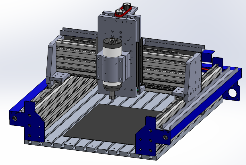

    I figured it was about time I started a proper build log since starting a thread in the new members section. Before I get into the details, a little background of myself. By day I am an Electronics Engineer and by night I am a keen hobbyist! I have built many projects, re-built a couple of motorbikes and fix my car on a regular basis (its french ;) ) but building a CNC router is something I've wanted to do for ages. Now I have some spare time (girlfriend depending!) and a little spare cash (girlfriend depending ;) ) I feel I can finally go ahead with one.
    So here goes...I guess the first question to ask myself is what I want the machine to cut. To that I answer: Wood (MDF), Plastics (Acrylic, Delrin etc) but also Aluminium (basic plates/small parts).
    I have kicked off a design in solidworks and have a VERY basic outline (not done any detail yet) of what I am looking to achieve:

    Along the way I have already made some decisions on parts, as follows:
    • 20mm Hiwin Rail/Carriages all round.
    • RM1605 Ballscrews.
    • FF/FK12 Ballscrew End Supports.
    • 80x80 Profile 8 Extrusion for the Y axis supports.
    • Chinese 2.2kW Spindle
    • Nema 23 Motors.
    • THK KR33A Z axis (Purchased this cheaply off ebay)
    • Approximately an A3 build dimension.
    Like everyone, I have a TON of questions to follow but will post those up separately when I get time to compile them all.
    As always, I'm open to opinions/criticism! It may well be that the whole design changes before I start ordering parts.

    Hi Dave,
    On the basis that it is broadly similar to my machine, but with slightly better components and smaller footprint (and assuming that the sides are 15-20mm aluminium plate?), I would expect this to perform very well for MDF and plastics. Aluminium would be best cut in the middle of the bed since you only have a central ballscrew (like my machine). Even so this would not suit regular aluminium cutting.
    Adding a plate across the back of the gantry, between the 2 cross members, would be a useful addition.
    I know it is only A3 size, but if you ever think you would upgrade to twin ballscrew in the future then you could increase the width of the end plates and add ballscrew mounting holes so it is ready to go. You would also need more holes in the gantry sides to mount the ballscrew.
    Thanks for the feedback. Twin Y axis (I assume you mean Y?) ballscrews was on my list, I will probably add the mounting holes in so I can add them in the future. All plate will be 20mm thick I think.
