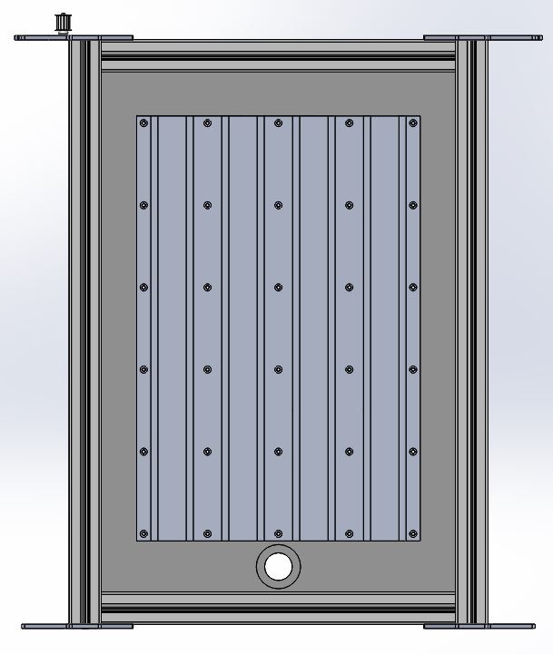

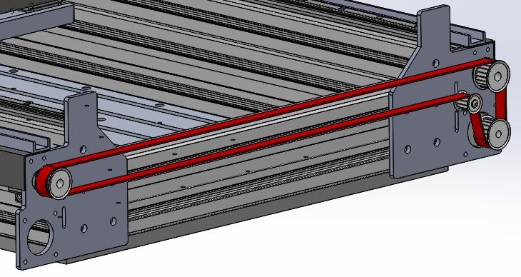

    Word of warning before commiting fully to this route.? Make sure you can buy a long enough belt of the shelf other wise it means having custom length belts made. Not a Big issue but still worth thinking about now.
    The available belt lengths may also mean changing the location of the tensioners so work out the belt length needed for how you have it drawn now and see if belts are available that will work.
