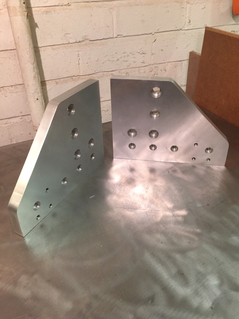

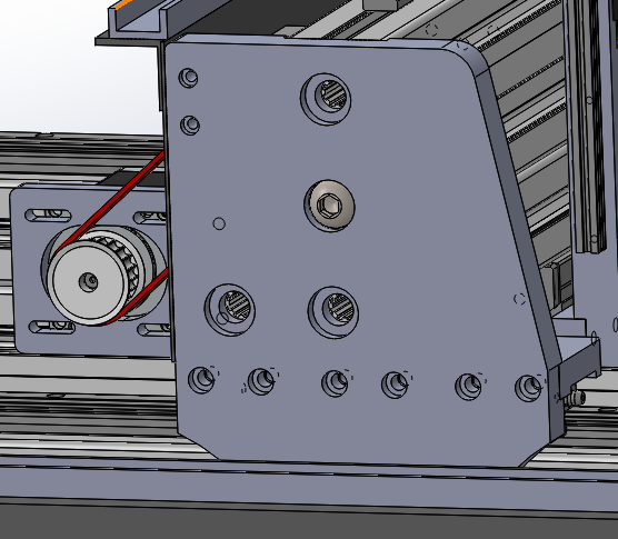

  1. I have counterbored m12s into 20mm plate. The 8mm left between the head and the extrusion is plenty enough.
  2. #202
    I think that looks like the best solution. There 20mm so 8.4mm thickness left according to solidworks. Now the question is, do I attempt to drill them out and re-bore myself or send them back and get them re-done professionally? I'm worried about the drill bit wandering off from centre.

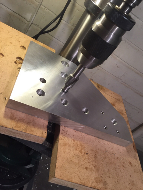

    Well that's up to you! My build has been decidedly diy so I'd have to do it myself! I would have thought the bit would find its centre in the existing hole...
  4. Click image for larger version.

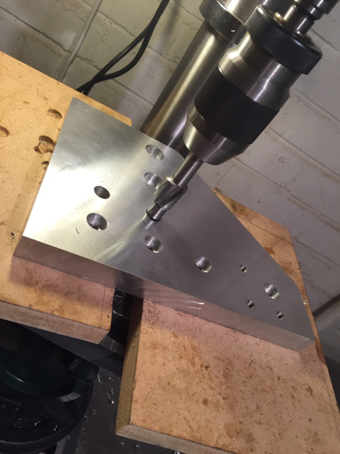

ID:	17512 these were drilled out with several bits starting small and working up...... You would just be starting further down this process?
  5. #205
    They look very good! I assume you used a drill press? (mine is an el cheapo one and has a bit of play in the head). Did you use any kind of guide for the bit?
  6. No, no guide and my press is only a table top Axminster thing so nothing pro! Click image for larger version.

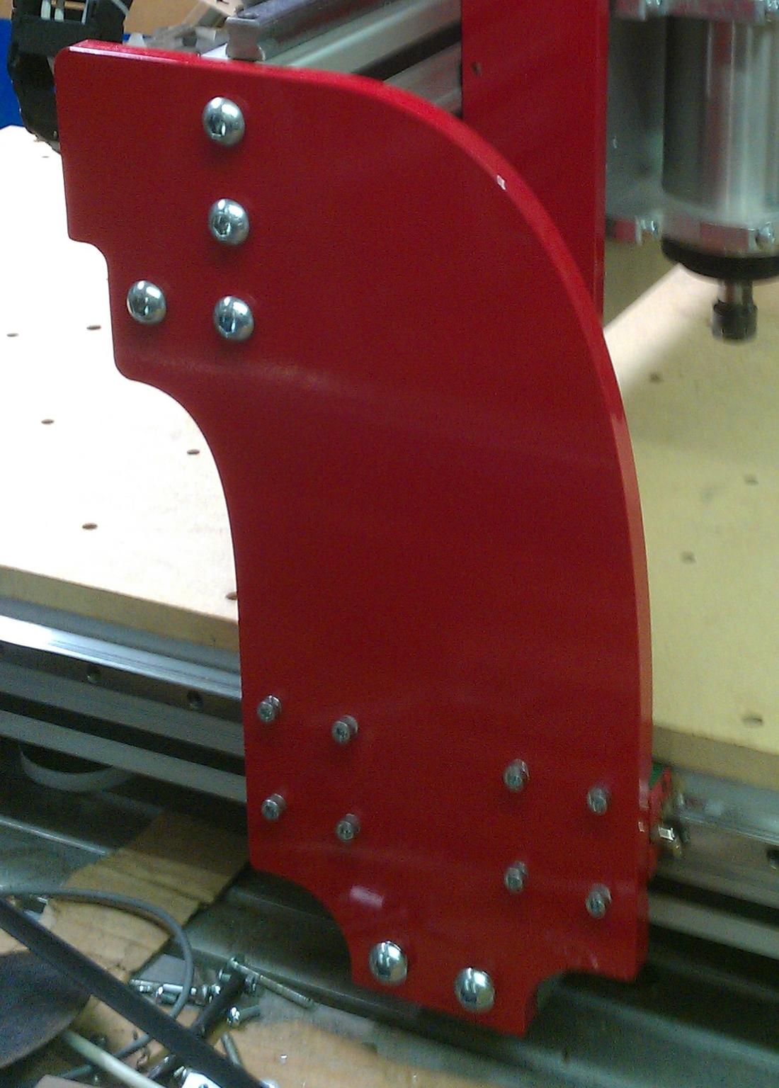

  7. #207
    Quote Originally Posted by biketrialsdave View Post
    Minor detail not worth stressing over. Domed head look fine without being counter bored so don't bother just drill them out to 12mm.

    Normally I do counter bore Joe because it's even easier when Cnc machine does it for you but In this case budget was tight and machine is small so 15mm plate was used so not much room to play with and it's only cosmetic anyway so no matter.!
