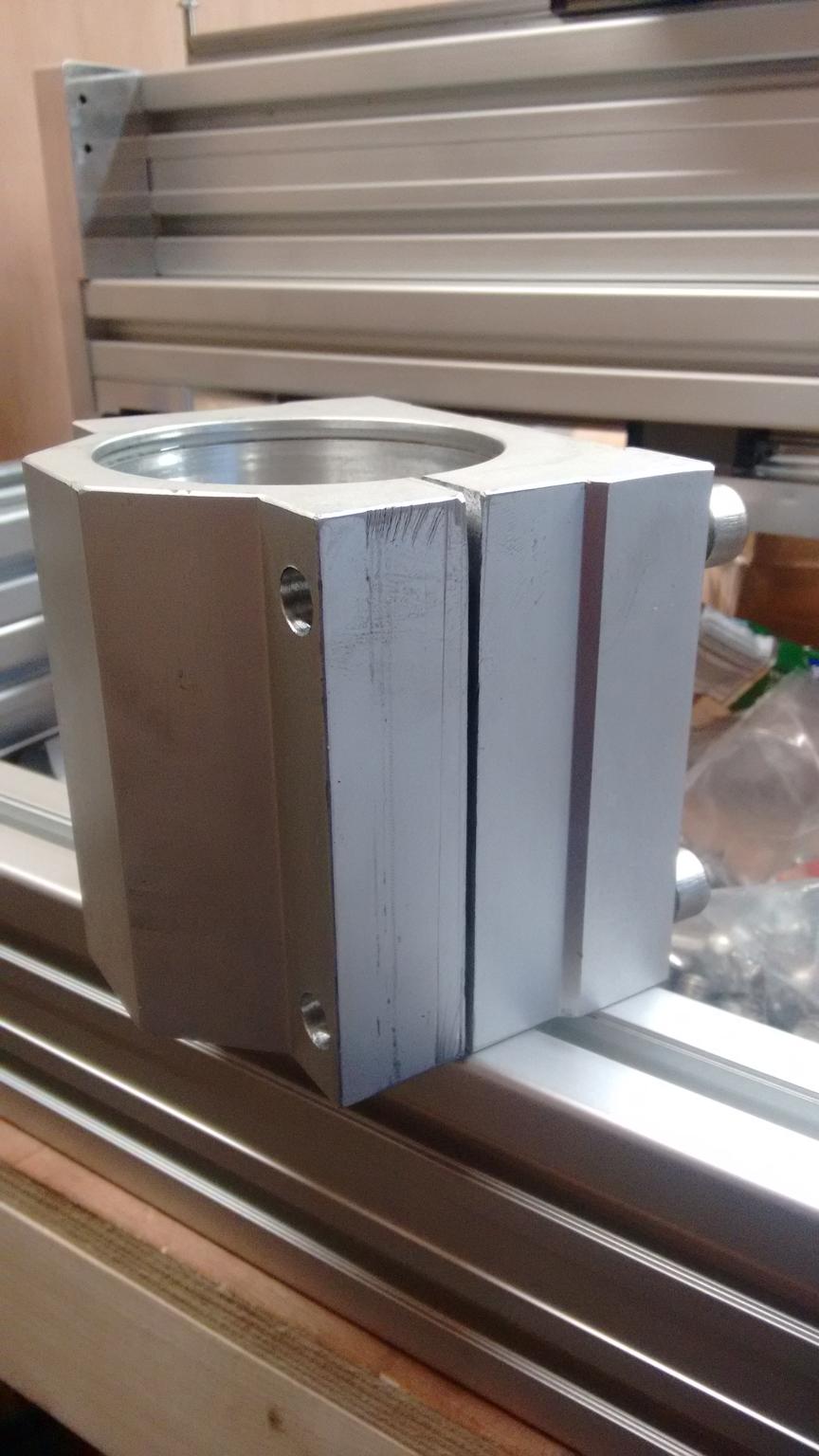

  2. #222
    Very productive day today.
    Sneaky peak...
ID:	17617Click image for larger version.
ID:	17618Click image for larger version.
ID:	17619Click image for larger version.
ID:	17620Click image for larger version.

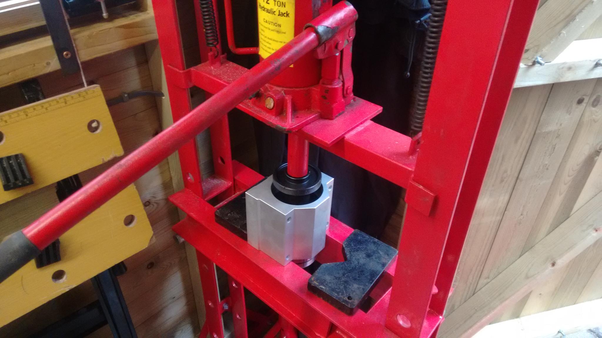

  9. #228
    Getting there slowly!
ID:	17636Click image for larger version.
ID:	17637Click image for larger version.
ID:	17638Click image for larger version.
