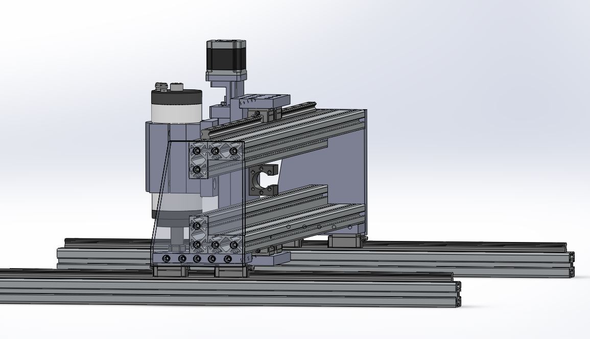

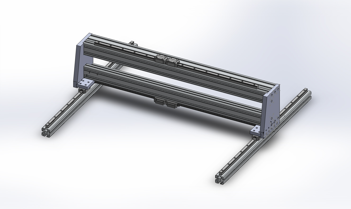

    Some progress on the new design...
    Many more questions to follow! =)

  9. #38
    Hi dave, put some additional ali profile in between the current lengths, then lock it all together from the back so its more like one solid mass.
    .Me
  10. #39

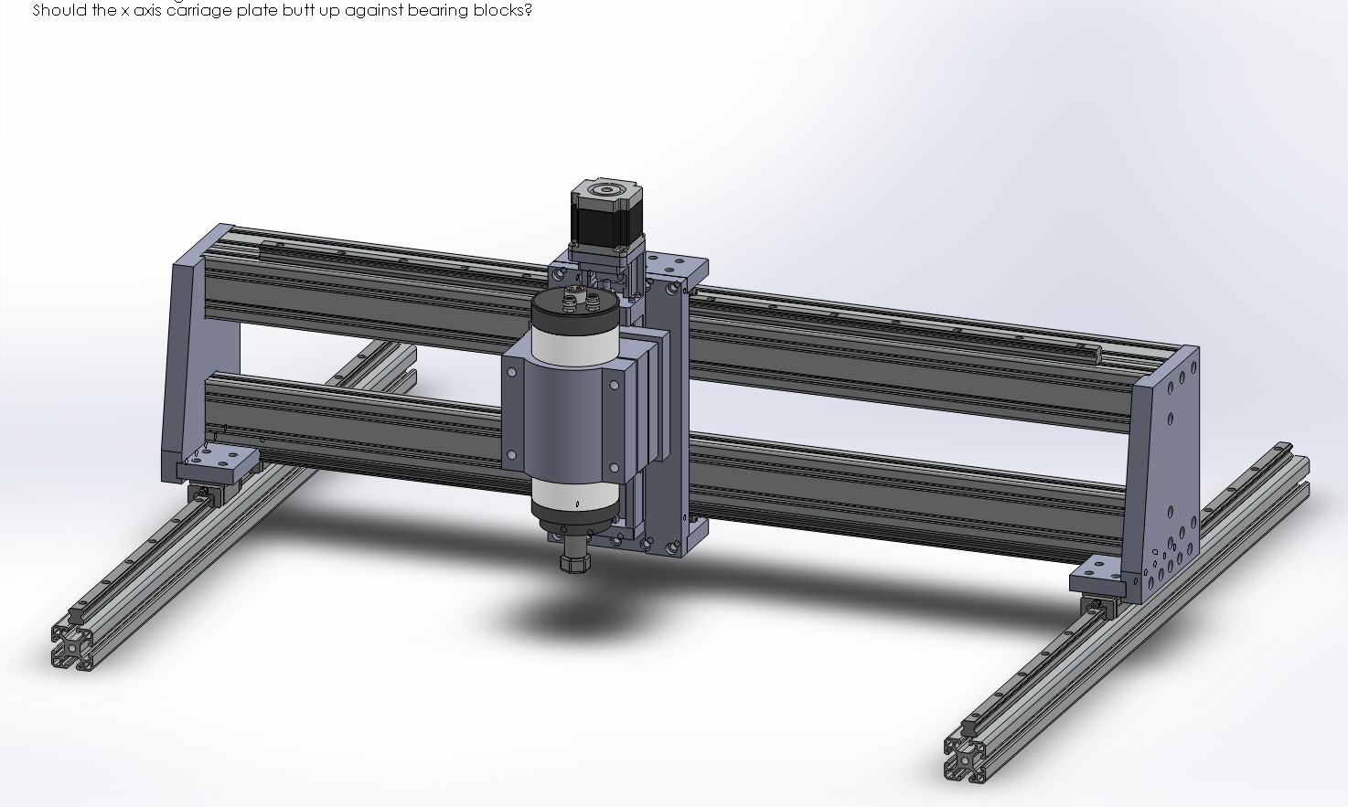

    Good suggestion, had something like that in mind. As the design currently is there is a 120mm gap between the top and bottom profile pieces on the gantry. That would nicely fit another piece of profile and completely enclose the back (although then I wouldn't have easy access). Either that or perhaps some vertical pieces of profile between the two horizontal pieces maybe?
Name:	Main Assembly back trans.JPG
  11. #40
Name:	Main Assembly.JPG
    A axis added - some detail missing.
