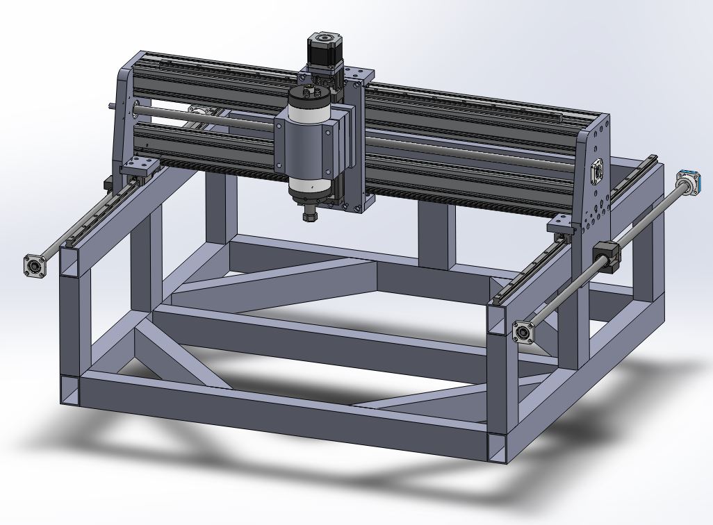

    Started work on the base...

  5. #65

  6. #66

    Better just put some triangle plates on the front uprights and your sorted.
    Still need to sort that gantry thou and put the bottom profile flat with vertical one above it.! . . . Hard to see from drawing but what size profile is it.?
  7. #67
    3mm it is!

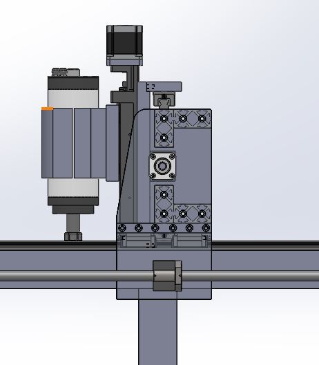

    Yes, still a bit of work to do on the gantry (motor mounting etc). The profile is 80x40. If I can mount the motor on the outside of the gantry end plates then I was going to put another piece of horizontal profile in to enclose the back completely.

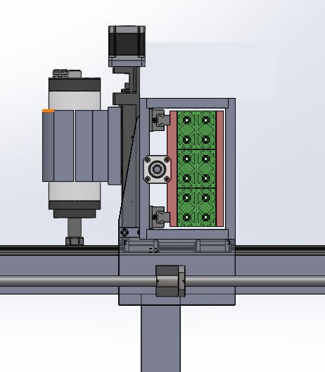

    Dave,
    See screen shot, i had 5 mins spare. The red and green sections would fix to your side plates and then to each other, the profile is 80x80, the plate is 20mm, note the datum for the rails on the front plate.

    How did you manage to edit that, Lee? Thank you! My only concern with that design is that I thought the rails were better off not being on there side?

    Quote Originally Posted by biketrialsdave View Post
    Hi mate, I pulled your image into the software I use for Web Dev then did some cut and paste magic with what was already there :).
    For these rails it's not as important, open round type bearings, then yes that would be correct. You could still mount them at the top and bottom, the choice is yours really but the objective is to get and keep the bearing units as close to the cutter as you can, that being said the the difference here would probably be negligible. I did a few version's of the mock up and one had the rails as suggested, if you prefer that design add plates to the top and bottom, as well as the back, I forgot to say that the back plate didn't need to be 20 mil though, also going with the top/bottom arrangement also means that the spindle plate/assembly stands further away from the bearings due to the lead screw interference with the ali profile.
