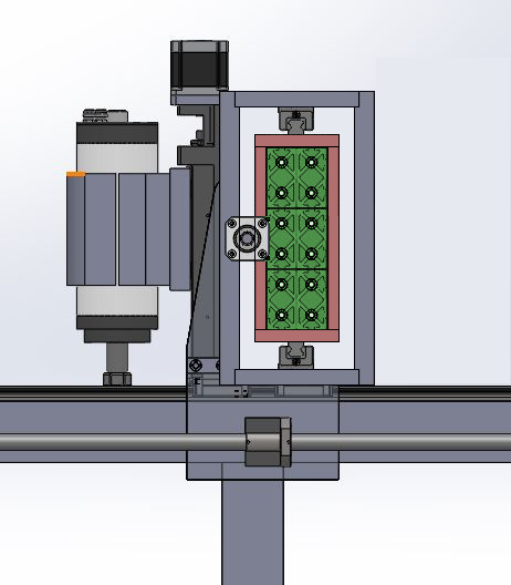

    Dave slapped this together for you quickly so you can see approximately what you may end up with, without needing to get down and dirty in CAD.
    Nothing is to scale obviously as it is just a drawing, note the X Axis screw mount position and that it would probably need moving back (away from spindle) to allow for clearance of the nut and mount (at the spindle plate), side plates would need to be bigger and other plates also bigger, bigger side plates are not a bad thing outside of additional cost because you really don’t want to go any less then 2-250mm centres for your rail bearings, both designs pretty much force you in that direction anyway so I didn’t mention it before but I thought that was a little bit ignorant of me, so here it is.
    You could close things up with datum’s and pockets for the rails and bearings and so on, keep an eye on the proportions as well, if you look at the original image I’m working from, the gantry looks small next to the spindle, if something looks small, it probably is...resize to match the proportions if you can.
    Also, others will probably say it’s not as important as getting other things right, and they are right but try and keep everything lined up and parallel, so your rails, lead screw and nuts. On the Y Axis (bed) the nut could be moved back towards the spindle in my previous image, vertically aligning it with the rails and lead screw, the middle of that plate “looks” nice but would it be better for the loads, if they are all inline?, they all come together to work as one.

  2. #72
    No need for that box design around gantry it add's very little but expense and more potential for binding. Also with this design the ballnut won't fit between the Z axis backplate and gantry. Those wide top n bottom plates with rails sat back just make long levers acting upon the bearings which will could cause binding.!! . . . . Not a design I'd go for.!
    Your design in post #67 will be ok. Don't waste money or time on the box around gantry setup no point or bennifit IMO unless bracing sides.!

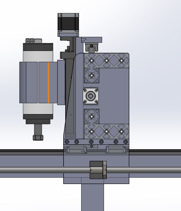

    Not much progress but changed the "L" shape on the gantry as JAZZ suggested. I'm now using 2 pieces of 80x120 and 2 pieces of 40x40 (mainly for filling the gap). This used to be 60x30 but thought I better bulk it up. Also the height (total height 350mm) and width (now 175mm) of the gantry side plates has increased a little to accommodate. Still undecided with what to do at the back of the gantry... I need to leave enough room to mount the motor on the inside (using pulleys).

  5. #75
    Ahhhh! really not sure which direction to go with the gantry design. It just does't look right now. Maybe I should mount the motor on the outside of the plate and the fixed (FK12) ballscrew mount on the inside of the gantry plate? (I.e. direct connection, no pulley).

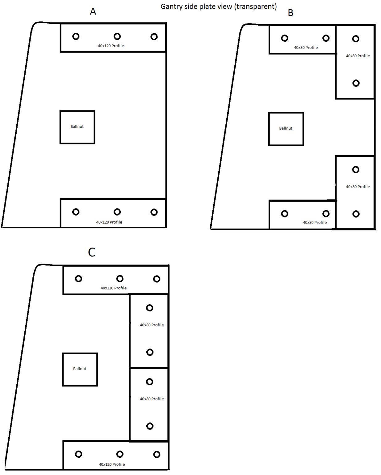

    Here are some options for the gantry..really don't know which route to go down now...Option A would allow an internally mounted motor (without increasing the side plate width). However I am also leaning towards option B. No matter which option I go with I still need to do something about the big gap where swarf could get to the ballscrew.

  8. #78
    Option A isn't going to be very strong, it has almost no vertical bracing. Essentially all the stiffness would come from the bolts through the side plates into the profile.
    Option B is ok but Option C is going to be a bit stronger. If you want the space internally to mount the stepper then you could go with option A but put a 10 or 15mm plate across the back (I assume the sloped side is the front). You should really have a look through some of Jazz's threads if you want to see a good design that keeps everything internal, the design I'm thinking of has a 20mm plate a the front of the gantry with a slot machined out of it for the screw connection. It served as inspiration for my design.
    If you want to do a quick experiment get a couple of lengths of 2x4 timber and nail them to some ply in roughly the design of option A, it'll take 5 minutes to build and you'll immediately see why it won't work as a gantry as it'll wobble around like a jelly. Grab yourself a bit of hardboard and nail it across the back, you could probably stand on it them.
