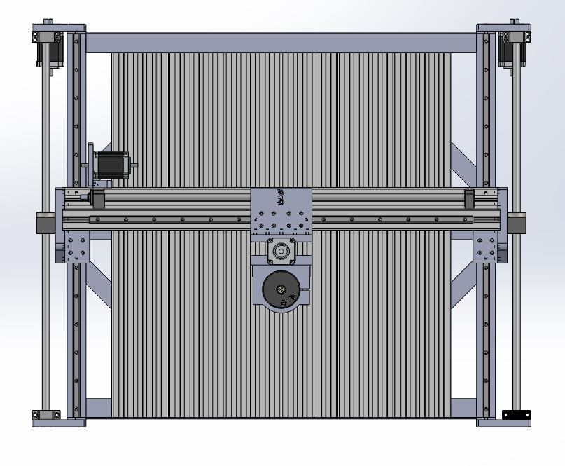

  6. #106
    I think the end is nearly in sight!!
    All steel plate is currently 3mm ("Y axis "end stops" and end plate attaching bed), should I make this thicker? Will there be any problems welding it to 3mm thick box section? I have a friend who works at a laser cutting place so I'm hoping to get those pieces cut there.

  7. #107
    Any comments on the above would be appreciated =) I think I need to start looking at places to get the aluminium milled soon!
    I've been a bit distracted with designing my own stepper drivers but going to put that to the side until I have the mechanical design all done.

  8. #108
    I think it would be better to extend the Z axis rear plate to meet up with the bottom plate, like this; it's not shown on this photo but my ball nut fits on the inside of that plate.
    3mm plate is too thin I reckon, I used 10mm flat bar for brackets, maybe 6mm would do, see what others say about it.
  9. #109
    Thanks for the input Eddy!
    Well it's been a long time since my last post and since then there have been some large changes... Now, I am fully awaiting the groans and face palms when I say this....
    I have decided to return to using aluminium profile for the frame. The reasons being:
    1) My welding skills are not quite there. They aren't bad but I envisage a lot of trouble trying to get things square and aligned correctly.
    2) I now have free access to a water jet which I plan to cut beefy steel brackets from to connect the profile together with.
    3) I have re-evaluated what I will mainly be realistically cutting and steel may be OTT!
    Anyway, enough excuses. Here's the latest design. I would really like to get the ball rolling with the custom aluminium parts. Am I best posting on the job request page and going from there?
