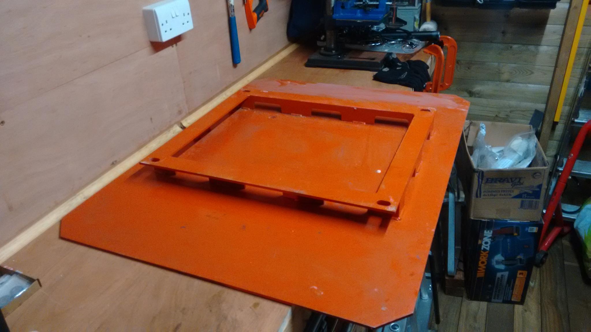

I really need to pick this project back up! Been having some thoughts recently and have come to the realisation that what I really need is a machine capable of cutting aluminium more than anything else. I'd really like to mill enclosures for my many electronics projects. Perhaps I need a re-think on the complete design!
22-10-2015 #2
The design you had wasn't too far away from cutting aluminium. It could benefit from a better/stronger base and the the linear stage for the Z axis isn't really up to aluminium but the general layout of high sides with gantry sat on rails is perfect for aluminium. Gantry design is nice and strong enough for aluminium.
If you sat that lot on nice piece of machine tooling plate or better still Granite base the frame would be sound for aluminum. Ditch the linear stage and put a conventional Z axis with decent rails etc and your sorted.

Some encouraging words there, thanks Jazz! When you say "sit the lot on machine tooling plate or granite..." which bit are you referring to?
