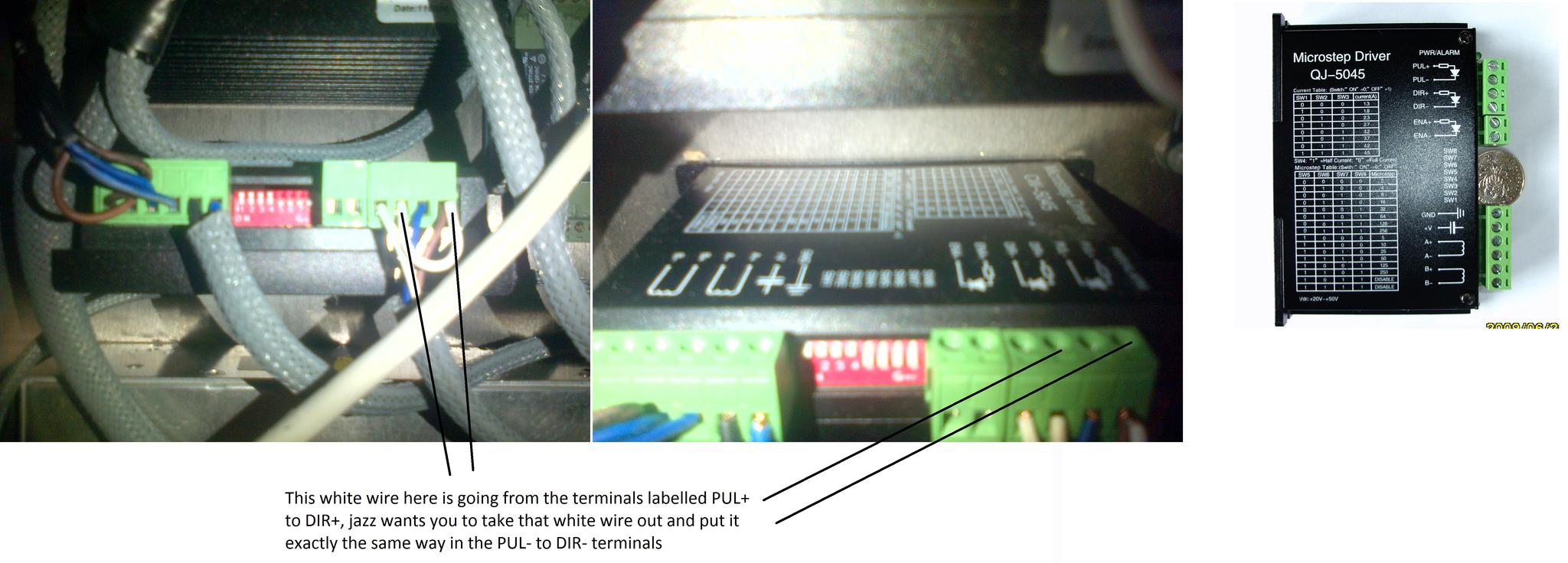

    Also there is nothing connected to the 'enable' terminals?
  2. #32
    yes ill take terminal covers off , the x any y motors are bigger than the z, i first got it with all the same motors , and sthing in the control unit arced out on the ox , so when i tok it back he up graded the the drivers ect and changed the 2 motors ,
  3. #33
    hold fire.. i'm gonna draw you what jazz is on about.. it's a really simple fix for you trust me
  4. #34
    pul+ dir neg
  5. #35

  6. #36
    wrong pul + dir +
  7. #37
    i hope you can read this as i've had to compress it

  8. #38
    Better details in the manual here
    Stepper Motor Driver 4.5A, 50V CNC Microstepping
  9. #39
    so just moving both ends of the link wire to the left one terminal ?
  10. #40
    Quote Originally Posted by handyoodman03 View Post
    wrong pul + dir +
    Ok really this needs checking all the way back to the breakout board (Board with cable to parallel port)
    EDIT: Forget what I said after 2epoz posted that link and seeing the breakout board then it's wired correct for that board.
    Going to PM you my phone number so we can chat sometime because without all the details then things could go wrong and easily blow a drive.
    Shouldn't be difficult to sort but it does need all wires checking from the beginning and trying to do this via forum is asking for trouble.
