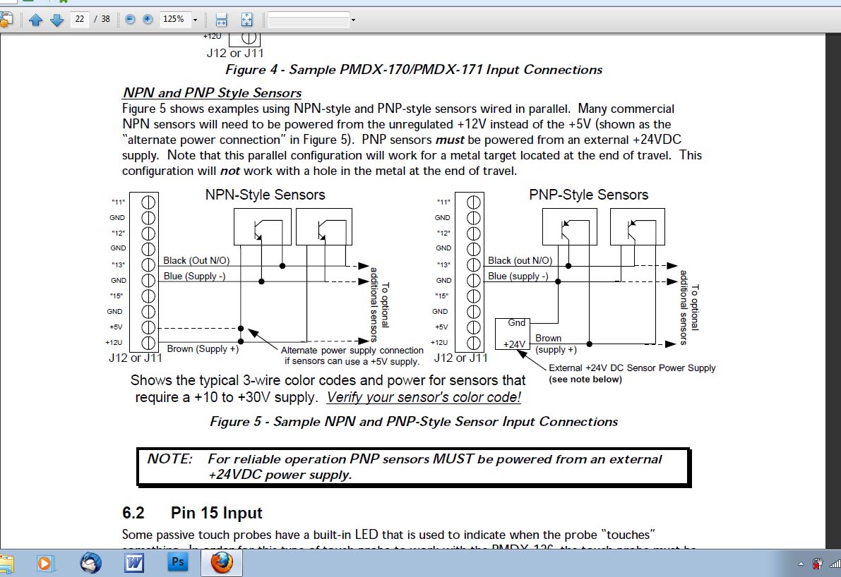

    Missed this but it's easy fixed just set the Home input to Active low and it will see the signal when it goes low IE: The switch opens.
    Still wouldn't work for homing ;-)
    Wiring three to the same pin, unless you can make sure 2 are triggered (i.e switched open circuit) while you home the third one, it's not going to work.
    See what you mean and didn't give it a lot of thought plus I've Never used these type Switches so won't argue but I've just been looking thru PMDX126 manual and they use them wired in parallel on a single Pin so wouldn't be so sure.?

    That's because the sensors in that diagram have a NO output.
    Ah I didn't realise these where NC switches. . . Makes sense now.!! . . . Really should start reading the threads more often.!
    (To be honest didn't even knew Proximity switches add NC - NO option never used them or thought about it. Thought they just sensed magnetic fields but on reflection it's obvious it's just an electrical circuit so could have and would need to both options to work has switches. . . Doh.!!)
