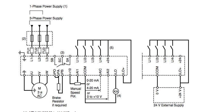

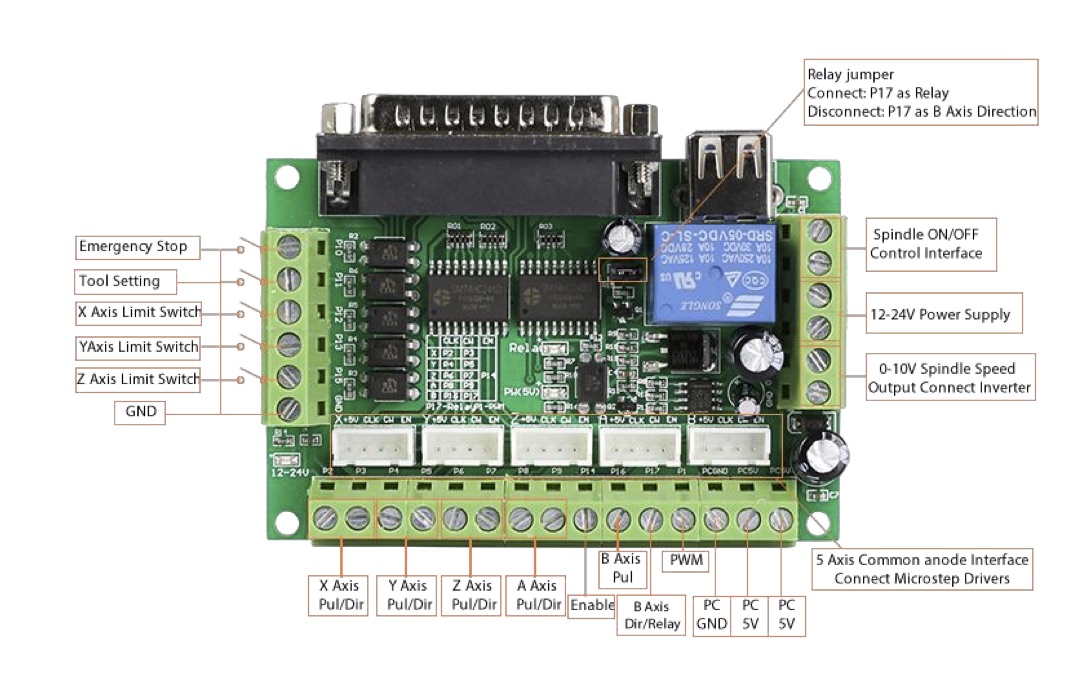

    I'm having some difficulty getting my head round how to connect my BOB to a nos Altivar 18 inverter. I can get the BOB to do the switching functions ie run, reverse etc, but I can't work out how to get it to control the speed. I think I have Mach3 correctly configured to the BOB, but I'm unsure how to connect for speed control.
    Here's the BOB I have:
    And this is the Altivar 18 wiring diagram:
    I'm guessing that "0-10 Spindle Speed Output", labelled on the board as gnd and 10v, should connect to "com" and "AI2" but this doesn't work. What am I missing?

    I know nothing about that inverter, but for my Chinese inverter I had to set parameters to accept a 0-10V input (rather than front-panel controls). But, yes, the idea is to connect the 0-10V output (and ground) to the COM/A12 on the inverter.
    Quote Originally Posted by Agathon View Post
    You are correct with wiring Gnd to Com 10v to AI2.
    Can you control the speed from the front panel of the VFD.? . . . . If yes then you need to change parameter for Frequency Control to external source. The default is nearly always front panel.
    Thanks for all the replies. The inverter doesn't have speed control from the front panel. According to the manual AIC and AI2 are already configured and certainly if I connect a 1.5v battery between com and AI2 the inverter runs at about 15% as one might expect. If connect directly between +10 and AI2 the inverter runs at full speed, again as expected. So no problem with the inverter configuration.
    Having played around with Mach3 and thought more about this two things occur to me:
    1. I can get Mach3 to switch the spindle relay on, but the spindle DRO does not display an RPM and altering the speed doesn't alter any of the numbers from 0. Surely, even with nothing connected it should show values if it is generating pulses?
    2. The inverter is looking for 0-10v between com and AI2, but where does the BOB get 10v from if it only has a 5v power supply? Do I need the 12-24v supply connected? I can take 24v from the inverter.
    OK. Just connected up the 24v from the inverter to the 12-24v input on the BOB and punching in a speed on the SDRO makes the inverter run. However, at 100% it's only giving 89hz instead of 100hz and it goes up slightly if I touch the 10v output with a screwdriver or meter probe - wierd. I'm getting around 9v across 10v and gnd.
    Maybe I need to use a separate 12-24v supply to the BOB.
