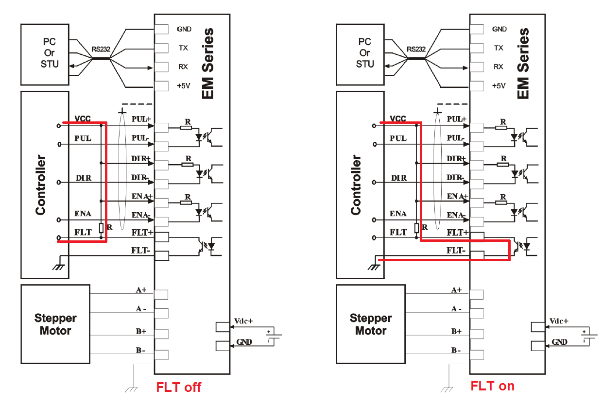

    The Fault ouput is Open Collector, so provided there's not an issue with wires being connected wrongly, then you can connect it directly.
    If noise is an issue, or the possibility of wires being connected wrongly, then having an opto would likely be beneficial.
  2. The Fault output on the EM806 (i guess that's what you mean by the Alarm output) is a floating optoisolated transistor. You could do it two ways:
    1. Flt+ to PIC Vcc, Flt- to the input pin and a 1k resistor from input to PIC ground. Input will go low on fault; or
    2. Flt+ to PIC input, Flt- to PIC ground, 4k7 resistor from PIC Input to PIC VCC. Input goes high on fault.

    Looking at the diagram in the manual again, I thought that if I use R = 4.7k, the PIC pin will see 5V when the FLT output is disabled, and 0V when the FLT output is enabled. With nothing passing through the FLT optotransistor in the EM806 ie. with no fault, the PIC pin should see 5VDC on the input, if the FLT optotransistor is enabled, it would pass current down to 0VDC, thus bringing the PIC pin down to 0VDC. Or am I missing something?
    Regards,
    T.

    That'll work fine.

    That was my option 2 and will work fine, but if you read page 3 of the manual you'll see it says that the output is low impedance in normal operation and goes high when there's a fault, i.e. the logic is reversed. The reason for this is if you put the pullup at the controller end and the cable gets broken or disconnected you get a fault condition.
    @m_c you could use internal weak pull_up but needs to be turned on in s/w and is only 10k so more susceptible to noise in this environment. Indeed on reflection I'd probably use a 1k external pull_up for just that reason.

    This is just an FYI how mine worked. I have 2 motors on one axis and I didn't want the driver to sense something that would put it in to alarm and stop one motor while the other kept going. Hope that makes sense. I wanted that if one driver went into alarm that the others would stop.
    Turned out really simple. In the software set the alarm to go "LOW". Run the E-Stop though as many switches as you need then end at the "ALM +" of the first drive then "ALM -" to the "ALM +" of the next and so on. After the last drive "ALM -" goes back to the control board "GND" and that's it. Job done. If any drive goes into alarm, the circuit is broken and E-Stop is activated.
