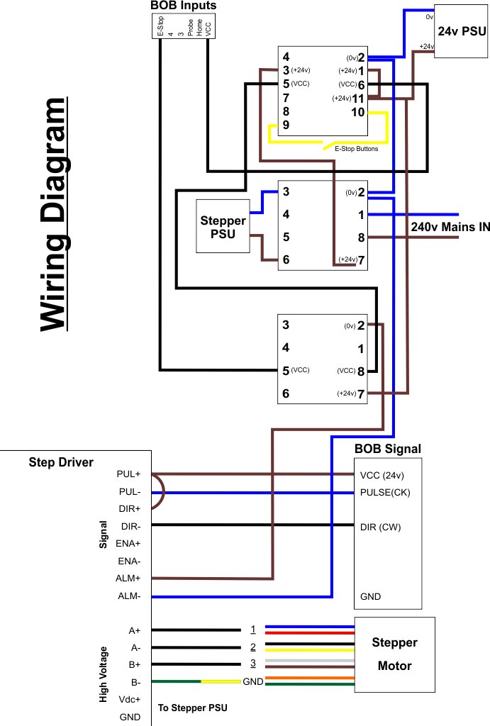

    I'm wanting to double check I've got this right before wiring it up.
    The AM882 has an alarm signal output that triggers when the driver goes into a fault state. The object here is I want that signal to be picked up on one of the BOB inputs so Mach can trigger an estop and halt the other drivers.
    Here's the an image of what Leadshine suggests in the manual.
    And here's a crude wiring drawing that I've knocked up to stick on the inside of the control box for quick reference (please ignore the extra details such as the relays and stepper wiring)
    Will that work?
    Loose the brown link wire to alarm.
    you are feeding it V+ from this and then to ground. when it triggers it will be a dead short.
    You want e stop to go to one alarm terminal then to ground.
    Basically alarm is in series with the estop

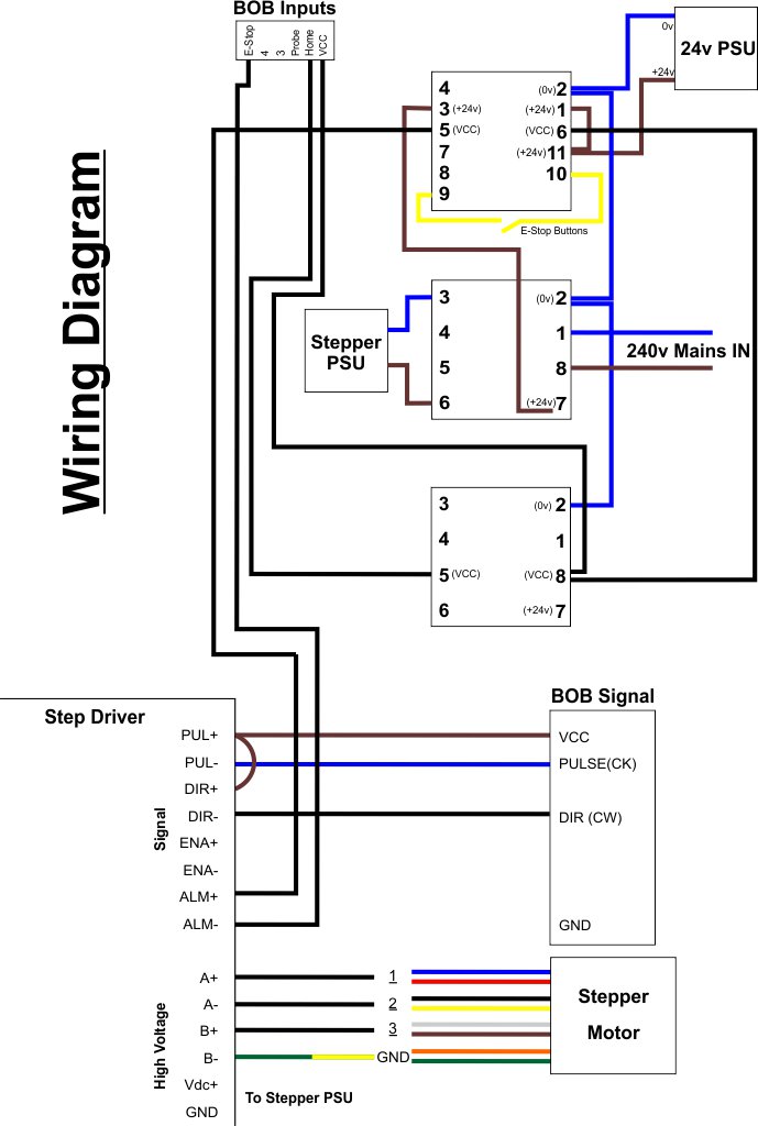

    Thanks John.
    Not sure I completely understand but had a go at updating.
    Is this what you were getting at?
    It should be noted that the Alarm+ outputs 30v 100mA and Alarm- is 0v so I don't think I've done this right.

    Quote Originally Posted by Shinobiwan View Post
    In which case feed the E Stop circuit through a set of relay NC contacts and the alarm + and - to that relay coil.
    Connect all 3 drivers to the same coil and then it doesn't matter which one trips.
    Driver alarms, switches the relay and breaks the E Stop. - Simples.
    John S -

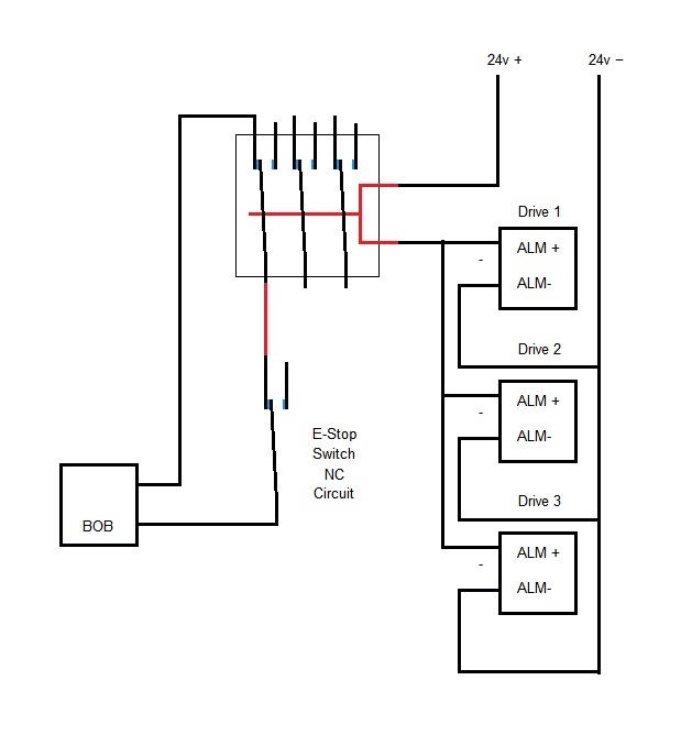

    Lives in East Lothian, United Kingdom. Last Activity: 4 Hours Ago Forum Superstar, has done so much to help others, they deserve a medal. Has a total post count of 2,957. Received thanks 366 times, giving thanks to others 8 times.
    The alarm terminals don't output any power. It's an open collector output capable of switching 100mA at 30V.
    So you still need a relay as per John's suggestion to connect into to the Estop circuit, but you need to provide the power to the relay, then connect the relay to ground via the alarm terminals. You could also have the relay in circuit after the alarm terminals, but it's usually better practice to switch the ground side in electronics.

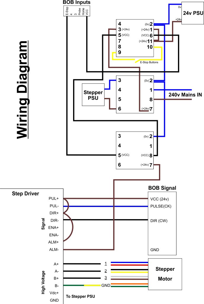

    Thanks guy, I think I'm starting to understand now.
    Based on what's been I've changed things around and attached the updated diagram.
    Is this looking OK now?
    No, I'm thinking that's still wrong, I suspect one of them will draw the circuit by tomorrow but if not I will, but I wont be home from work till the morning and not up till 2pm so we will have to see. Rick
