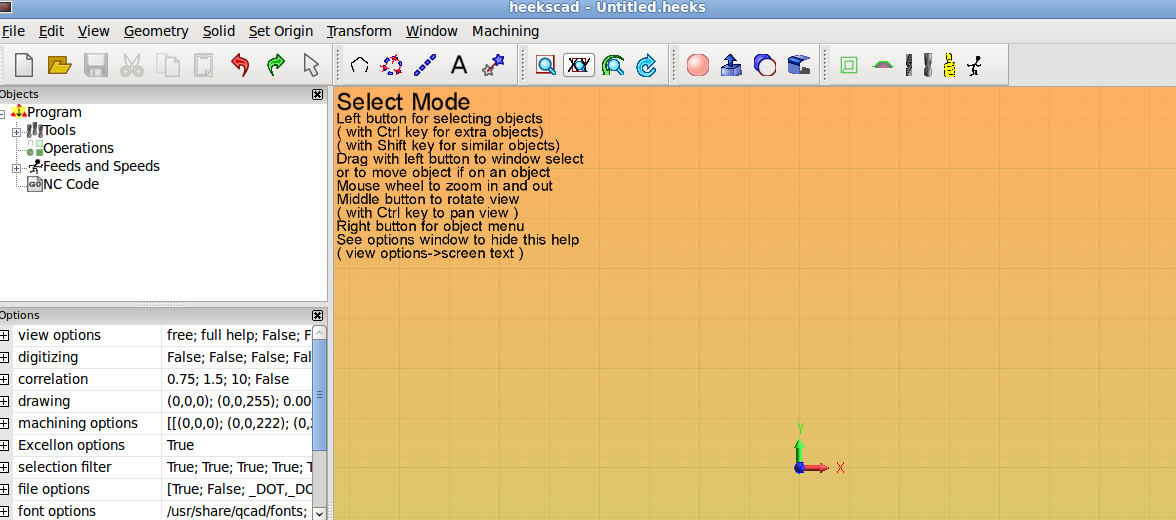

    By default, it seems G0 -button (Postprocess) is missing (due to a bug) from Heekscad.

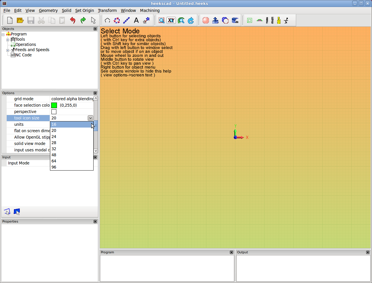

    # To find that missing G0 -button, change from options ---> tool icon size to smaller (eg. 16) and then larger again

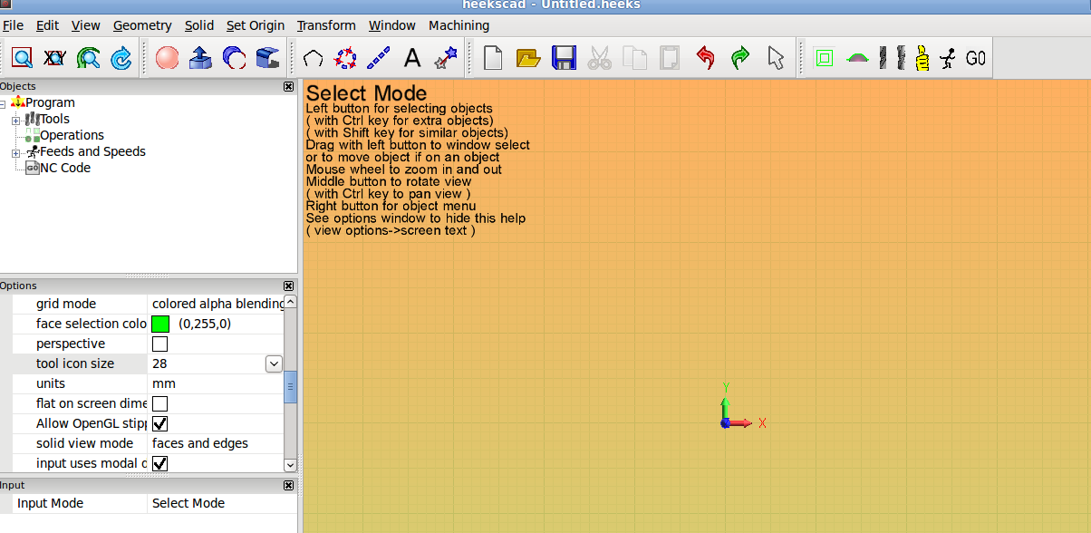

    # ...and the button appears on top right hand corner of toolbar:
