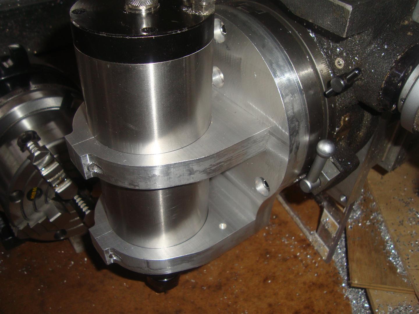

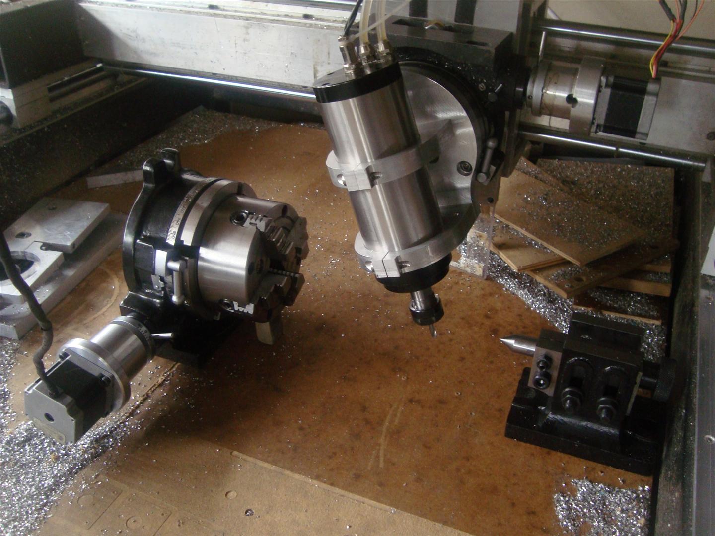

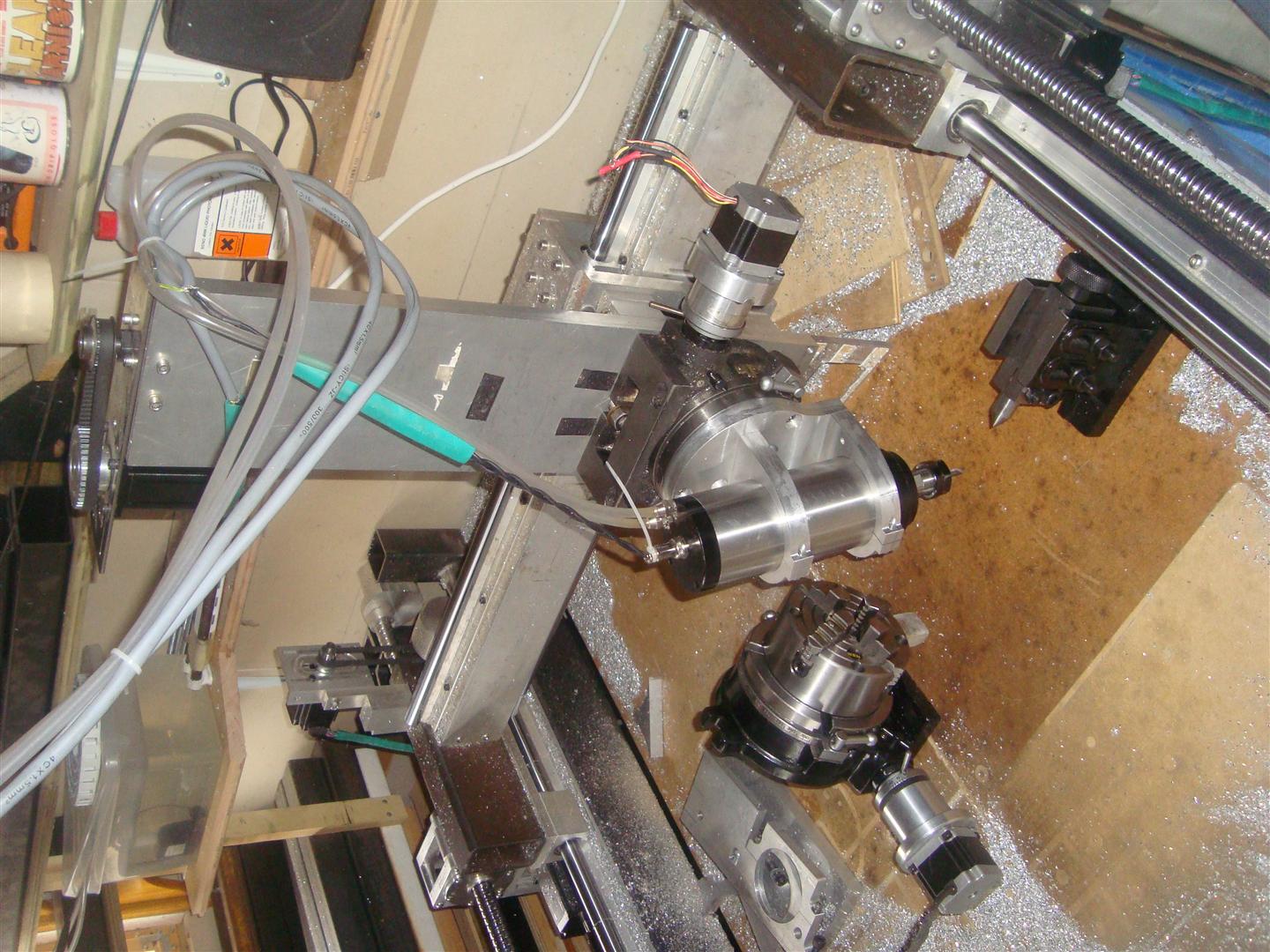

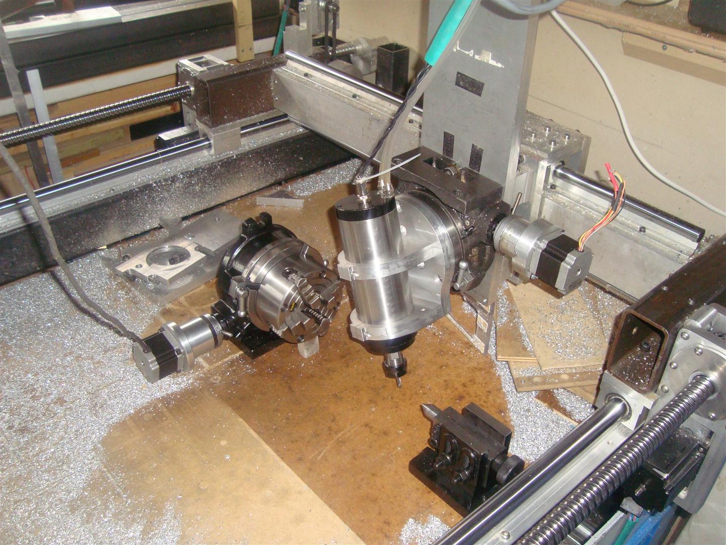

    Albeit only momentarily, I made a new spindle mount to set my machine up for 5-axis:

    But I cant think of anything to make with it :lol:
    Clearly I need to drop the bed down (which is fine, it's adjustible) to get enough clearance.
    I can also mount both rotary tables and the spindle on the Z-axis to get the spindle rotating in XYZBC configuration. May need some reinforcement. The reason I made my Z-axis have 400mm of travel is to allow sufficient clearance for future 5-axis machining with that set-up.
    Unfortunately there's quite a lot of backlash in the rotary tables, which is difficult to eliminate, so it's probably only going to be useful for woods and plastics. Ideally I should make a BC mount for the spindle using harmonic drives (too expensive), or double worm wheels preloaded (generally annoying), or timing belts (struggling to find info on how much they will stretch). But is it really worth it?

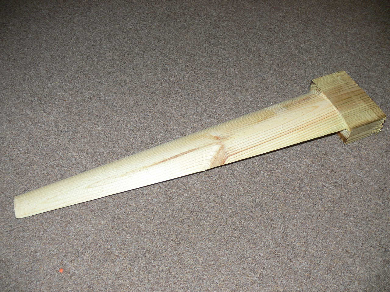

    Quite recently I've made one wind turbine blade (580x120mm)

    Rough with end mill + finish with ball-end
    I think it could be faster with 4th or 5th axis when I could do finish cut with an end mill
    Ahh nice one!

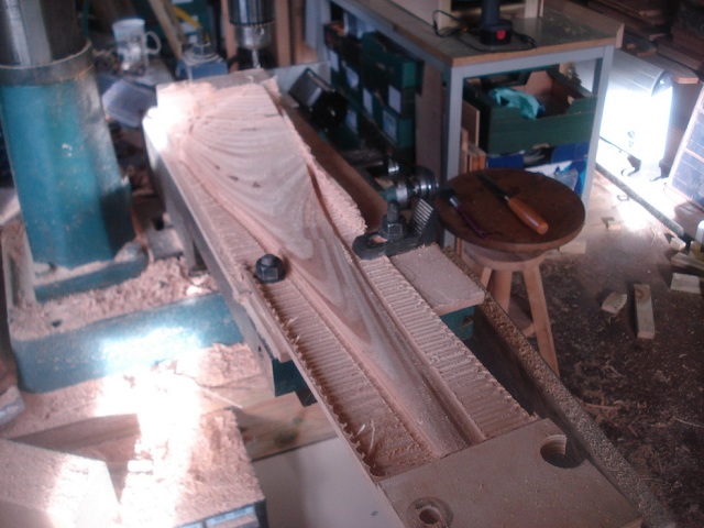

    Perhaps the photo is deceiving me, but it looks like you have set the airfoil at the same angle along the whole length of the blade? It should be twisted ... look at the oncoming wind and the speed of each point, radially, on the blade as vectors and the angle between those vectors plus the angle of attack is the angle you set each cross section at. I also offsetted the leading edge to obtain a taper, so the chord at the end of the blade is centered about the root. This was my first attempt before I made the CNC router, so done on the mill in 4 operations, plywood:

    Then I did an MDF mould about the same length as yours and made them with fiberglass...which you've already seen. It's so much better, try it!

    4 axis would make it faster as you could use the side or, with 5 axis, the end of an endmill for the finishing pass. But I'm not sure it's really worth it? Would look good though!
    Since I'm going to make moulds for the blades, not the actual blade, the surface is concave so I would still have to use a ball-nose cutter. 4/5 axis allows the cutter to be kept at a constant angle to the surface, which should allow it to cut faster as it avoids using the centre of the ball nose cutter.
    It's barely visible, but it is twisted. Some time ago I was messing with 3d software and first thing that came to my mind was to make wind turbine blade. I left memory stick in a workshop with file, but as far as I remember there is 5 degr angle at the tip and 10degr at the root. Blade was designed to fit 120x45mm 650mm long leftover timber from Wickes I had.
