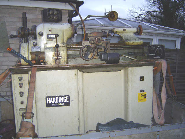

  4. Got my new toy :)
Name:	Hardinge HLV-H.jpg
    Wow now thats a project!
    Book me in for some ali stand off's !
  6. Book me in for some ali stand off's !
    Come back in August :)
    Actually it looks worse then it is. I won't be stripping it down completely (unless I find something very wrong) just cleaning off the congealed coolant and wire-brushing off the rust.
    The biggest pain (or expense) is that the four/or five change-wheel gears are missing. Even before I discovered this I had been thinking about an electronic leadscrew idea (i.e. using a servo motor to drive the lead screw phase locked to the spindle - like the latest/last model HLV's) to cut metric and english threads.
    Next job is getting the thing (it weighs the better part of 3/4 tonne) off the trailer and into the garage - Time to think like an Egyption.

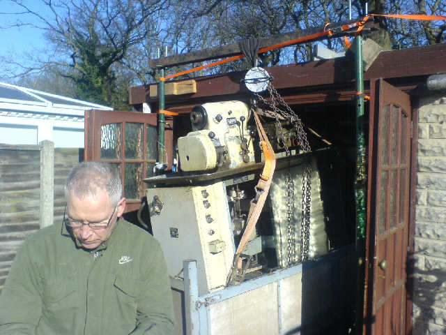

  10. Well, it's in the garage now...
    (BTW that's my older brother Fred lending some muscle and Acro-jacks)

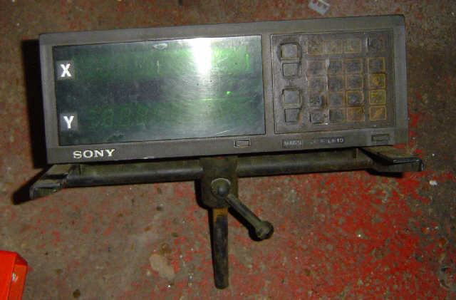

    Another request for info:
    Anyone have (or know of) a manual for a Sony Magnescale LH-10 DRO ?
    Or even just a clear picture of the front panel? I'm trying to work out what the buttons do, but since I can't read the legends it almost impossible. I'll make a new overlay for the buttons once I've worked out what they do.
Name:	Hang um high tn.jpg
ID:	214   Click image for larger version.
