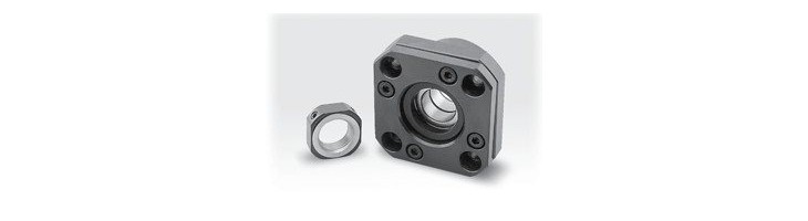

    This is a quick mock up to mount my thrust bearings. This will fix in place the normally floating end, this means the spring in the motor will soak up the expansion of the screw and the motor side will effectively become the floating end, if it need more I can use a oldham coupler.
    Il need another 4 holes that will be tapped to fix the bearing to the mount which will be made of aluminium.

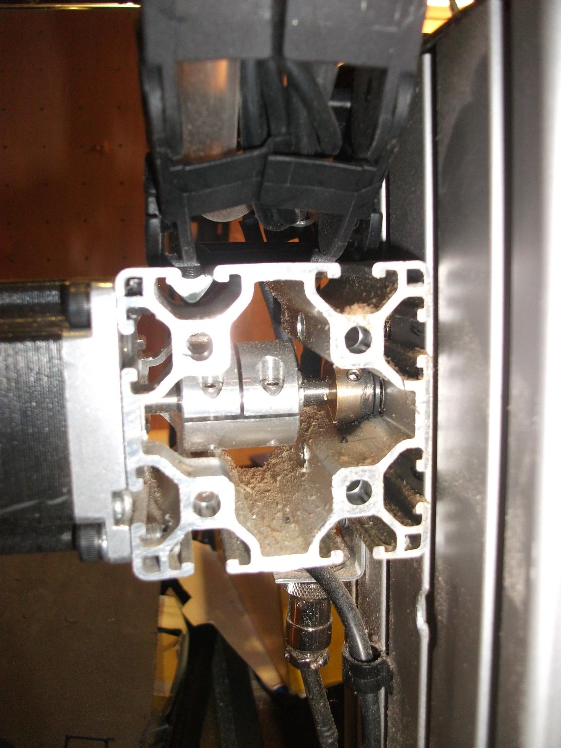

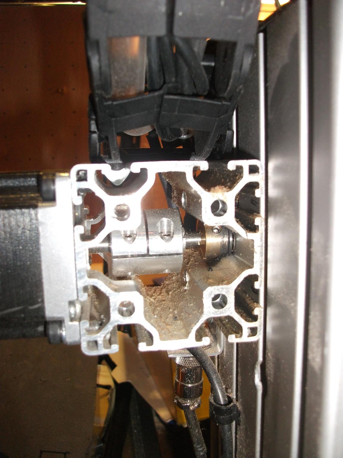

    I had the problem of the floating acme screw and I put in a small thrust bearing from ARC Euro held against the motor mount extrusion by a collar with a grub screw to remove the end float on the screw. I did similar on the X axis, but the Z axis was a slightly different bodge as I needed to prevent it pushing upwards, so I put in a couple of thrust bearings to space it out (1 bearing and washers would have done !) and used the coupler to act as the retaining collar.
    The machine is now (just) adequate for hobby use.
