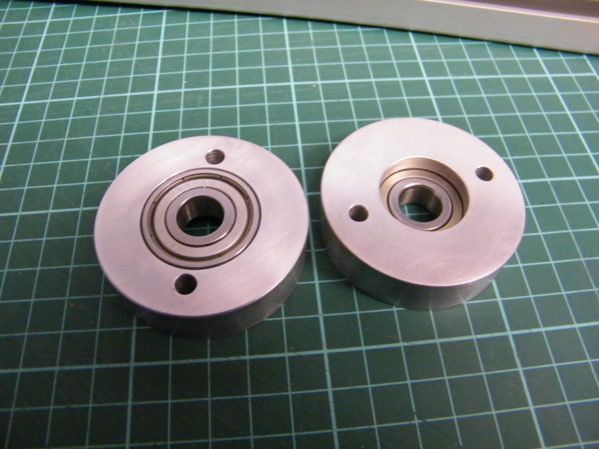

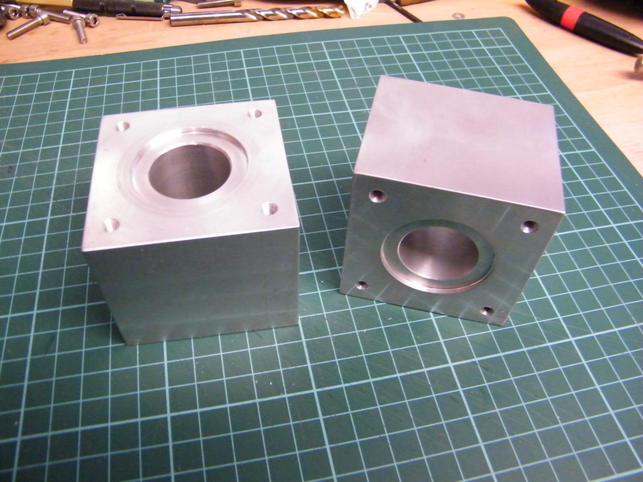

  9. #29
    Quote Originally Posted by Walterronny View Post
    Motor mounts (idk how they go mounted with the motors!)
    Walter,
    For your review, here is a very good way of designing/making motor mounts, they incorporate angular contact bearings so may save you some time at design and money on additional parts.
    Pictured is the face the motor will attach to, on the other side there is just a simple bore to recive the anguler contact bearings, on the second picture you can see an option for supporting your leadscrew (at the other end) with just normal radial bearings.
    Good luck with the build !
    .Me
ID:	8148   Click image for larger version.
  10. #30
    Hi, these looks really great!! and a bit expensive to me :D i think i even build my own mounts for motors with aluminium sheets welded.
    Thanks for your reply.
    Walter R.
