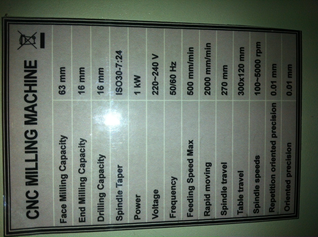

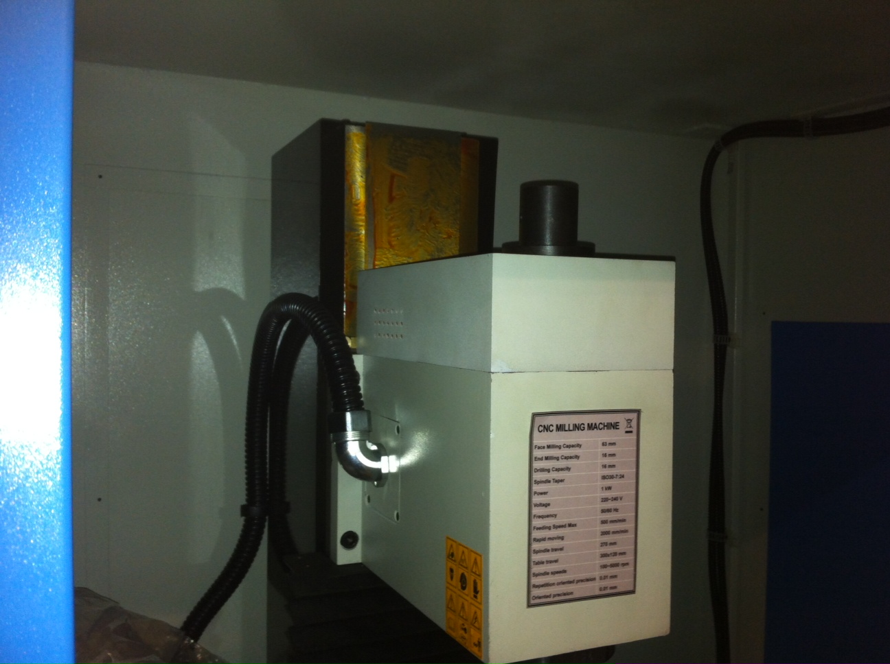

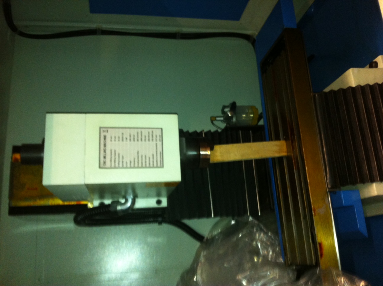

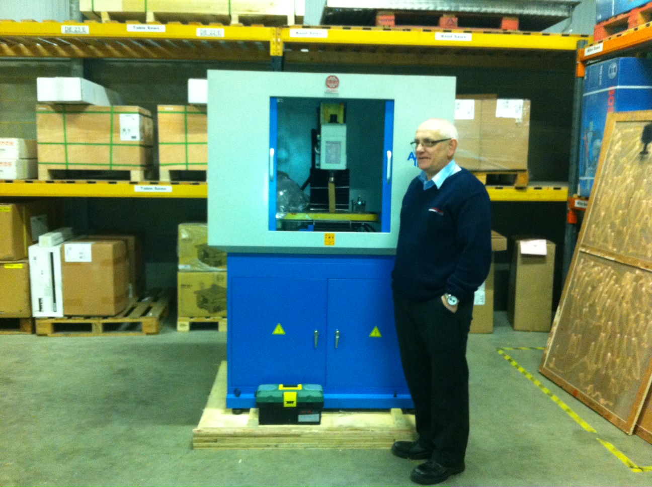

    I had a look at this last weekend the KX3S-SIEG the only downside for me is that there's no ATC Option and it doesn't come with the 4th axis although it's prewired for it......I got to say it was a tad bigger than I thought it was going to be and the quality looked pretty good the spindle post was approx' 4" Sq solid steel it was all rather substantial and the controller boards looked good quality too....but then I don't have any experience of these things......cost £6995 delivered the 4th axis adds another £900 but he said there'd be a deal on that (you bet there would be :) ) anyways I think I'm going to hang fire untill I find myself a secondhand Denford VMC 1300 with 4th Axis and ATC....thought I'd post up anyways

    dodgey geezer was the Axminster Sales chap..... :) very nice and not at all pushy didn't big it up more than what it was...thought I'd better get someone in the picture as a reference to how big it was......with the Denford I'd get it converted to run the mach 3 software the Sieg runs windows which is a plus

    P.S. Who's the dodgy geezer in photo 4? I can't say I'd buy a £7k mill off him
