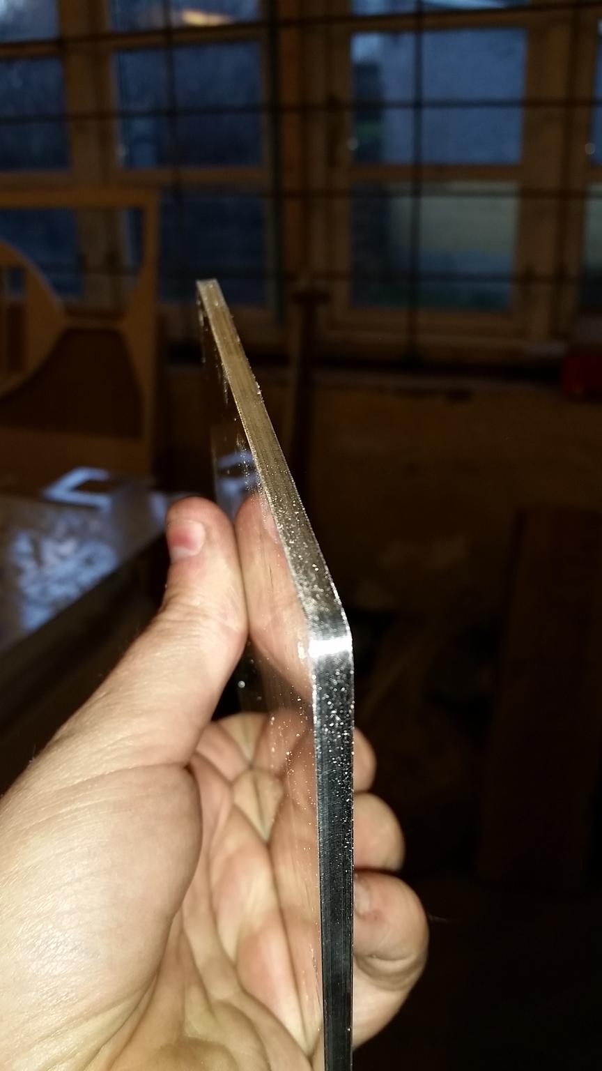

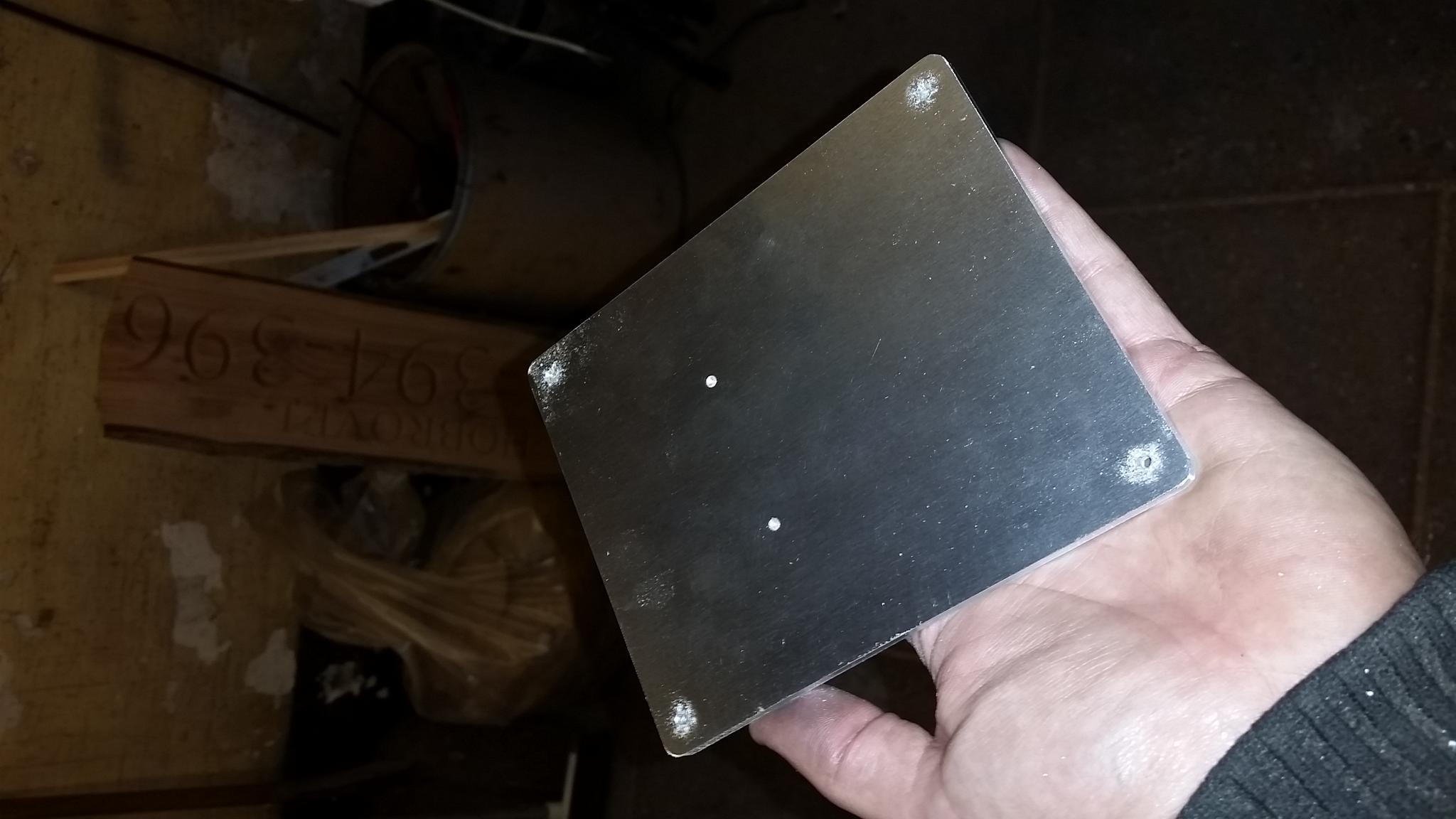

    Well, the machine is up and running as it should be. And I have already cut a few bits and pieces in Aluminum on it. Recently I cut 16 plates in 5mm aluminum sheet.. Ended up looking really good... They are 121x156mm and tolerances are within 1-2/10 of a millimeter. Not the best tolerances, but I only had a single flute 3.175mm cutter, so it came out as it came out.. But the finish was great...
