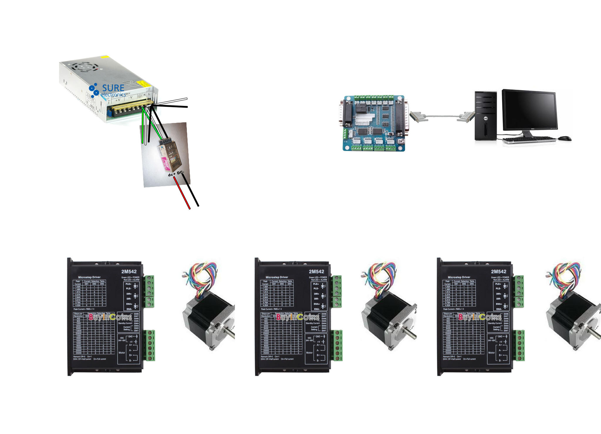

    Once again thanx for all your replies,
    I think I might get some new drivers, breakout board and power supply. I am a complete beginner but i will try and have a bash at it. I suspect i may get stuck so hope you guys can back me up.(as you have so far!!) in the worst case scenario I will bring it along to jhon or i2i if the offers are still there. so heres what im thinking of getting as jhon mentioned :
    CNC Micro-Stepping Stepper Motor Driver 2M542 Bi-polar 2phase 4.2A Switch | eBay
    5 Axis Breakout Board Interface FR Stepper Motor Driver | eBay
    also a 2 way male parallel port.
    also what voltage power supply would i need? I noticed on some videos there are 2 power supplies including a 5 volt one so would i need 1 or 2?
    thanx again

  9. #38
    Lives in East Lothian, United Kingdom. Last Activity: 23 Hours Ago Forum Superstar, has done so much to help others, they deserve a medal. Has a total post count of 2,992. Received thanks 376 times, giving thanks to others 9 times.
    They'll do.
    Power supply wise, take your pick. You can either build one yourself by buying a toiroid transformer, a bridge rectifier, and big capacitor(s), or look for one of the pre-built switched mode (rectangular metal box) ones that outputs around 48V. Either will work, and of the top of my head, if you were to use the 3 drives to their full capability, then a minimum of 6 amp output would be needed, but I'd doubt the motors will need that much.
    If you're doing a complete box, then you'll need things like connectors, switches, terminal blocks, and possibly a few indicator lamps. Also a good selection of cable will help.
    Control boxes aren't really a one-size fits all thing, as different people prefer different things and will do the same thing different ways, however for basics, you need to consider your options for the following main items-
    -E-stop system
    -Power Supply(s)
    -Motor Connections
    -Computer interface
    -Additional features (jog buttons, probe connections...etc)
    I've not got time right now to explain those items further, but if nobody else posts up, I'll expand on them later.
  10. #39
    scnc's Avatar
    Lives in walsall, United Kingdom. Last Activity: 30-04-2014 Has been a member for 9-10 years. Has a total post count of 29.
    Ok so my understanding so far apart from how to connect the motors to the drivers to the breakout boards is attached. please let me know how to add to it.Click image for larger version.
Name:	cnc controll box.jpg
  11. #40
    Quote Originally Posted by scnc View Post
    Here you go try this.
    The motor wire colours probably won't be correct and you'll need to test the wires to find the phases. Also it doesn't show fuses etc and you'll need to add some but should give you an idea of what wire goes where.!!
