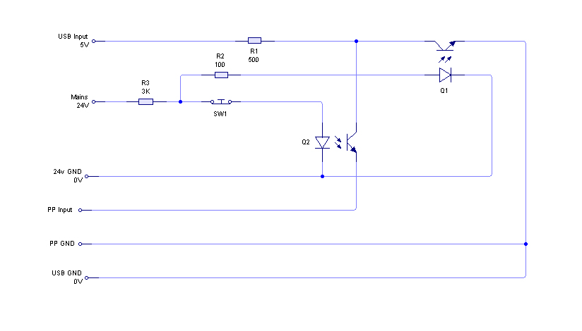

    5V signals can be susceptible to noise as Jonathan says, however provided you're sensible and don't do stupid things like run the signal cables next to power cables, most people don't have any issues.
    If you're using Mach, and looking for lots of inputs for non-critical stuff i.e. buttons to make things happen where a slight delay isn't likely to cause disaster, I'd look at getting a PoKeys - POKEYS IO DEVICES
    Things like limit and home switches are critical, and have to be directly connected to the controller to get reliable operation.

    You also indicate that you want to maximize your I/O capability and you have indicated all the switches are NC so why not put some or all of them in series? If you put all of them in series, you will use only one pin. I would also heed Jonathan's advice on level shifting as it will reduce potential noise problems.

    Unless your you plan on things like autotool changers or controlling many external devices then one PP is often enough by running limits and E-stop in series. After that then I'd look to the Pokeys device has it offers a cheap and simple why of doing it with massive amounts of inputs.
    Personally I only use 24V thru all my Limits and E-stop system to eliminate any chance of noise issues causing false triggers. This is done thru relays or dedicated safety relay which shut things down at source or kills power in a controlled manner with the 5V signal from PC just used to inform control software an E-stop has occurred.
    Hi everyone.

Name:	PP2 Input High Active.jpg
    To Jonathan. I've changed my design a little to incorporate 24v [Please see attached].
    I've been playing around in simulation with this, but when the switch goes LOW I'm still left with some residual voltage, will this still damage my card? I certainly don't want to risk blowing my card, or even worse my system!
    I'm not entirely sure I have the right values here either, just used trial and error until I ended up with a stable circuit..
    (I'm no electronics guru as you can probably tell!)
    I am still getting roughly 800mV on the PP pin.. Will this be a problem, is there another way I can do this so I get an absolute 0v here?
    Also missing caps etc here, any suggestions on values/configs?
