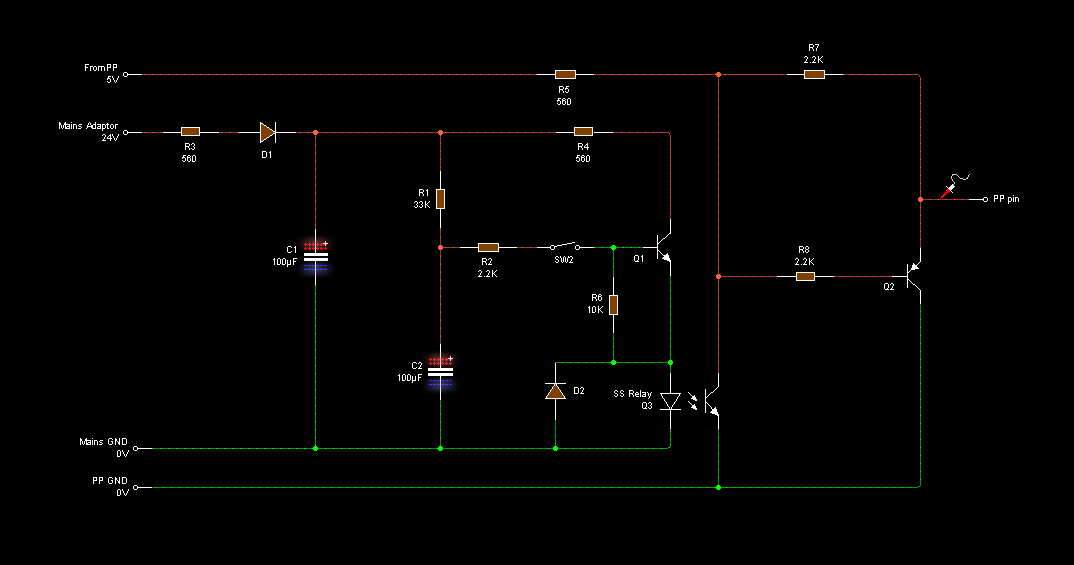

  8. #7
    Hi guys.
    Could someone please kindly check over my schematic to make sure I'm not making any obvious mistakes?
    I plan to run 24v from a mains adapter, and the 5v/GND is running from the PP.
    I decided to go for a good quality relay opposed to an opto simply because it makes more sense to me now to go this route.
    Thanks in advance!
Name:	BreakOutSchematic 02 SwitchO.jpg
  9. #8
    Lives in East Lothian, United Kingdom. Last Activity: 9 Hours Ago Forum Superstar, has done so much to help others, they deserve a medal. Has a total post count of 2,994. Received thanks 376 times, giving thanks to others 9 times.
    It maybe makes more sense to you, but an opto with a suitable resistor (and zener if you want some extra protection) is far simpler. You can also add a capacitor across the opto if you want a simple hardware debounce.
    But anyway, why D2? If it's a solid state relay, then you don't get any surges, so it's not doing anything.
    Shouldn't R6 be connected directly to ground for quicker switching?
    Fair enough a large capacitor over the input, but 100uF for C2 seems a bit excessive.
    In fact, shouldn't R6 be tied to gnd to provide the voltage divider along with R1 and R2 for Q1?
    It all seems a bit over complicated to me.

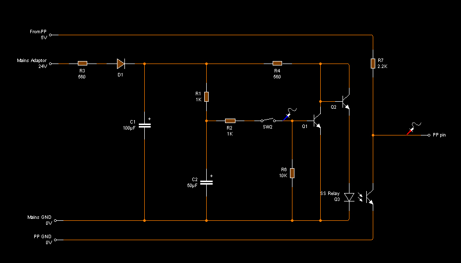

  10. #9
    Thanks MC..
    I was following a design for a relay originally which suggested the resistor R2 to be here..
    It was originally for a realy, which I switched for an opto/SSR.
    I've been working on this again today with a little help from another forum.
    Not sure what value I should change up in terms of C2, any suggestions? I've changed it to a 50 for now..
    This is the updated design (as of today..).
