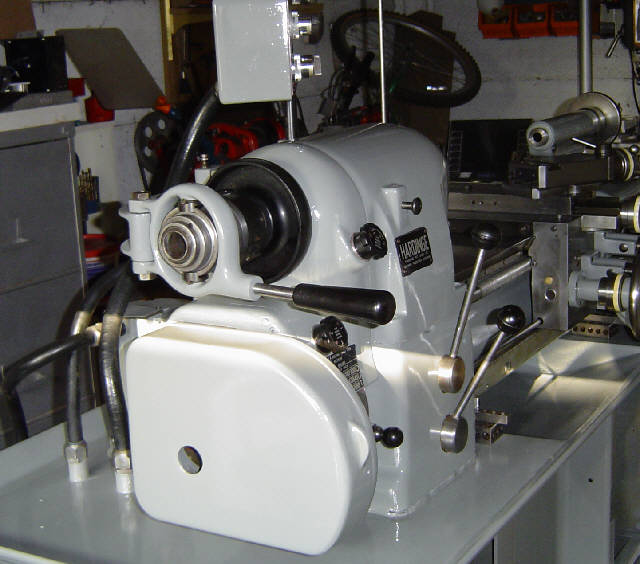

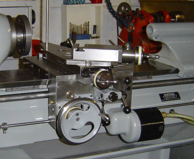

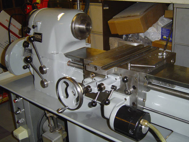

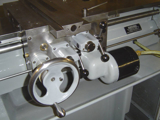

  1. Managed to assemble the apron today. It was a lot more work than I had thought, but got there in the end.
    I used Loctite 5922 to seal the apron to the carriage (looks and smells just like hermatite but is black instead of red), seems to work well; no oil leaks so far :)
    I have yet to find or make a core-plug to cover the carriage gear, but I have a novell idea based on the fact the hole is 1 1/8" - If it works, it'll raise a smile or two...

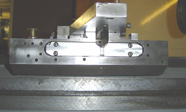

  2. Cleaned and mounted the cross slide and compound slides yesterday & today.
    Made a new cover for the coolant sump (the old one was missing) and primed a few parts for spraying tommorrow (if I get the time)

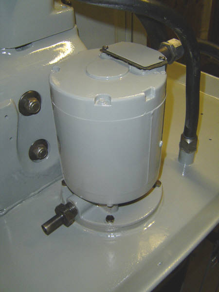

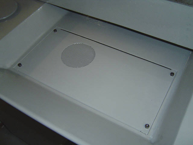

  3. Sprayed, assembled and fitted the Coolant pump (had to make a new filter from some purf sheet) .
    Sprayed and fitted the sump cover. The orignal one fitted to HLV's had a cover for the drain. I'm not sure if I'll bother with one, the holes in the drain are ~1/8" - I doubt I'll lose anything that small.

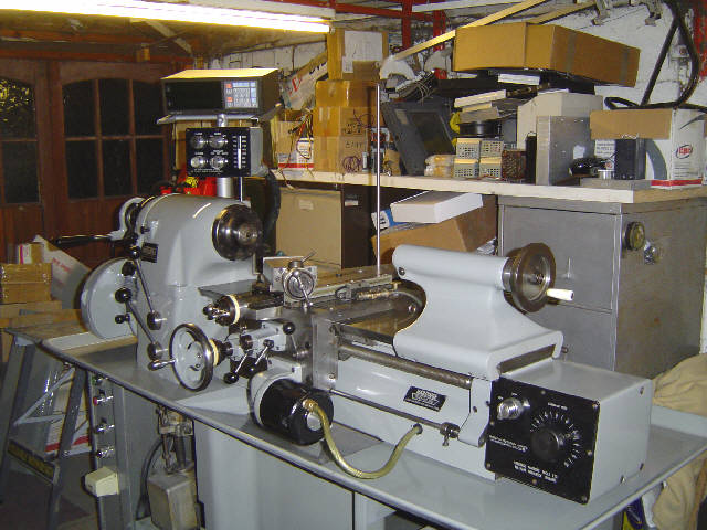

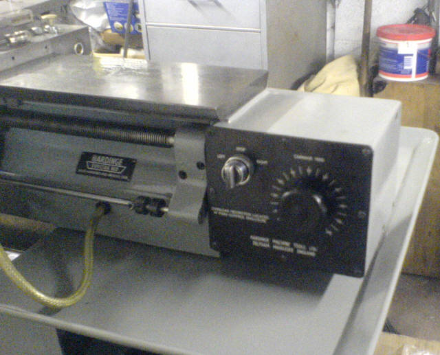

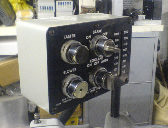

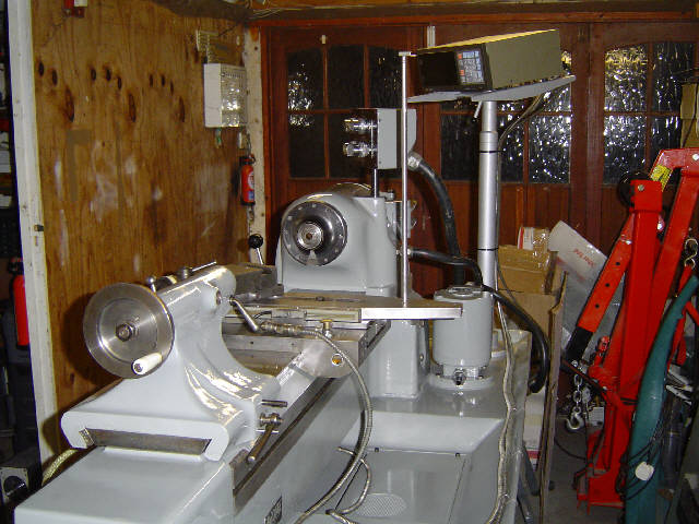

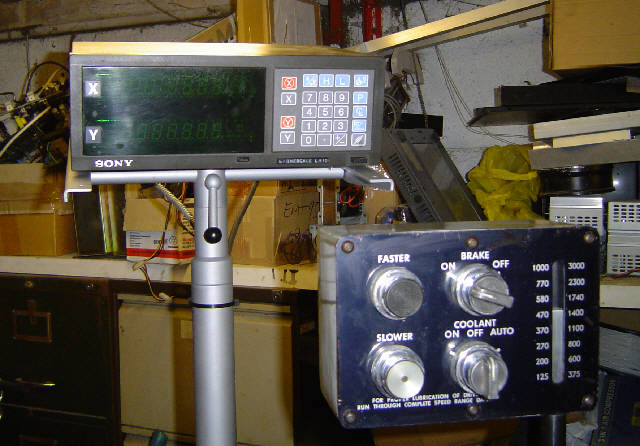

  9. I painted the control box and and (for the third time) the tail stock and power feed box. This time the paint looks OK :)

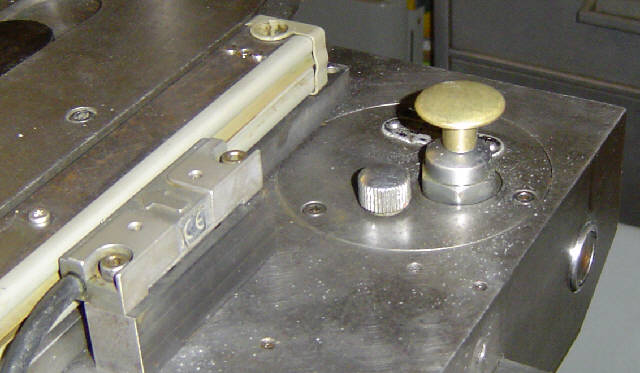

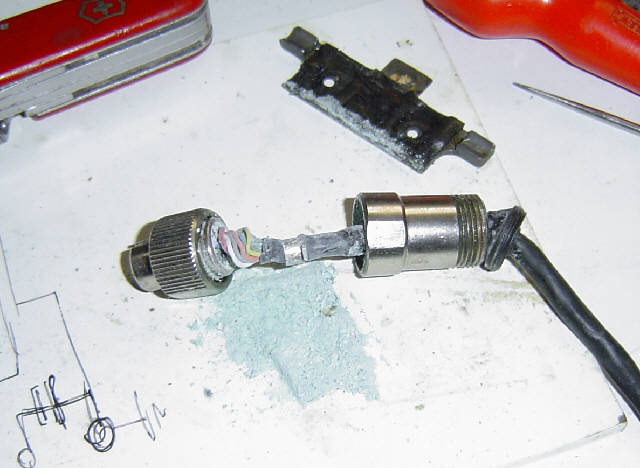

    I had time to test the DRO (having mounted the Cross slide scale) and much to my disappointment found a fault - It was counting to 0.0004" then displaying 'Error'. A quick email to Richard at Axis returned some basic ohm-meter test routines.
    After finding a small amount of corrosion in the scale-end connector I worked my up the lead to the 'water-proof' quick connect. It was solid with corrosion (see picture) I had to pick at it with a needle just to get the connector apart. The coolant has eaten the copper from the braided screen and a couple of the wires, leaving empty plastic sleeves ! I stripped back the cable to find it in the same condition, all but a inch or two from the scale end.
    I bodged the connector back together soldering the last two inches of cable to the pins of the plug. Now the scale is working again.
    Richard says Axis have spares, I am steeling my self for the price.
    Tomorrow, I'll reassemble the tail-stock and collect closer.
Name:	control panel painted.jpg
ID:	298   Click image for larger version.
Name:	Power feed box.jpg

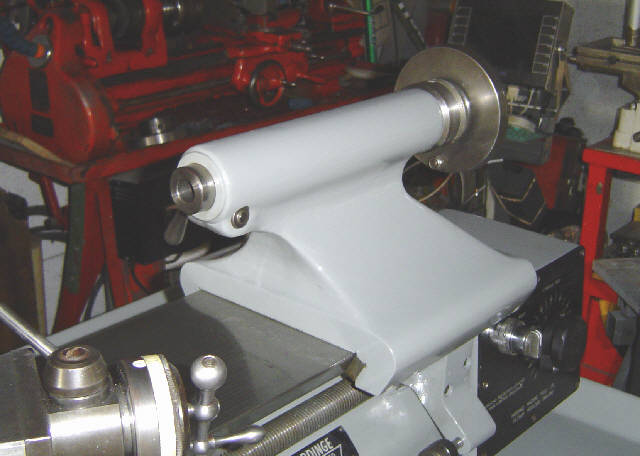

  10. Lovely day today, almost Spring like...:p
    Assembled and fitted the collet closer.
    Assembled and fitted the tailstock - Now I know why the power feed box is so massive; The tailstock is so heavy I had to rest it on the power feed box to be able to align it with the bed ('cos there's no way I could lift it at arm's length)
    I don't like the handle on the tail stock it's not a Hardinge wheel (it looks someone knocked it up in an afternoon). I doubt I'll get a proper replacement anytime soon' so I've been looking at the Myford spares that RDG are selling. I think the largest one will do the job with only a small amount of re-jigging - It'll look a lot better then the current one.
    Repainted the DRO mount. It looked heavy in matt black so I thought i'd try silver instead (it's OK I suppose )
    Tomorrow I'll have a go at mounting the carriage DRO scale on the front of the bed.
