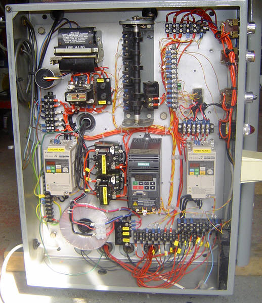

  2. Just fitted the rewired control panel. :)
    The control logic is just a bird's nest ATM while I test it, but it seems to work as advertised.
    The photo shows the bird-nest logic and temporary 24v PSU (bottom right) I'll knock up a PCB for the two relays and PSU. I'll add a low voltage (50vac) transformer to power the work light and use (half) to power the logic.
    All I have to do now is convert the speed adjust motor to 240v...

  4. I don't know what convinced me that the speed jack motor was dual voltage (I thought it would be American, but it was made in Swansea) but, it ain't, and there's no easy way to convert it (I was prepared to carve into the insulation to find the star point but thought better of it when I saw it close up)
    So, while plan B is gestating, I've implemented plan C and fitted a couple of contactors (one does the reversing, one connects the motor) to drive the Jack from the main VFD. (Stop laughing - Mike :))
    While I was in the engine room playing with jack, I noticed a nick in my motor belt. I've just got of the phone with Ken at ZMT (Hi Ken) to enquire about a new one, so another £80 will be departing from my bank account soon.
    Ken was also convinced that all the speed jack motors were dual voltage, which made me feel a little better.

  6. #66
    Really good,
    have you played with the acceleration + deceleration and found those to be the best match for kindness to the machine vs speed of use. ?
    how have you got over the mechanical brake fighting the programmed ramp down time ?
    good progress i will post some pictures of mine soon (promise)
    Jon:p
  7. Quote Originally Posted by Jonathan P View Post
    Really good,
    Acceleration/deceleration times are determined by that required at max speed (which is a pain) Too short and the VFD will trip with an over-current or over-voltage fault. I may look into an external brake resistor for the VFD which should fix the over voltage problem.
    I'm having to fight the idea of adding a micro to command the VFD; For a little extra work I could dynamically alter the VFD settings to match the lathe's speed. But, the relays work, so perhaps I'll just live with it the way it is.
    I haven't ATM (although, the brake is only applied when the lever is in the stop position) I could easily take a feed from the 0Hz relay and apply the brake only when the motor is at rest (but corks are cheap, so WTH)
