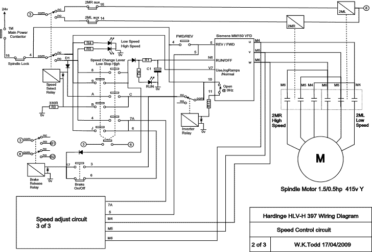

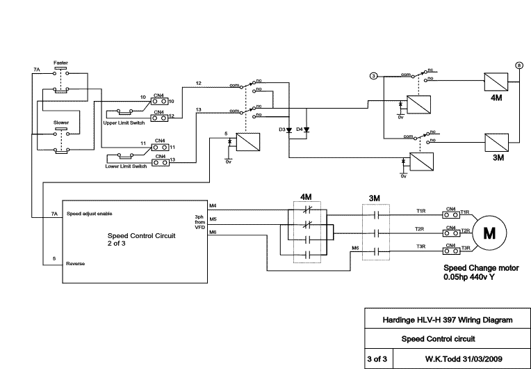

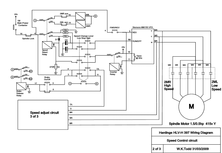

  3. Updated Circuit diagrams.

  4. Not much to photograph ATM, but...
    I fitted a 4 jaw chuck (so I can make a backplate for a 3jc) which exacerbated the braking time problem; Essentially, the braking time for all speeds is determined by the time it takes from the highest speed, with the extra flying mass of the chuck I had to extend the brake time - I don't mind a ~6 second stop from 3000rpm, but the same from 125rpm is silly.
    I emailed Siemens for advice on adding a braking resistor, to allow the VFD to brake harder, unfortunately my model VFD does not have the brake transistor fitted, so I can't do that. They were kind enough to suggest an alternative; an MM440 (@ £467), Keypad (£28), Brake resistor (£112 - expensive, even for a big resistor, I think) and a class A filter (£61). I thanked them for their help, but I won't be going down that road.
    This morning I found, buried in among the 'JOG' parameters, in the Siemens VFD is an option to use the jog up/down ramp times instead of the normal ones; switching between the two settings with one of the digital inputs. A quick re-wire and now I have ~2s stop times from low speed and ~6.5s from High speed with chuck :)

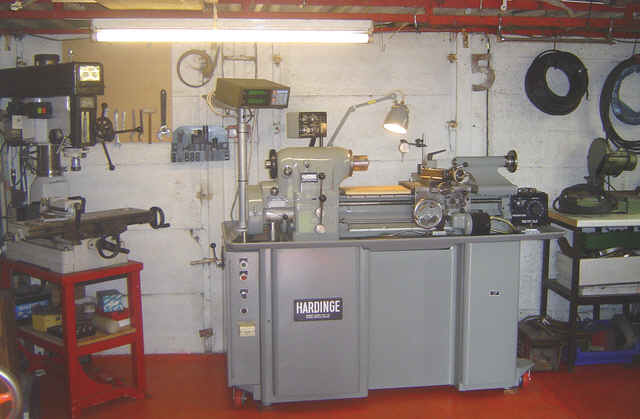

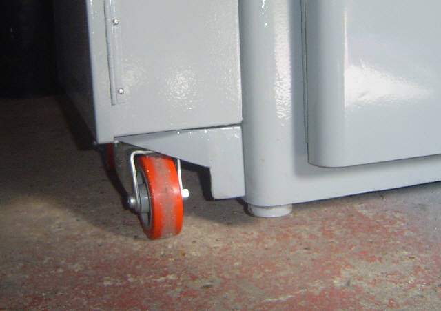

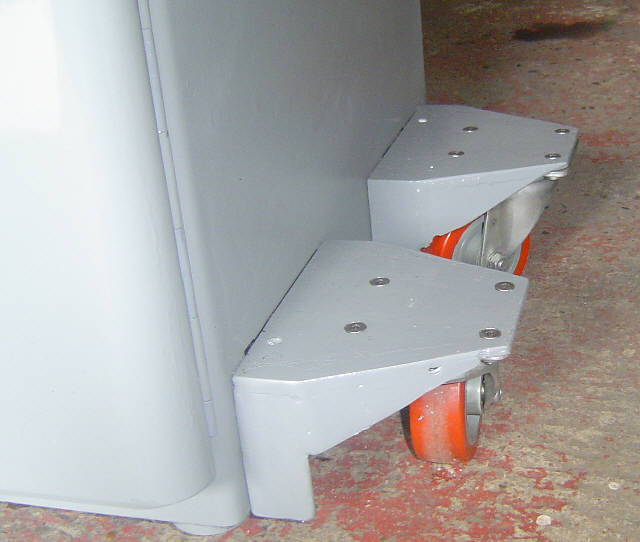

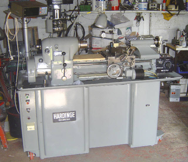

  8. I've pretty much finished the renovation now. I've just fitted the machine with castors so I can move it around the workshop until it fits somewhere.
    The castors are just about man enough for the job, they'll allow me to get behind the machine and access the electrical box easily. I'll have to chock the machine with wedges once in position.

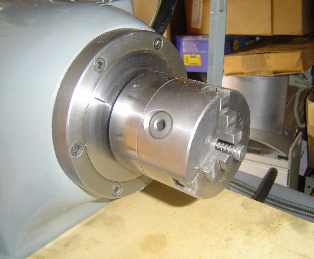

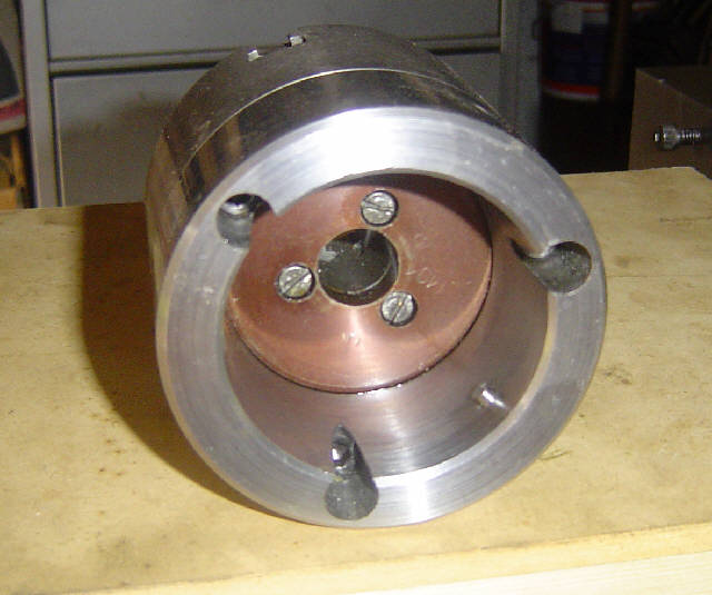

    My brother gave me a nice little 80mm german(?) made chuck, so the first real job I used the lathe on was a chuck mount for the taper nose - I'll have to make myself a better boring bar though, I couldn't stop the little one I have squeaking and chattering.
Name:	Castors fitted.jpg
ID:	379   Click image for larger version.
Name:	Castors fitted rear.jpg
ID:	380   Click image for larger version.
Name:	Castors fitted front.jpg
ID:	381   Click image for larger version.
Name:	80mm taper mount chuck.jpg
ID:	382   Click image for larger version.
Name:	80mm taper mount.jpg

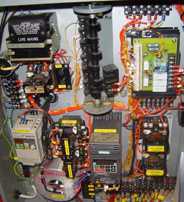

  9. Finally got 'round to replacing the bird's nested control circuit with a proper PCB
