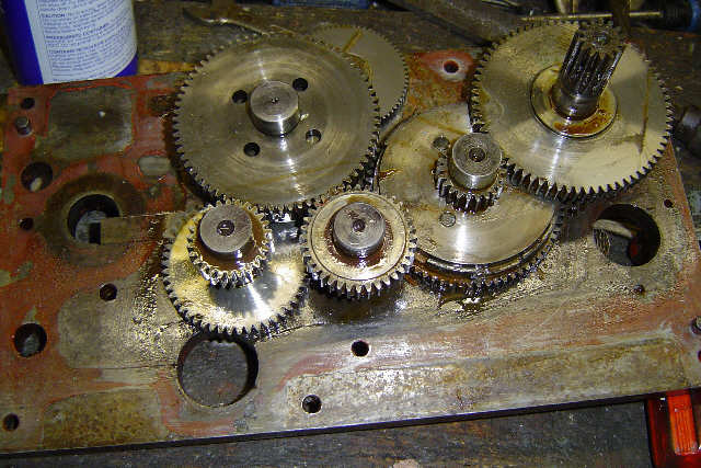

When I removed the power feed motor I thought i saw some water run out of the apron gearbox. I had to crack the box open to check...
Inside the apron gears and clutches (for cross and longitudinal feeds) are slimey but in good order. No obvious sign of water ingress.

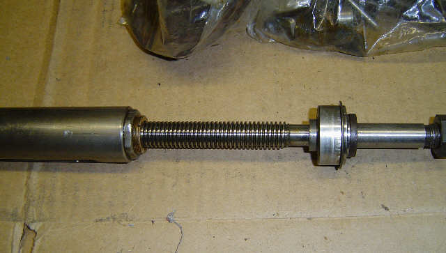

One strange thing: the tailstock is metric (the lathe is otherwise english) so it must hve ben swapped out at some time in the past. The picture shows the tailstock leadscrew ; notice the double row bearing and adjustable backlash compensation.

Got as far as removing the leadscrew half nuts and carriage today...
I dismantled the apron and found the first real sign of wear; The carriage drive gear inner bearing has been eating it's way into the gear shaft. I'm not should what I can do, other than replace the gear and bearings. I'll email ZMT later to see if they have a good S/H one.

Yup, but on my Bridgeport, not on the Hardinge. Got it from a gunsmith supplier - Brownell's here in the US. They had a number of different types, including both cold and hot solutions, in small bottles. The cold solution works well if you don't rub it incessantly. Like yours, mine had the quick threading lever on the compound broken off, so I made a new one from 1/4" stainless rod. That didn't need blueing, though. Your carriage drive gear looks like mine did. I toyed with the idea of having the shaft flame sprayed and then grinding it to size, but I finally just bit the bullet and bought a new one and a new Oilite bushing from Hardinge. I don't recall how much it was...around $80USD sounds familiar.
