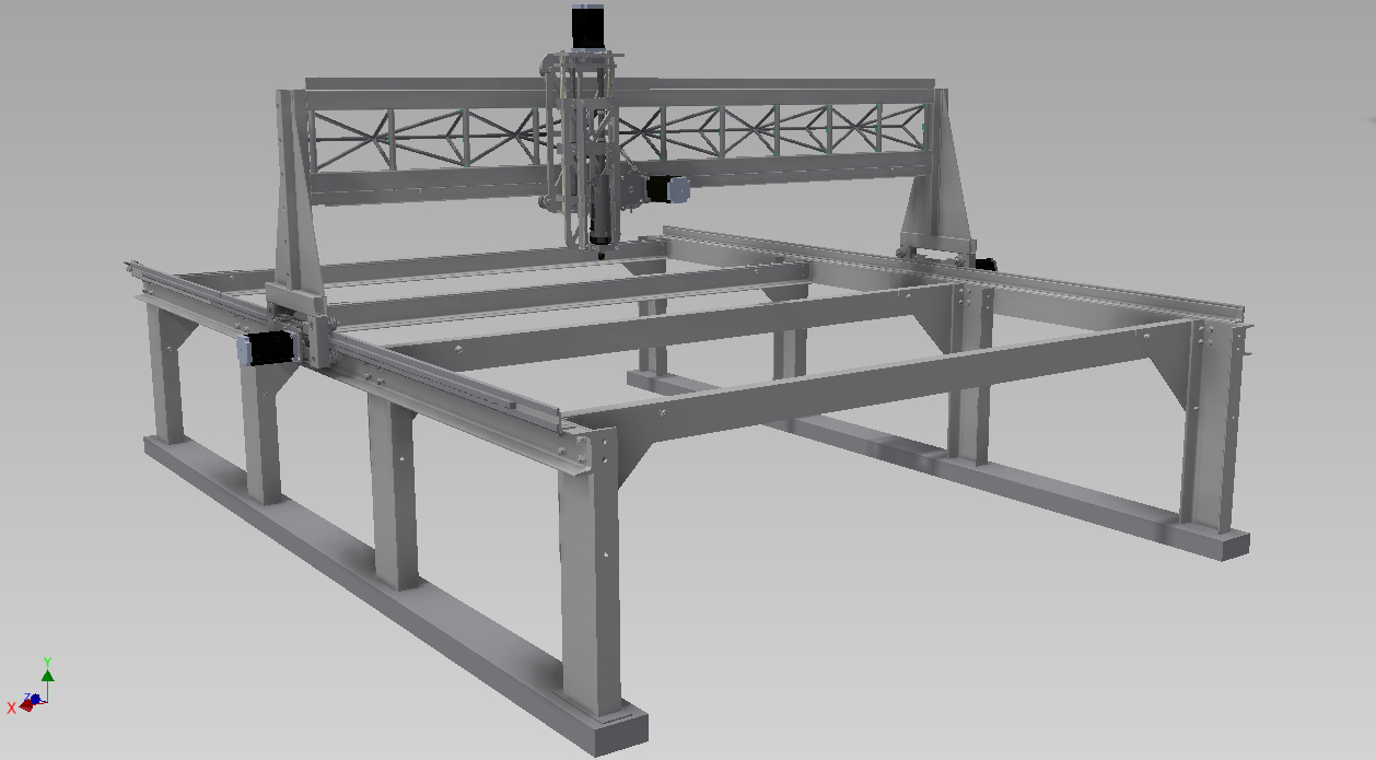

    Hello,
    I have started one year ago cnc project and would like to share it here :) Motors are Nema34 from China, Drivers also from the same place. Linear rails are V groove bearings, got the rails a little used but in good working condition. Also created 3:1 belt reduction with HTD 3M timing belts. Drive system is rack and pinion, module 1.5, accuracy i have at this moment is about 0.2mm.
    The first job with my cnc was dust Cyclone, works perfect.
    Attaching some pictures from Inventor:

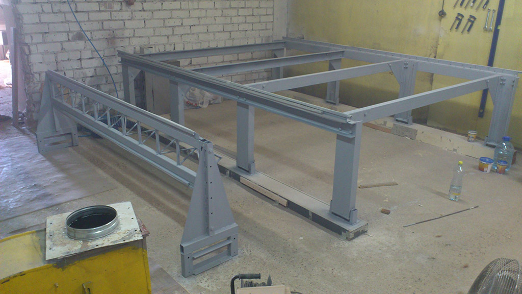

    And here is result after 10 month :)

    How is the truss gantry working out for you, any problems?

    I put the glass with water on the table when it was milling MDF and it was difficult to see any vibrations in water. Almost no vibrations at all. Just was complicated to make rails straight, next time if i'll make any new cnc, the table will be different :)

    Well I think your machine is ace. Really good of you to post pictures and there is clearly a lot of work that has gone into it. Its nice and big and you should be proud of it my friend.
