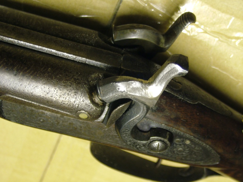

    I have a sick shotgun in need of some magic TIG glue. 12 gauge by Henry Tatham of London c1840 .
    It's the hammers. The left had it's spur brazed on and the brazing broke. The right is off a very similar gun and the geometry is a tadge out, it hits it's end stop just before it reaches the nipple.
    I bought new castings but they don't quite clear the fence and they don't have the width at the bottom.
    I have a TIG but I lack the skill. I fear I would burn the crap out of it and make things worse.
    I need a lump attaching which I can carve into a new spur, the old spur being lost in a Surrey wood.
    I need the square mounting hole closing on t'other so I can cut a new hole rotated by a few degrees.
    Panic not, the gun is completely legal and I only need send the hammers.

    Are they cast iron??
    They will be wrought iron, they predate Marshall's iron. Welds like a charm.
    Like you, I have a TIG set. I also have a MIG set and served my apprenticeship as a fabricator/jig maker 20 years ago. HOWEVER, given the nature of the job and the fact that I'm "OK" with TIG (certainly not an expert), I'm a bit reluctant to offer help in case I make a balls up of it...

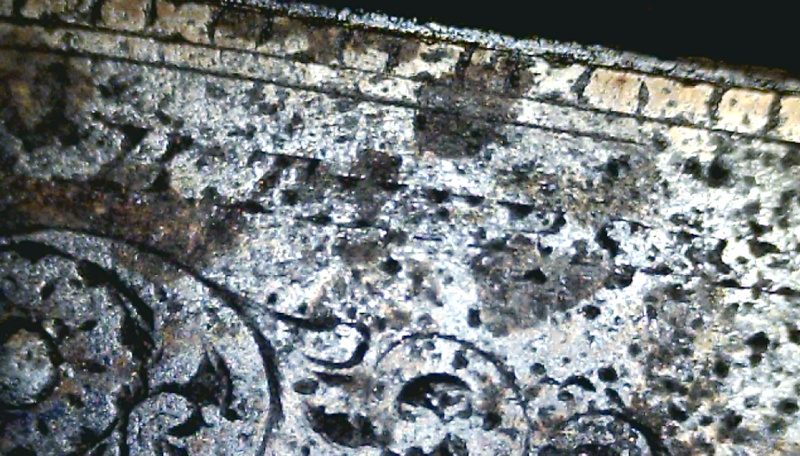

    I got the name wrong, but digi-microscope and a bit of contrast adjustment reveals all..
    I can see B TH?RS? which has to be Benjamin Thursfield of Hasluck's Buildings, Baggot Street, Birmingham 1859-69
    Don't be put off by thinking this is valuable, without a case and rust marked it's probably worth £400 to £500 top whack. With a broken hammer you could halve that.

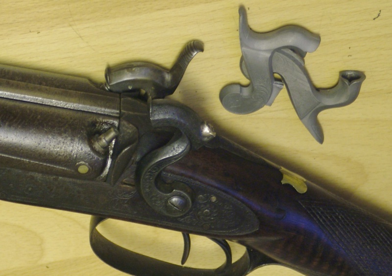

    Thanks for the offer but I'd already given up and got my son to TIG it. His welds are good but he's a bit generous with the rod so I have one hell of a filing job on my plate.
    This after about 2 hours worth

    Dunno why you didn't TIG it yourself in the first place. You've gotta practice sometime.
    Job looks good, despite him being generous with his rod.
    Glad your sorted ,i went in for my ticket about 15 years back and havent touched tig since or id have offered,looks a nice job
    Quote Originally Posted by birchy View Post
    Doing TIG would involve reading the manual, too many knobs, I simply adjust Amps and hope for the best.
