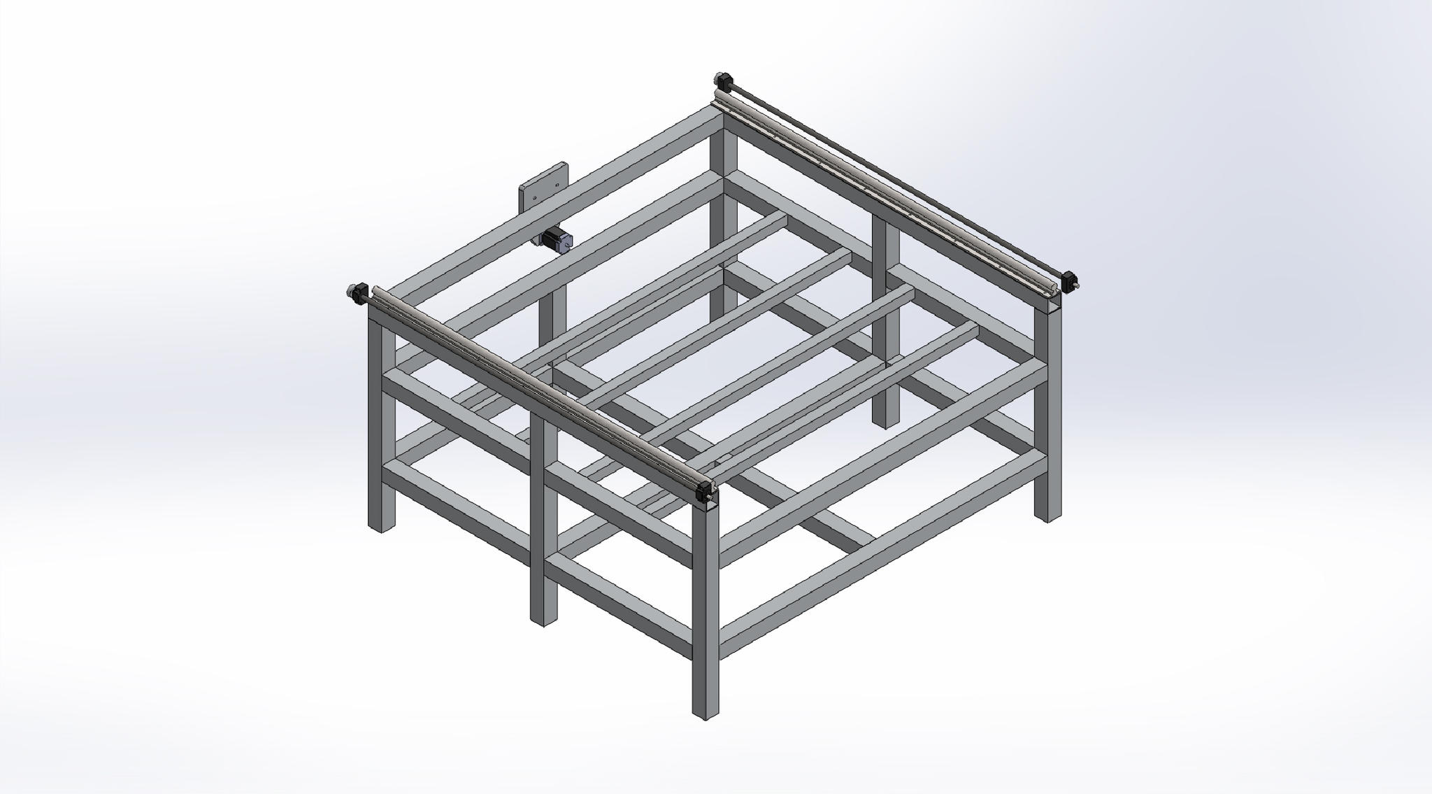

    Thats a good idea by over hanging the X rails. I guess you could also have a removable section in the centre of the bed to do the same thing, but will obviously limit the size of the material that is being cut. May take the idea up and incorporate it into my design. What length overhang would you say? diagonal supports could be added for a bit more strength too.

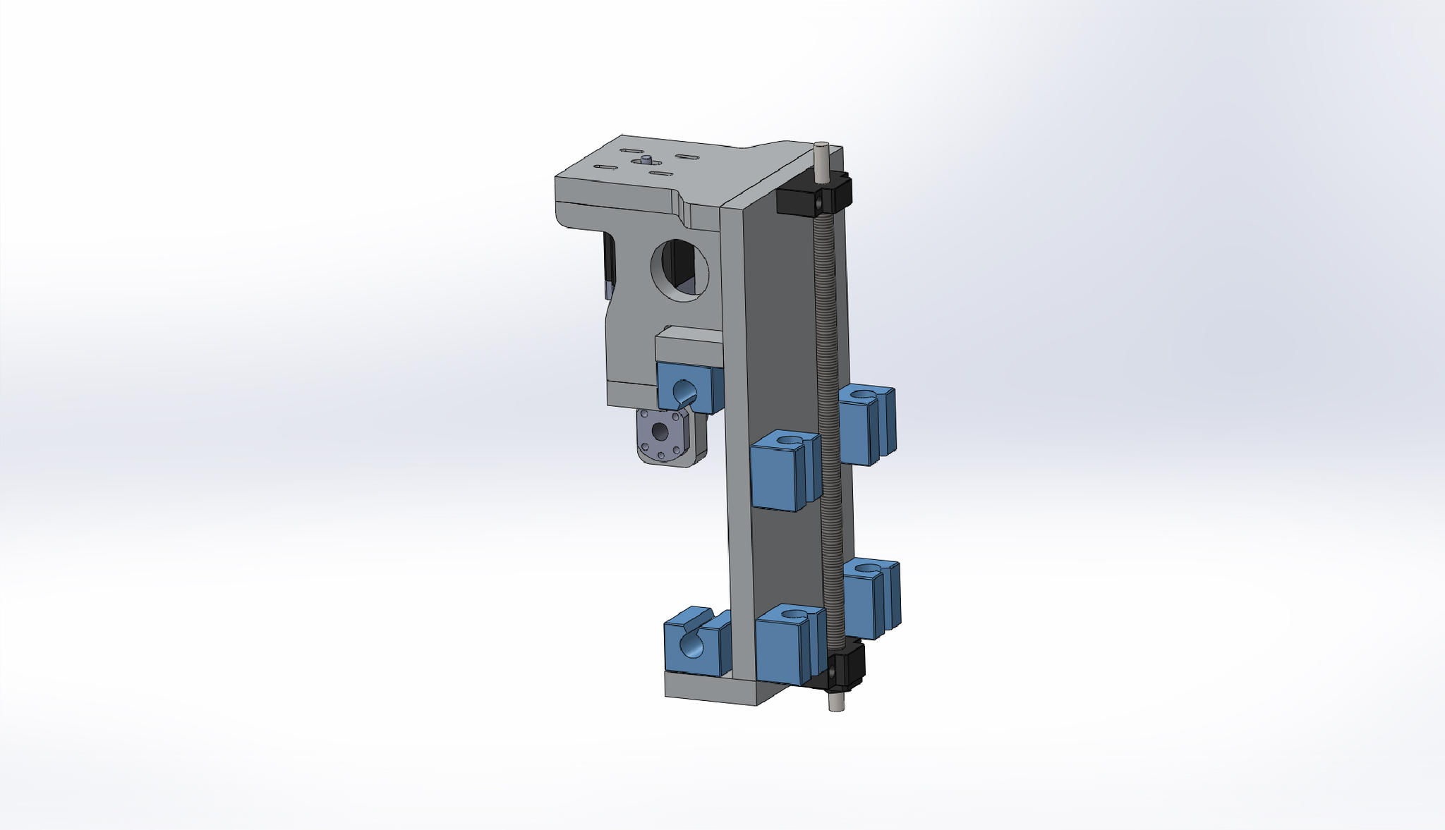

    Im debating over the Z axis travel now too. i originally stated 300mm, what is the norm? or will it be best to go with less around 200mm. I will be mainly profiling, but will occasionally mill in 3D (modelling foam), if pocketing im guessing the depth of Z travel will be restricted by the tool length?

    Make the Z-axis as small as you can afford to without compromising what you want to make. It is far easier to design a machine with a short Z-axis since the overhang is less, so the torque applied to the gantry, and hence in general the forces are lower.

    I've never needed or built over 200m in any Z axis. Like Jonathan says just enough for your needs and no more. The adjustable bed takes the need for long Z axis away in most cases and Jonathan has quite a long Z axis but I bet he rarely has need for it.? . . Other than being too lazy to lift the Bed.!
    Tooling length will be a limiting factor and while you can buy long tooling it often costs a fortune and requires large spindle collets. You'' be hard pressed to find longer than 200mm flute cutters with less than 12.5mm shank sizes that routers or common ER20 spindles take and even then you probably find the price prohibiting.!!

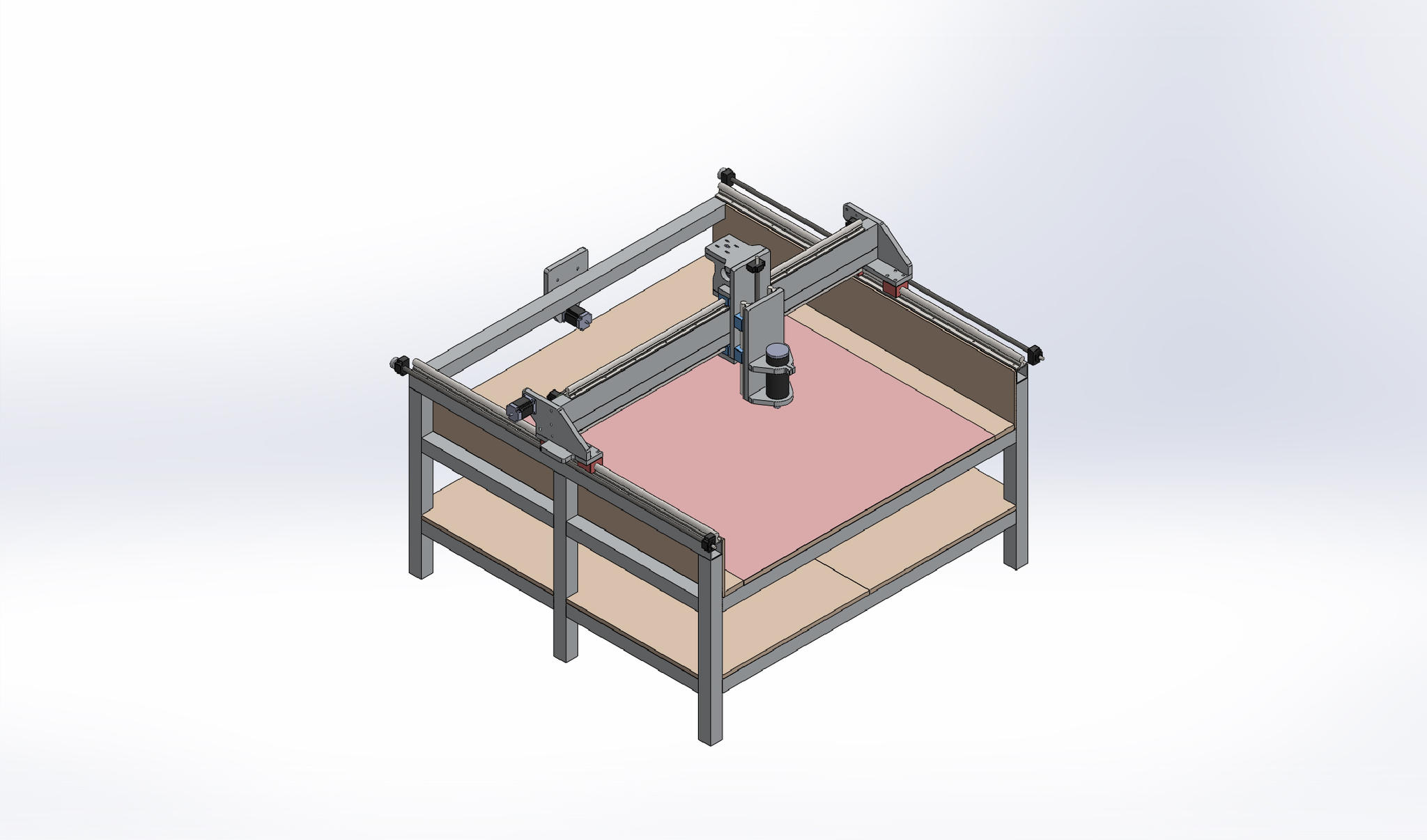

    I,m building a machine as Jazz knows, that is able to take a half sheet ie 1220mm x 1220mm. My x is going to be 1700mm, y is going to be in the region of 1670mm/1700mm, and z will be finalised nearer the time, but will have travel of 100mm. The sides of my table will 250mm high, and the removable table will be sitting 100mm down from the top of the sides. When i have my 200mm material on the machine, my z travel is going to be in the region of 50mm (nothing is finalised at the moment apart from the table design). When i have thinner material on the machine, and the removable table is fitted, again, the travel will be 100mm. I,m hopeful that this will be in keeping with the strength of the machine, which i,m sure it will be. i,m looking at using 350mm of the over hang for the 4th axis. The way i,m doing as advised, is to keep it out the way of normal table operation, and this design is going to do just that. Just need to get the bloody workshop built, hopefully this weekend, now that the snow is away AGAIN.

    Been a bit busy with work and jobs around the house so have not got much more done yet. I have been looking at the costs of materials and may be a bit pricey to use aluminium t slot extrusion on the machine.

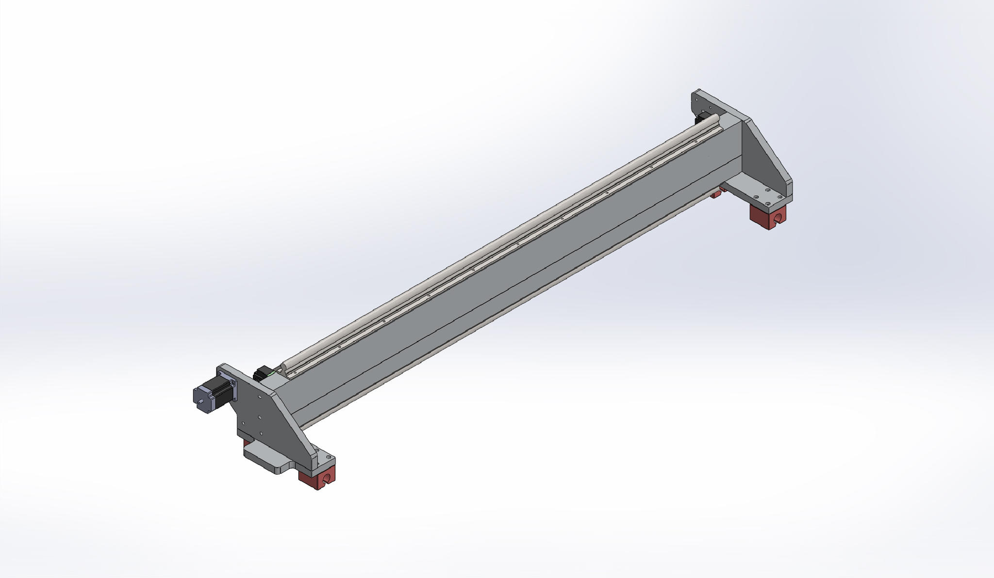

    i am looking at aluminium box section 60x60x4 for the frame and 120x60x4 (2x L shape config) for the gantry. Is there much difference in strength / deflection using box compared to the t slot ext and how does it deal with resonance? What materials are generally used to dampen if it is needed?

    Hi, here are a few more screen shots of the model. Done a lot of work on it, but still a few more hours to go... Please let me know your thoughts as i would much rather make the changes now than down the line. I have still got to add diagonals / gussets onto the frame to strengthen it up. What are peoples thoughts on the X pulley set up (i have left the cross bar unsupported so material can be slid through), ways to mount X ball screws and set up of motor / pulleys on Y axis?Click image for larger version.
