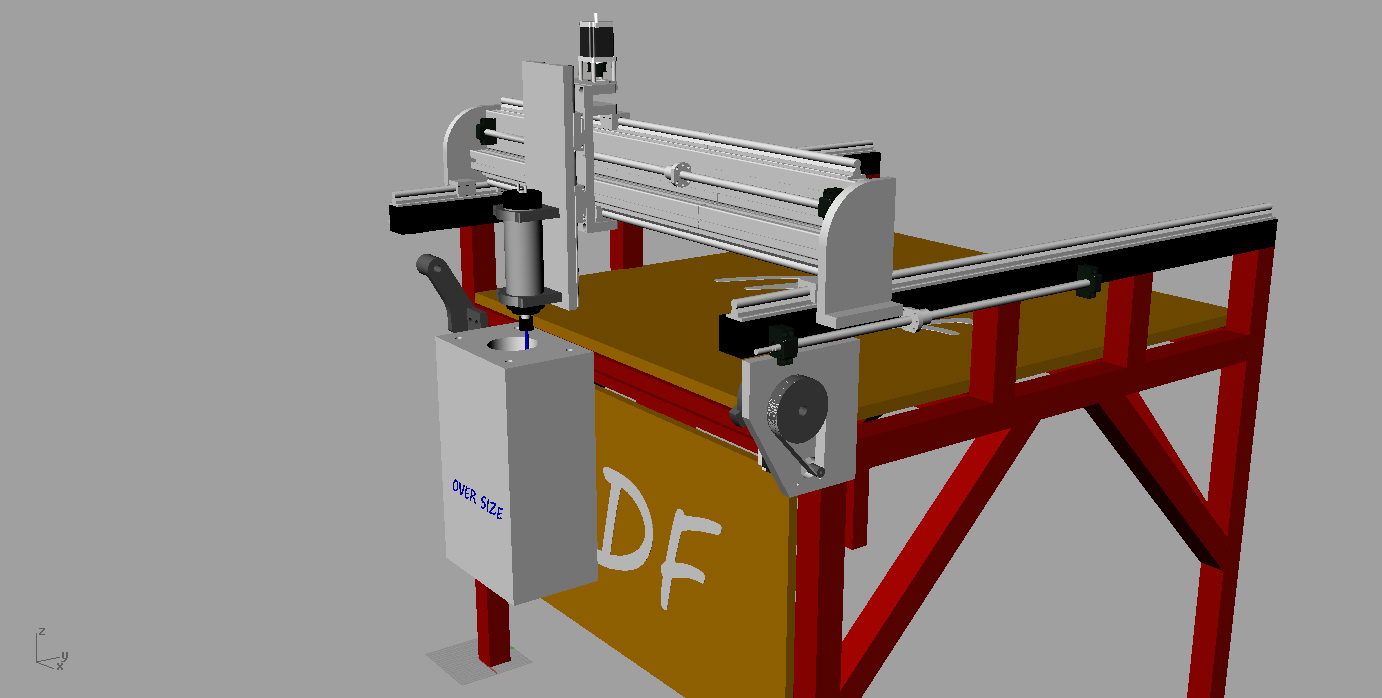

    Im looking at building a 1250mm x 1250mm x 300mm (cutting capacity) cnc router / miller from scratch. Will be cutting the usual MDF, ply and occasionally aluminium.
    ive read through millions of posts on the forum (very useful!) but I still have a few questions before I get started on the CAD model.
    as the x axis will be fairly long I am undecided whether to have 2 ball screws or one and this leads on to the next question 1 stepper motor or two. I think the two ball screws will be beneficial but if I use two steppers is it easy to get them in sync (via a slave) or would it be better to power the ball screws via 1 motor all linked by belt drive or should I just go for the 1 balls crew in the centre and power off 1 motor?
    next question is the controller. As times are moving on is it best to go with USB connection or parallel, again pros and cons for both with the parallel port being tried and tested and most popular or to go with USB as it will probably go down that route in the future and I will be able to connect my laptop to it.
    i don't mind going parallel and mach3 but would be good to connect via laptop.
    also generally what size aluminium extrusion do people typically use, would 80 x 40 be too lightweight for the size of the router?
    Is there much difference in accuracy and life span between flat supported rails and round supported rails and are the ones sold on eBay from honk kong etc ok or is it best to go with UK suppliers?
    finally, may need a few parts machined and more advice so any help would be appreciated.
    Will get some images up of the concept model one these few queries have been answered so feel free to give your input.

    Greetings Dan.
    Il answer what I can, however Im no pro...
    *You want 2 ballscrews driving the X on a gantry that wide, to stop it crabbing
    *in regards to one stepper or two, this is a bit of a sore subject on this forum. Both methods have their advantages comes down to personal choice. Im going for one stepper driving two screws.
    *(controlelr/breakout board) This is talked about in lots of different threads by people far cleverer than I. So I wont comment.
    *extrusion...get a design drawn up, its the design stage that will answer that question. Its all very well me saying yeah 80x40 but it depends on your design. Mine uses two peaces of 100x50 box 5mm thick in a L setup
    *The HiWin type cartridge rails are the ones to get.. They are expensive but from what I read are about as good as it gets.
    The supported round rails from china are what I went with, which I understand are good enough (so long as you pick the supported ones) but nowhere near as good as the HiWins
    I would read ALL the build threads... If you had done this prior to the above post you would of been able to answer all those questions yourself, from the wealth of information you gather from reading them. Then get some designs uploaded and be prepared for them to be picked apart!!!
    :-D wish you all the best with your build. make sure you keep this thread updated as there are some sad individuals (me) who regularly check for updates to build threads!!!

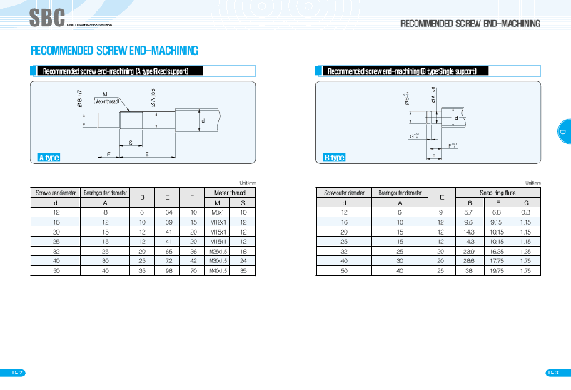

    Ok, il try and answer what I can...
    First off, I think you are referring to Chai. http://http://stores.ebay.co.uk/linearmotionbearings
    Next, have a look at this...
    When wording your email to chai, you need to specify your ballscrew dimensions carefully.
    For example. I wanted 1500mm of actual travel, I wanted BK type bearings at BOTH ends. and then I wanted to put a pulley on. So I actually ordered
    **1603mm Total length so 1500mm PLUS one end machined to type A (except dimension F to be 25mm instead of 15 (to accept pulley), and the other end machined again to type A, but without any F
    I personally used HTD bearings from bearing station. However the guy at cnc4u is an extremely nice and helpful chap. In hindsight I should of ordered everything from him! that way I could of just kept ringing him with my questions rather than all the reading ive had to do.
    remember; its all in design. dont rush into buying your linear gear until you've got it weighed up properly.... dont design around bearing sizes!. I wish I had spent longer designing as there is an amount of waste on my machine due to my inpatience in the design stages... Look at wilfy's build thread... that boy can design!
    hope this helps look forward to seeing design.

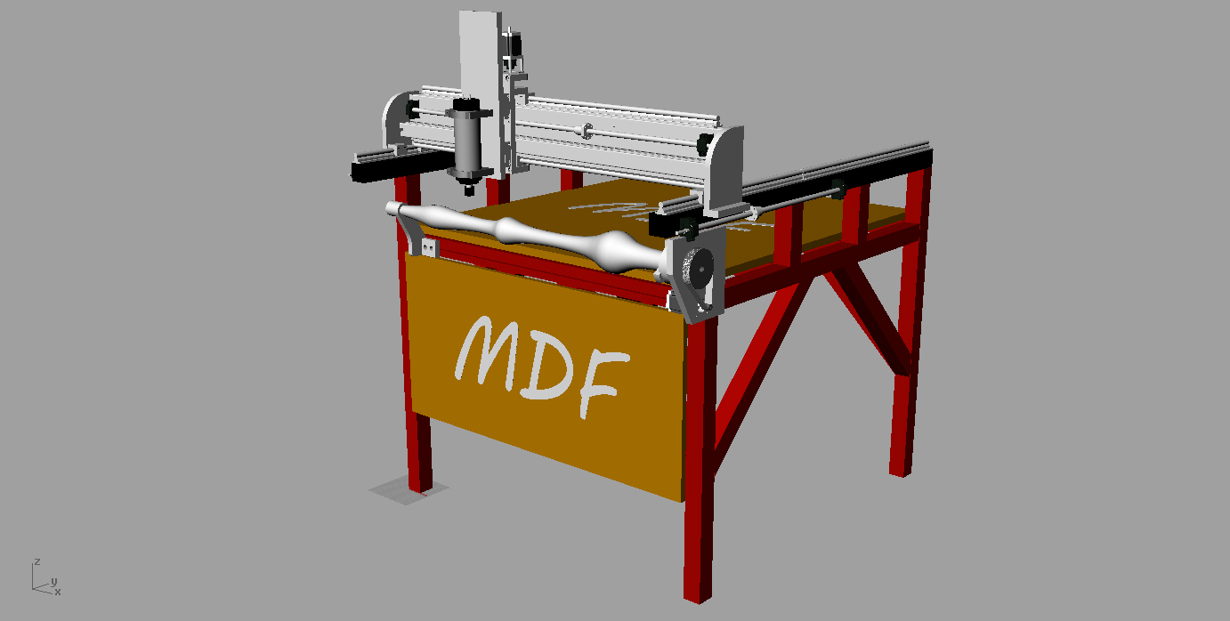

    Ive uploaded a screenshot so everyone can get an idea of the design when its being discussed. Its a long way off being finished tho. Please let me know your thoughts.
    Also i have started to research controllers and wiring etc and am a little daunted by it all, does anyone know of any good links that talks through it step by step and any recommendations for controller (makes and model) - think i will go with a parallel controller and Mach 3 rather than USB / bespoke software. Is it best to go with separate drivers rather than built into the controller?

    Regards the frame then it needs some diagonal bracing and if it's an adjustable bed which it looks then it needs much more support for the sides. Don't rely on the bed to for rigidity or strength, which it will do anyway, because when you come to adjust the bed the frame will move and flex knocking alignment and setup out every time.
    This will be a real pain, also the frame will be flimsy and resonant which will affect cut quality.
    Don't be skimpy on the frame Chunky is good, same with gantry don't be afraid of bit of weight it helps with cut quality and you'll be surprised how powerful the combination of ballscrews and steppers can be.!!
    Hope this helps.

    Just wanted to give some more info on the use of the machine and the design so far.
    Im hoping to cut mainly large ply / MDF sheets on it so wanted it to accommodate the maximum capacity sheet (standard size: 8ft x 4ft).
    i didnt want to build a router to this overall sheet size as i it will be a bit of a beast and also the cost comes into play. my thoughts were to make it accept the width of the sheet (4ft / 1220mm + a little) and then the length of the board could be machined in two halves by either feeding the material through of turning it through 180 degrees.
    Does the length of the gantry pose a problem for general machining and would it be able to handle cutting aluminium? As long as the strength is there will it be ok and will the precision still be to a fairly high standard. If cutting aluminium or harder woods is
    Will be looking at getting the water cooled spindle so im guessing the weight of the gantry and Z axis will be a fair bit so the gantry will have to be fairly substantial.
    The bed is going to be in a fixed position so this can be bulked up with diagonals for strength and like suggested heavier gauge extrusion, just difficult to balance the desired design with the cost of parts.
    The support in the Y direction behind the gantry was to mount the motor in the centre with pulleys to the X ballscrews, so didnt really want to add a support the other end as this was to allow material to be fed in / out but if i can position it in a way that the material can be slid under the support i may add this in.

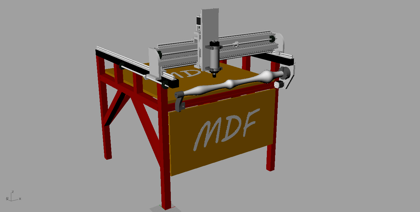

    Quote Originally Posted by Danielroyal25 View Post
    Yes Gantry length will greatly affect the machine but not so much for precision but more the quality of finish from machine. Precison or accurecy is down to combination of components and quality of build.
    That doesn't mean you can't have long gantry but it does mean it will have to be very strong and substantial to resist resonance and flex which are the enemy of finish quality.
    Take this strength to another level if you want to cut Aluminium and achieve good Finish quality. Really unless your only cutting Thin Alu sheet or Profiles etc that don't need good finish then forget cutting Aluminium on such a wide or long moving gantry machine. Yes it will do it but not very well.!!

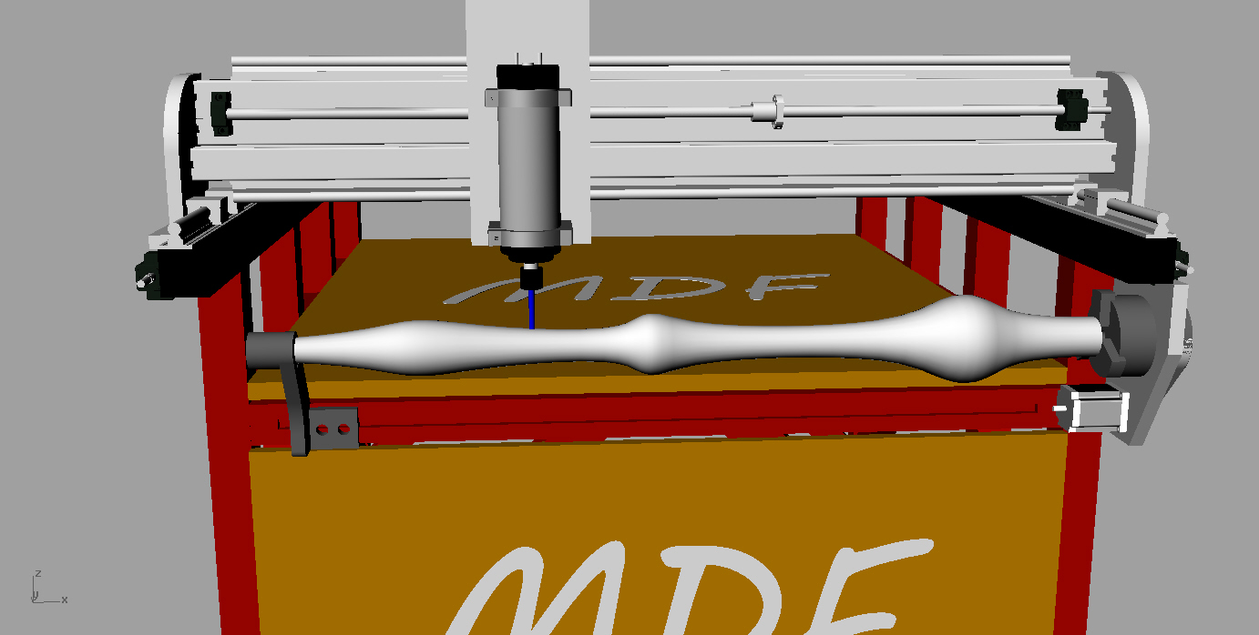

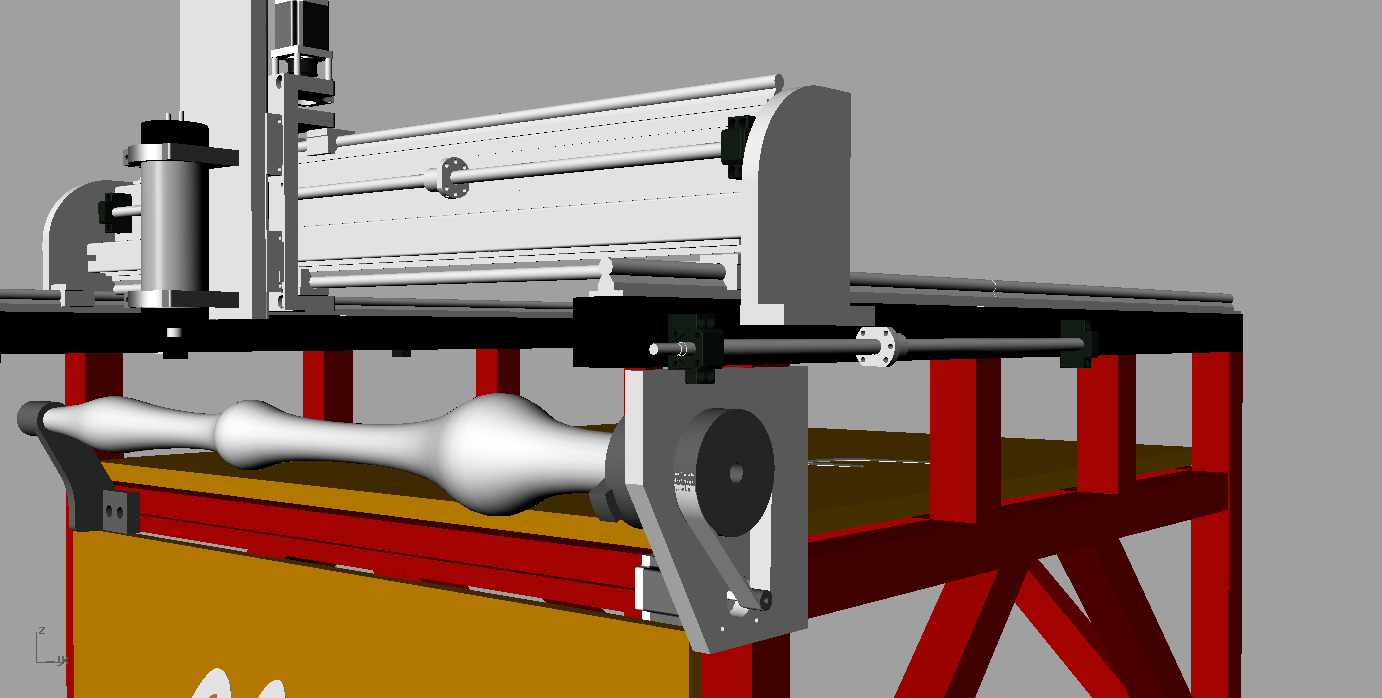

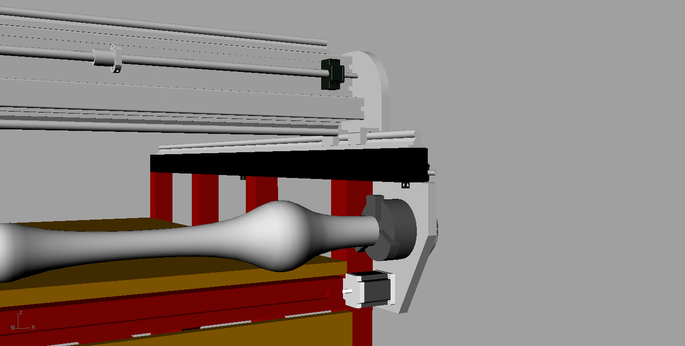

    No need One end support will be fine so long the frame is braced well, my machine has this one end setup and it works fine.

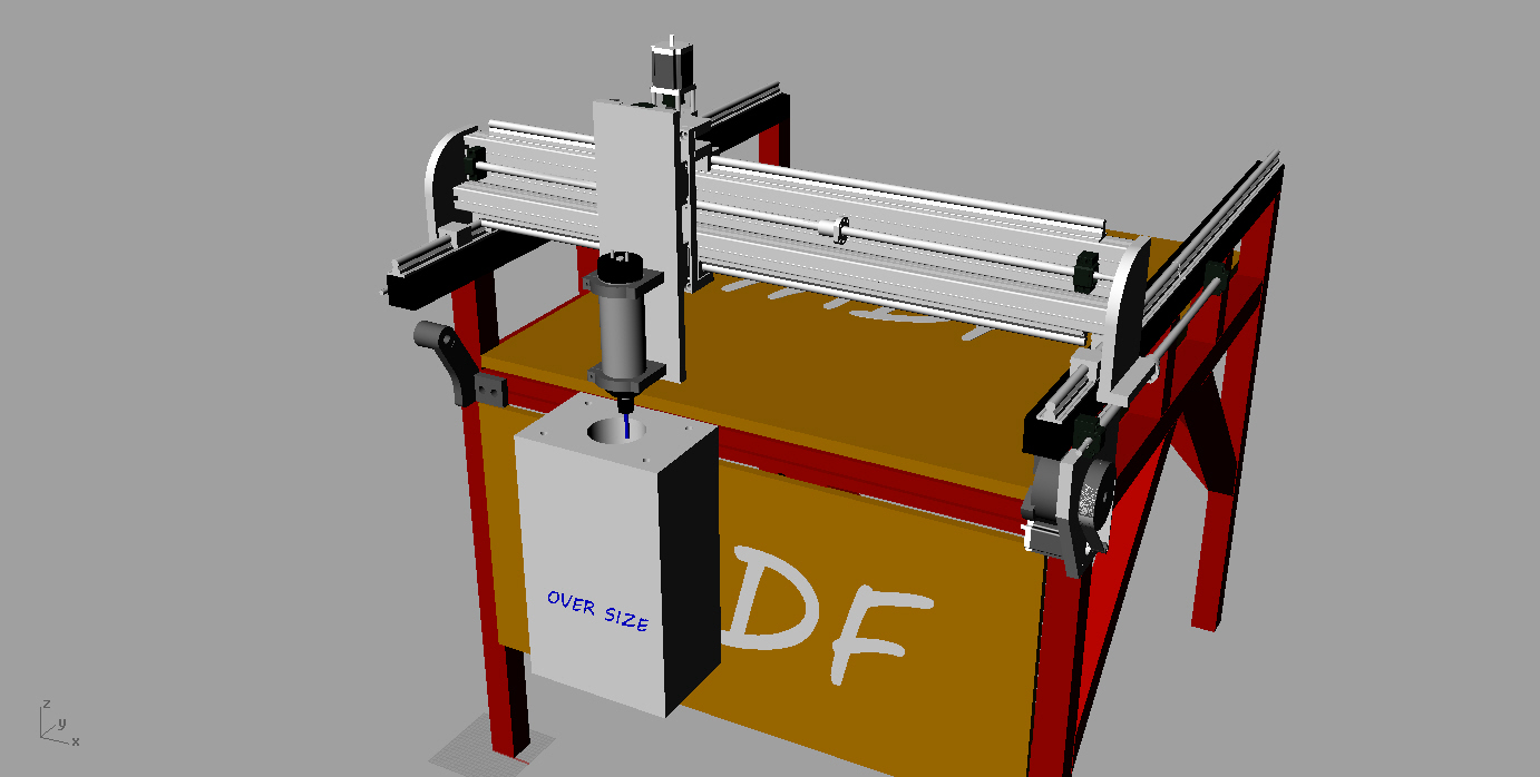

    If your into wood can I suggest you have the rails slightly overhang the end of bed. Doing this simple thing will give you some nice options easily achieved.
    Namely will allow end machining of boards etc for hinges, locks, Dovetails and oversize or oversize awkward parts by clamping to end of machine.
    Also if you want a 4th axis makes it very easy to add one see pics for some idea of what I mean.
    It's only a cad mock up so pay no attention to details like gantry has thats actually a design I use the other way round it just saved me some drawing time for showing the person it was intended for. It could be used that way round thou.!!
