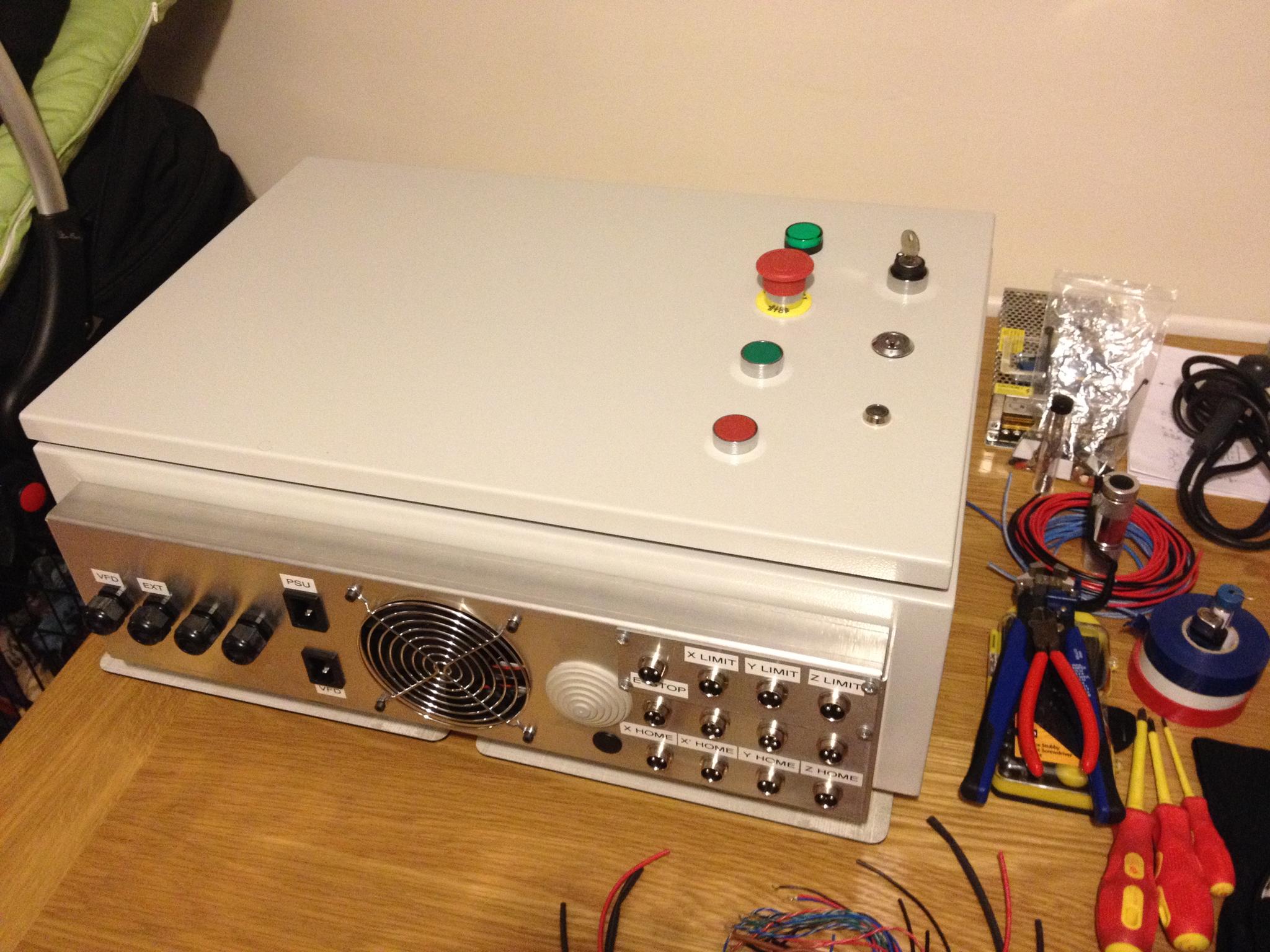

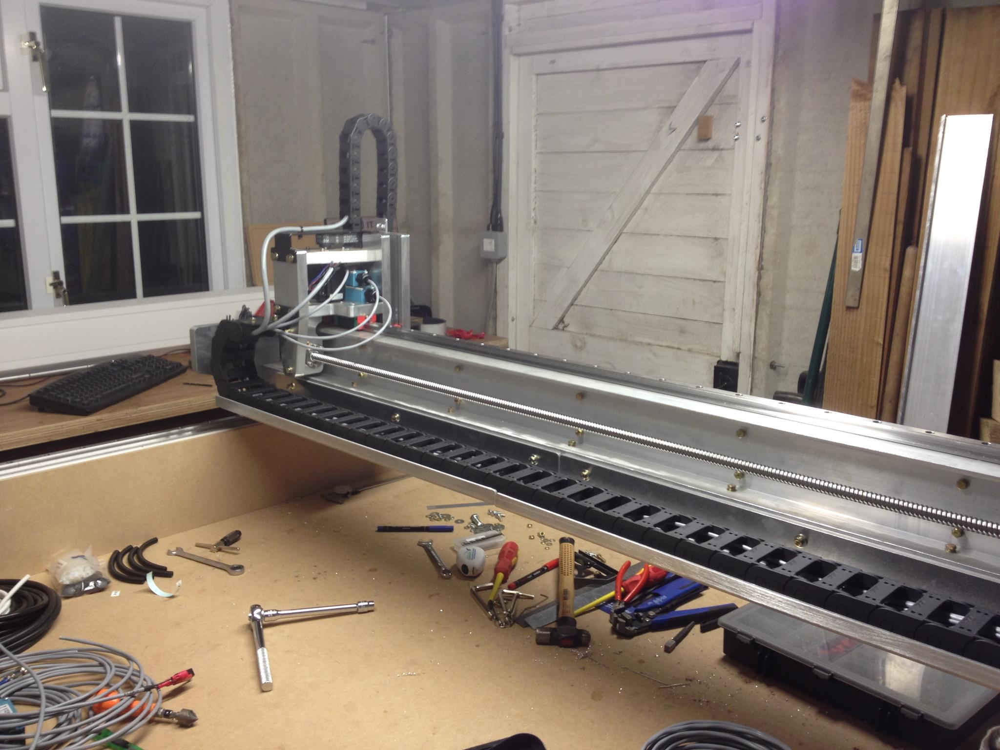

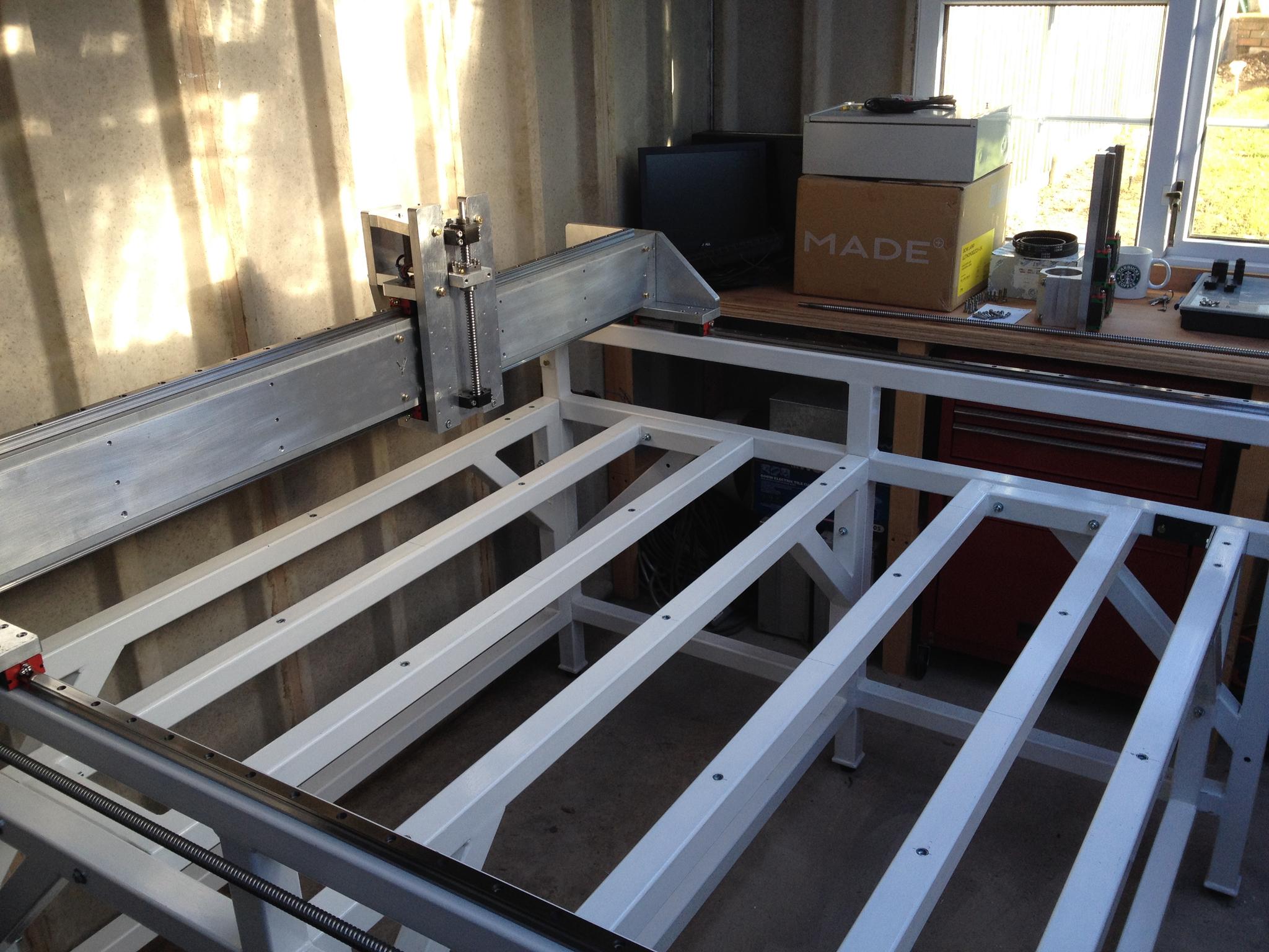

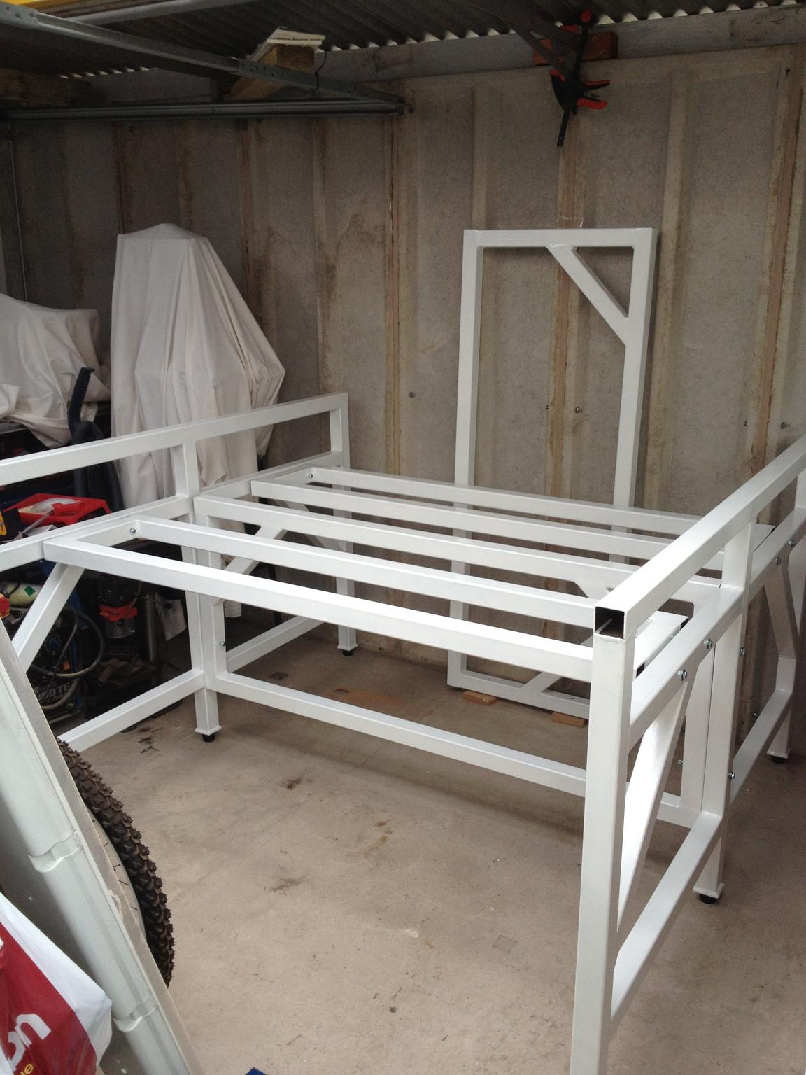

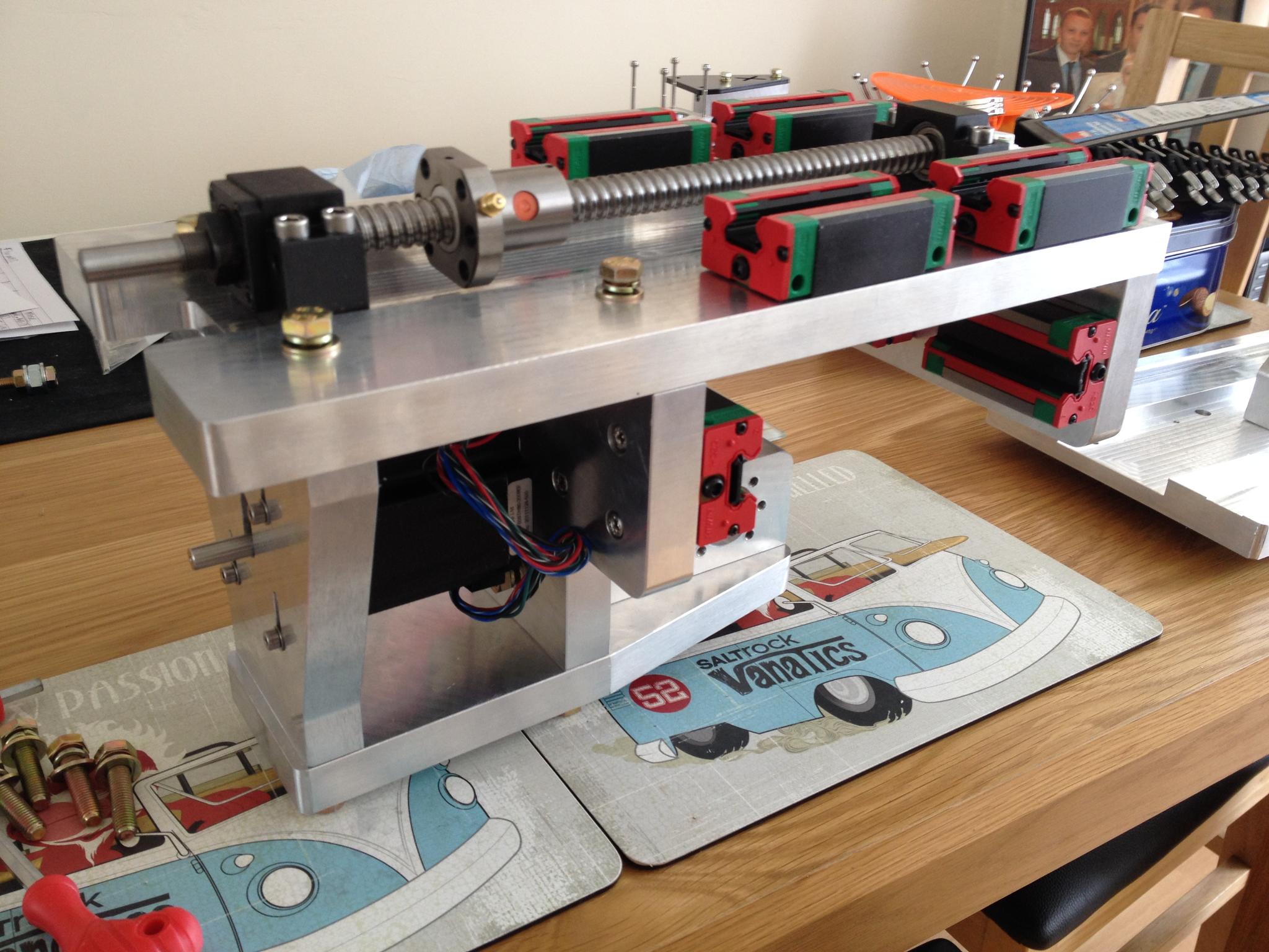

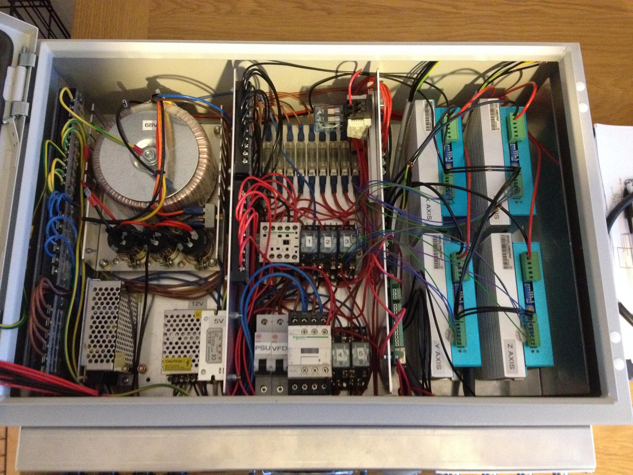

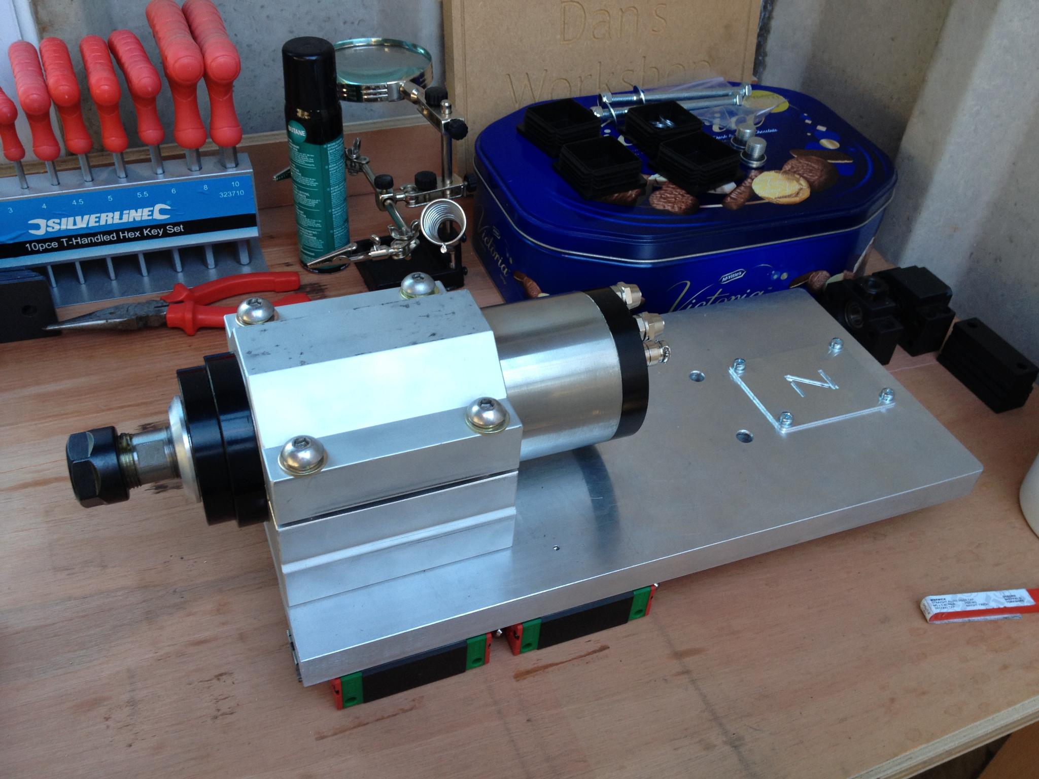

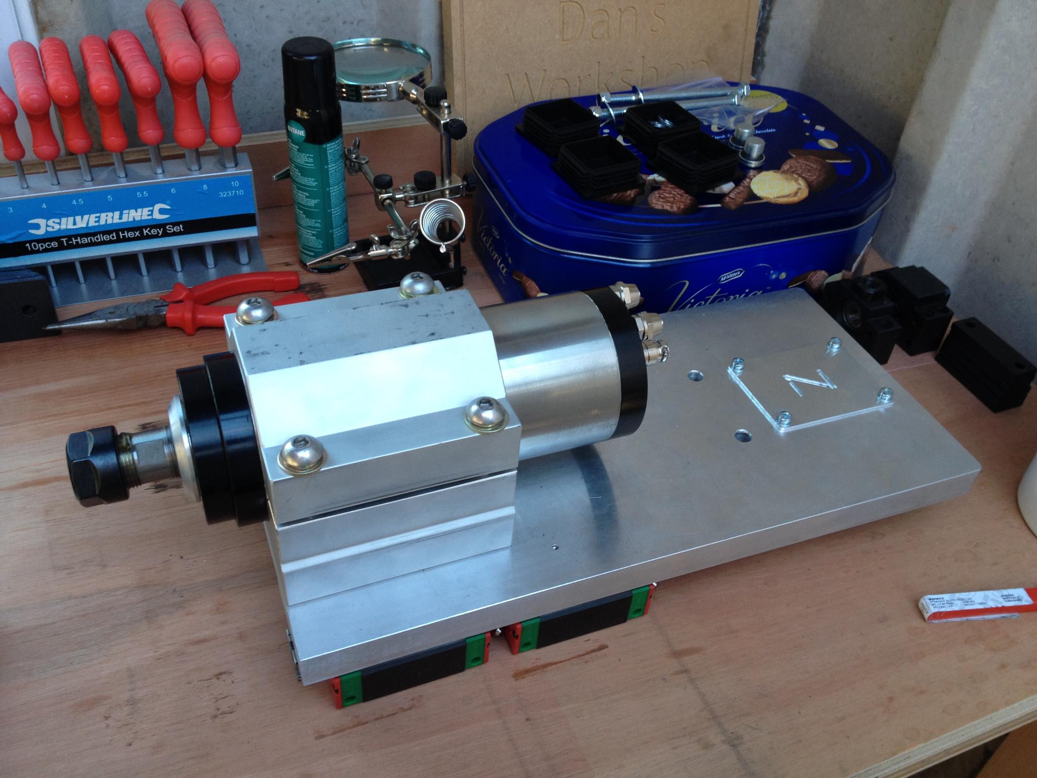

    Here are a few images from the build. I wont go into too much detail with text, but if anyone has any questions just let me know and i will give more detail.
    I am really pleased with how it has turned out, considering it is the first machine i have designed and built. Huge thanks to everyone for the help!!!
    Things i would do differently next time:
    Not use cheap Omron relays! i had around 3 faulty ones which caused a head ache fault finding.
    Get the dust extractor set up before surfacing the bed!!!
    oversize the control box, as the wiring become a little messy and cramped
    make the bed heigh adjustable
    add rail adjustment to aid levelling
    use epoxy to level the rails
    Things still to do:
    fit limit and home switches on all axis
    finish the dust extraction system including dust shoe
    loctite the pulley and grub screws onto the motors
    calibrate the spindle speed
    Putting the hours into the design was worth it. The assembly went well with the machined parts, the frame went together well to with only a couple of holes needing opening out. Slotting parts and adding adjustment in the design was beneficial for setting up and assembly.
    It has taken near enough a year from design to working machine (working weekends and the occasional week night).
    Anyway, enjoy the pics...
    Looks good Dan, how big or small is the is the control box you've used ? like you say it does look a bit cramped in there.
    Mike
  13. #48
    Thanks mike, it was 400 x 600 x 200. It weighs a ton!! I had to add an aluminium section on the bottom for cable entry etc which is around 40mm deep. This just about fitted all of the connectors an glands in. Would have a much larger box and add conduit / cable management in next time.
    still new to mount it on the side of the machine and add vents on the top before it's completely finished.
    Dan
  14. #49
    Still looks very impressive to me Dan, looks as if I will have to keep my eye out for an 800 x 600 x 200 enclosure if it needs all that wiring and I will at some stage want to get 5 drivers in a case for my build. I noticed that on your Z axis which I have to looks fantastic very nice finish, that you've had both the parts machined to give clearance for the ball screw. Could you not have just packed out the plates where the rails and blocks are fitted and use a thinner plate ?
    Mike
